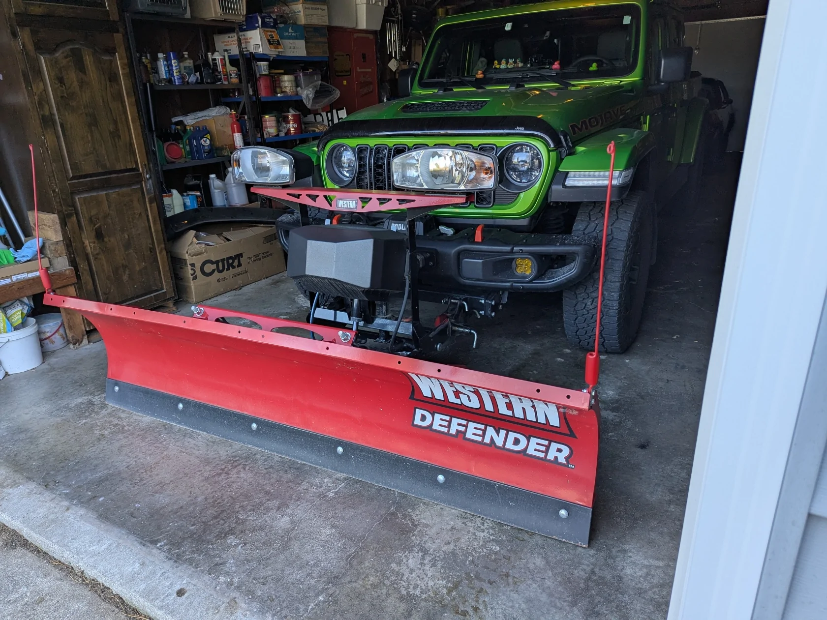

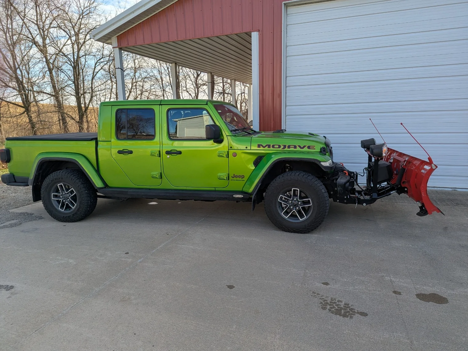

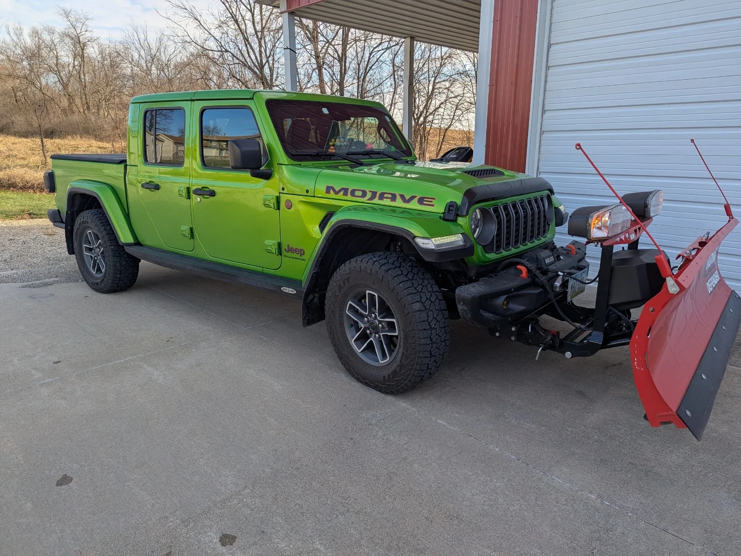

Ready for winter now, I still need to jack it up to take some of the load off and measure for those spring spacers. this does drop the front a lot when it's on. Those spacers come in so many sizes, not sure what I need.
The front camera sure makes it easy driving up to the plow - done it twice now and both times, it was perfectly lined up and I simple drove until it was in the brackets, got out and plugged the cables in, went back and put it in float mode, then went out and pushed up and back on the top of the light area and it snapped the pins right into place. Couldn't have been easier.
Temps dropped like a rock so my tire pressure dropped as well from about 35/36 down to 29.
So it was also time to put some winter air in the tires. (and if you don't, you can't turn the wheels when it's on rough concrete)
