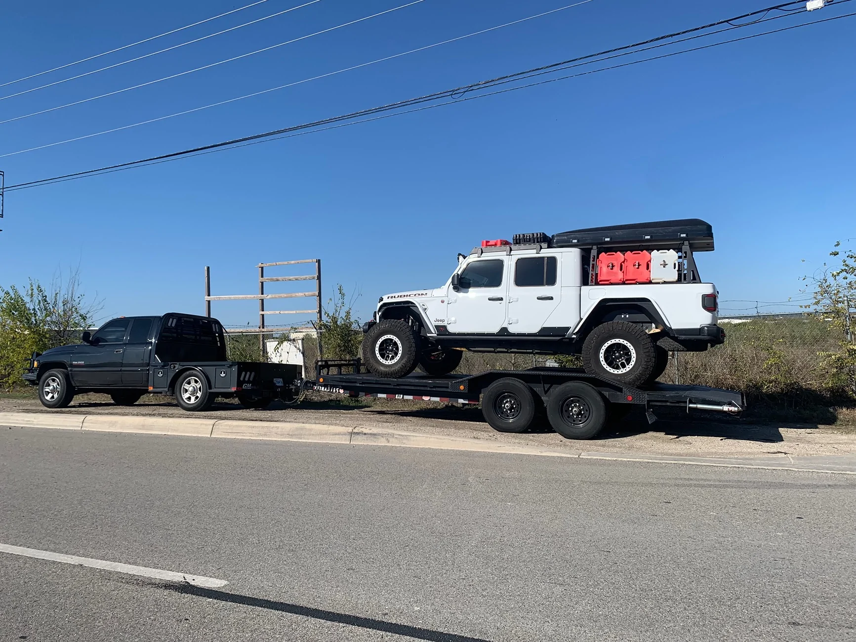

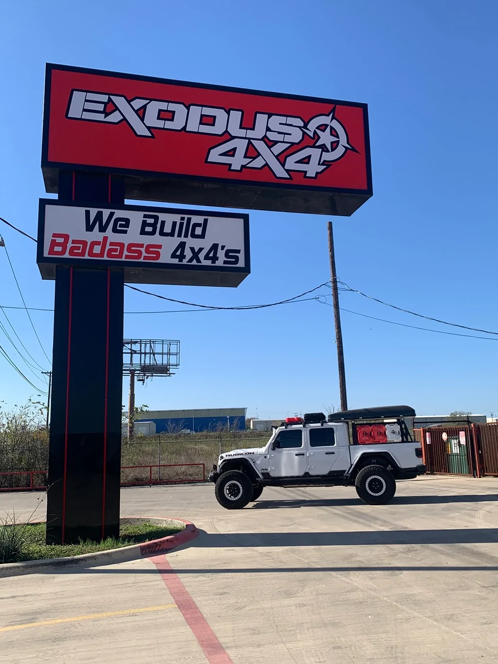

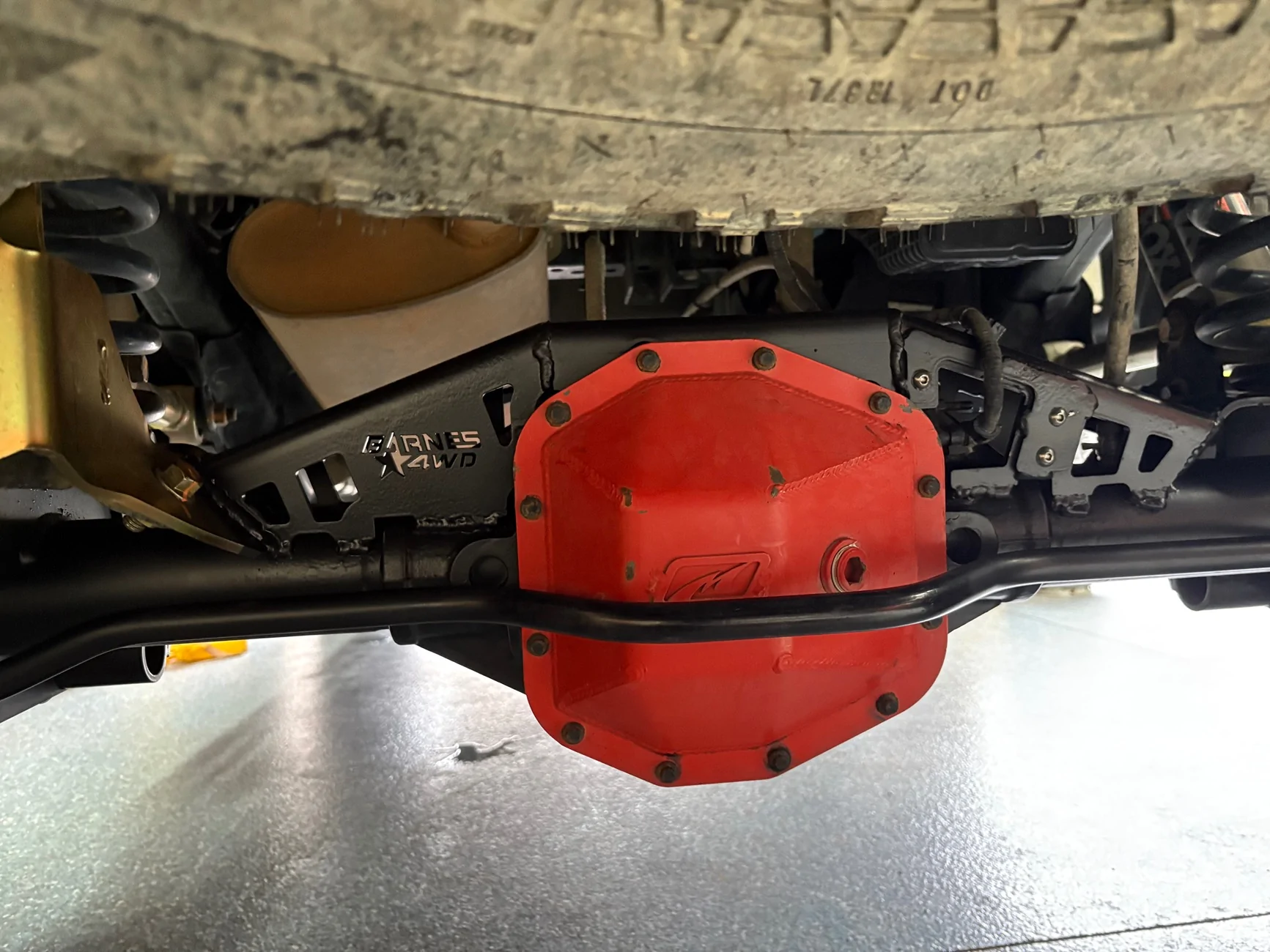

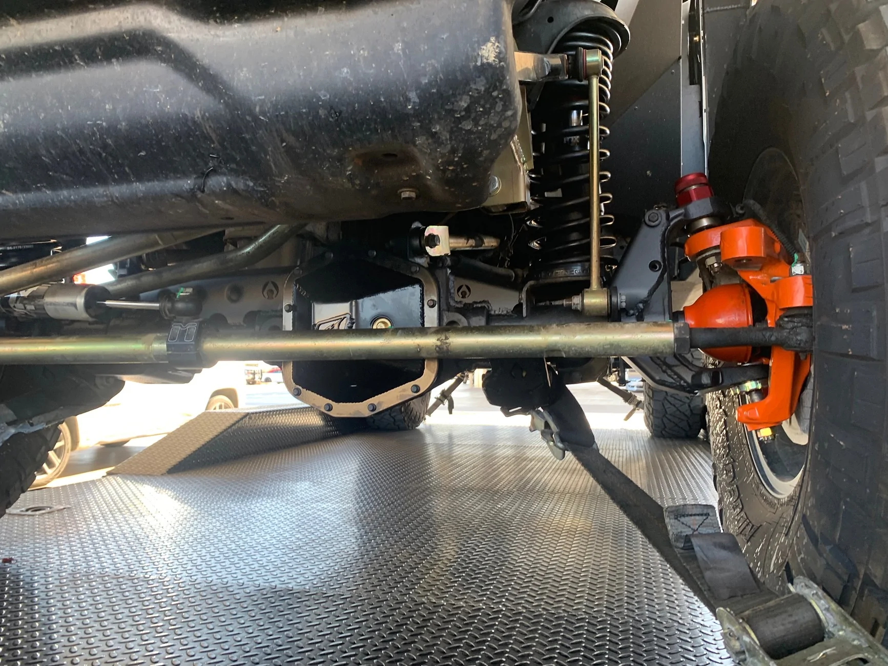

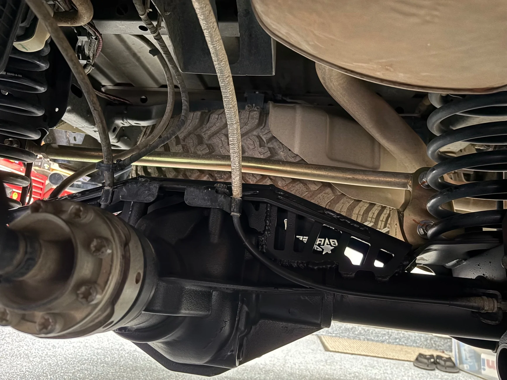

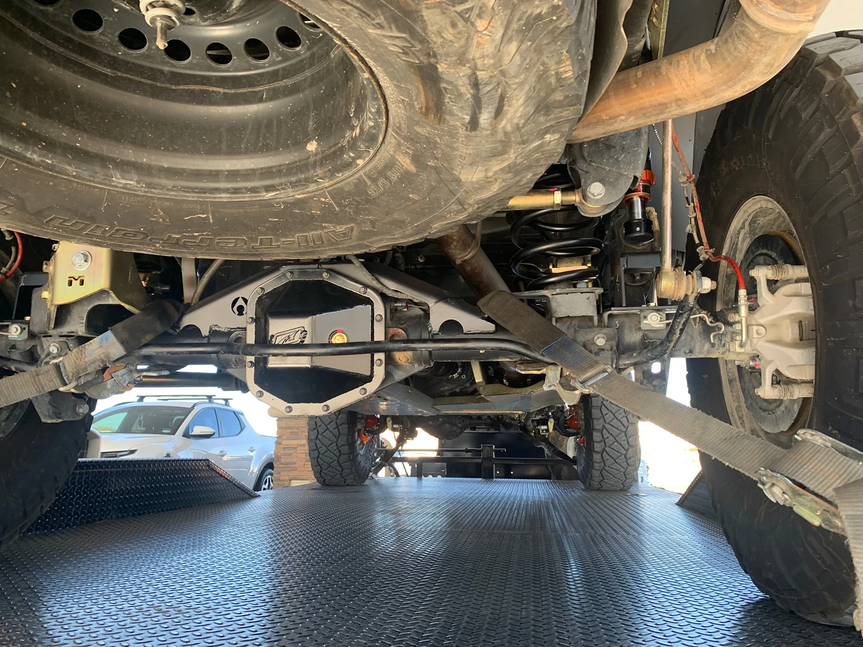

After looking at the pile of parts I acquired over a year ago I took my Jt to a shop to have the work done. I hate paying someone else to do work I can do but sometimes life gets in the way and camping season is right around the corner. Very happy with the outcome and the shop.
4.56 gears, Dana rear shafts, RCV fronts, Artec trusses, MC ball joints, Reid Knuckles, MC 4.5 springs, Fox bumps.

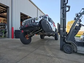

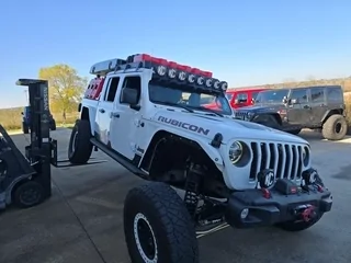

Bump stop adjustments.

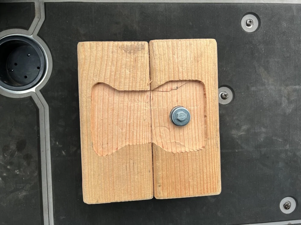

I also like the compactness and tidy storage of the factory unit. I like scissor jacks in general. After looking at various other scissor jacks, here's what I decided to do:
Since I'm running 37's, the factory jack is too short; so I made a base to elevate the jack. This is two 4x4 blocks about 8" long that are bolted together (which you can't see in this pic). I routed out a "shallow" profile of the jack base so that it will nest on the blocks and added a bolt just to ensure it won't slip; there is a notch on the one end of the jack that slides onto the bolt:
