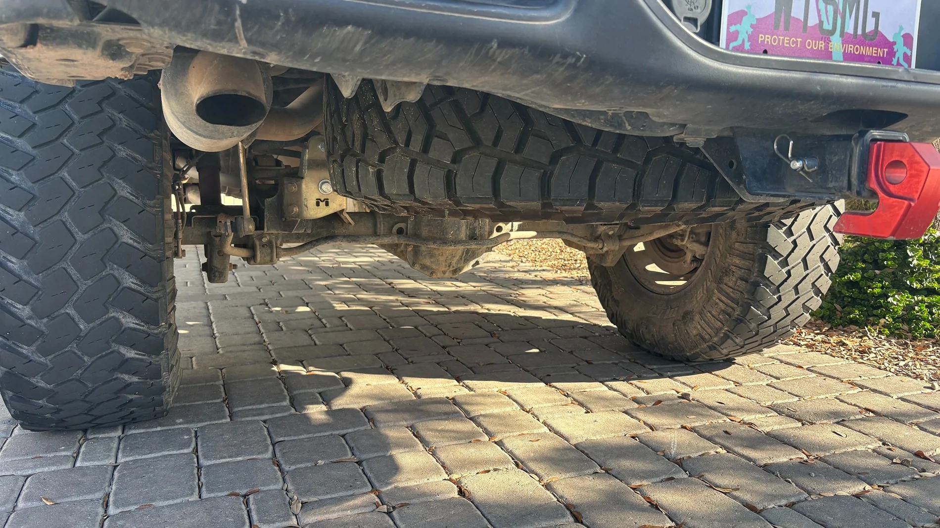

I have 37x12.5 Mickey Thompson Baja Boss and the spare fits under the bed, but I did have to bend out the lower edge of the heat shield in places because it was catching on the tread blocks as I was trying to crank the spare up.Mostly the ease of doing a 5 tire rotation when the tire is not mounted under the bed and not bashing the spare offroading.
