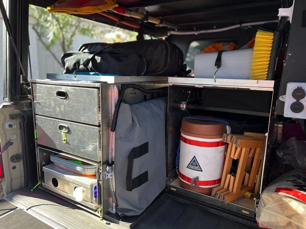

Not unlike @Larry D and the nut in the rain gutter or @Sempe-Fi Rubicon and the loose hitch skid, I did not get one of my kitchen drawers latched and there was about a half inch of travel for it to bang against the tailgate every time I accelerated:
Jeep Gladiator What Did You THINK Was Wrong w/ Your Gladiator, But Wasn’t? 45_KitchenStowed
