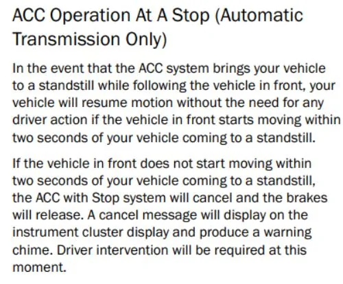

Grand Cherokee has electronic parking brakes. Most high-end SUV's have it. The parking brake will be a 'button' on the dash (not a pull handle like the gladdy has).
So, when you're using the AC in the Gladdy..... make sure you put your foot on the brake after it comes to a complete stop.
Always do. Our other two cars have electric e brakes. As did several before these.
40,514
54,044
That one hasn’t gotten me, but our first adaptive cruise was on another mopar, grand Cherokee. I’m guessing it was the same. My wife’s comes to a complete stop and will resume when cars move. This one disables itself.
Only after 2 seconds.
The BRAKES hold it - if the vehicle ahead starts moving within 2 seconds, it resumes speed.
If it does not, it cancels ACC and releases the brakes.
It's just how this is made. It could hold the position for 30 seconds since it's using the ABS system to hold position.
I've experienced both ways in mine - the vehicle ahead makes a short stop and turns, I go again, other times it cancels as the guy ahead doesn't go quickly enough.

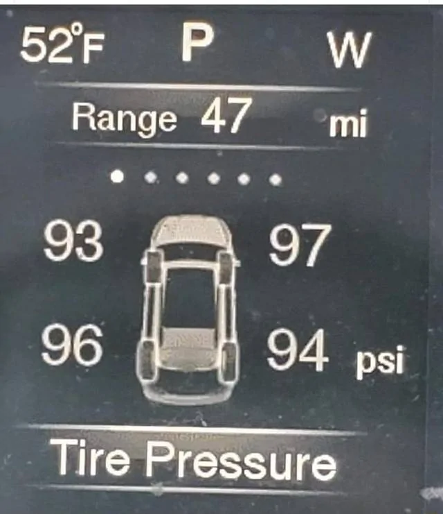

I tried VERY HARD to get my tire pressures up to 100%.
This one’s my favorite so far. I don’t even care if it’s true.
