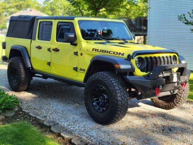

Love the looks of your Rubicon, yeah I don't need to tow my 5th wheel, it is great and valuable information to know that I can't do that, that isn't a deal breaker. Thank you all for the valuable information!
If all you want is 2 inch lift and 35s, I would recommend Rubicon. I have Willys that I ran 35 Milestar tires and 2 inch AEV puck lift for 3 years on 3.73 stock gears in Colorado. I was averaging about 20-23 mpg on highway. I drive like a grandpa and don't go anywhere fast. Now with Rubicon you will have 4.10 gears which will help a lot with 35 inch tires and if you at sea level you will be fine. Just remember, these things are not rocket ships, if they were meant to go fast they would not be shaped like a brick.
