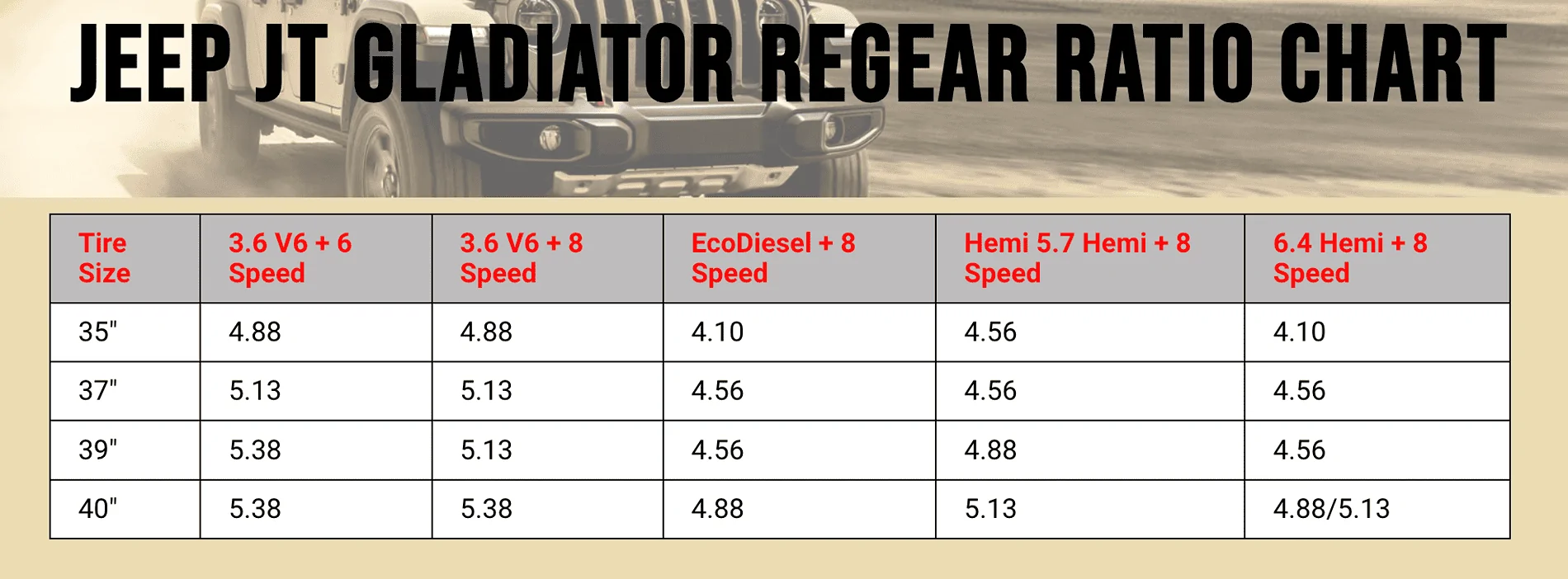

With the sport, will I need to get my gears re geared if I lift it 2”? Where if I get a different model I won’t? Is re gearing expensive?
Lift isn't what drives the need to regear ... for this discussion tire size is ... as tire size increases, the force to the ground is decreased (among other things) so one way to compensate is to increase the gearing ratio of the differential. The max Tow comes with 4.10 gearing (same as rubicon and mojave ... both of which come with 33" tires stock). Most don't worry about 35" and 4.10 gears ... the crowd is roughly split in half when discussing 37" (this likely has to do with how much torque each person "needs" - whether preference, vehicle load, towing, etc.)

according to this chart, I would have to regear regardless of which model I buy.
Most people who have diesels here haven't regeared for 37" tires. No need. Torque monster. Regear? What's that? I don't need no stinkin regear I have a diesel!
