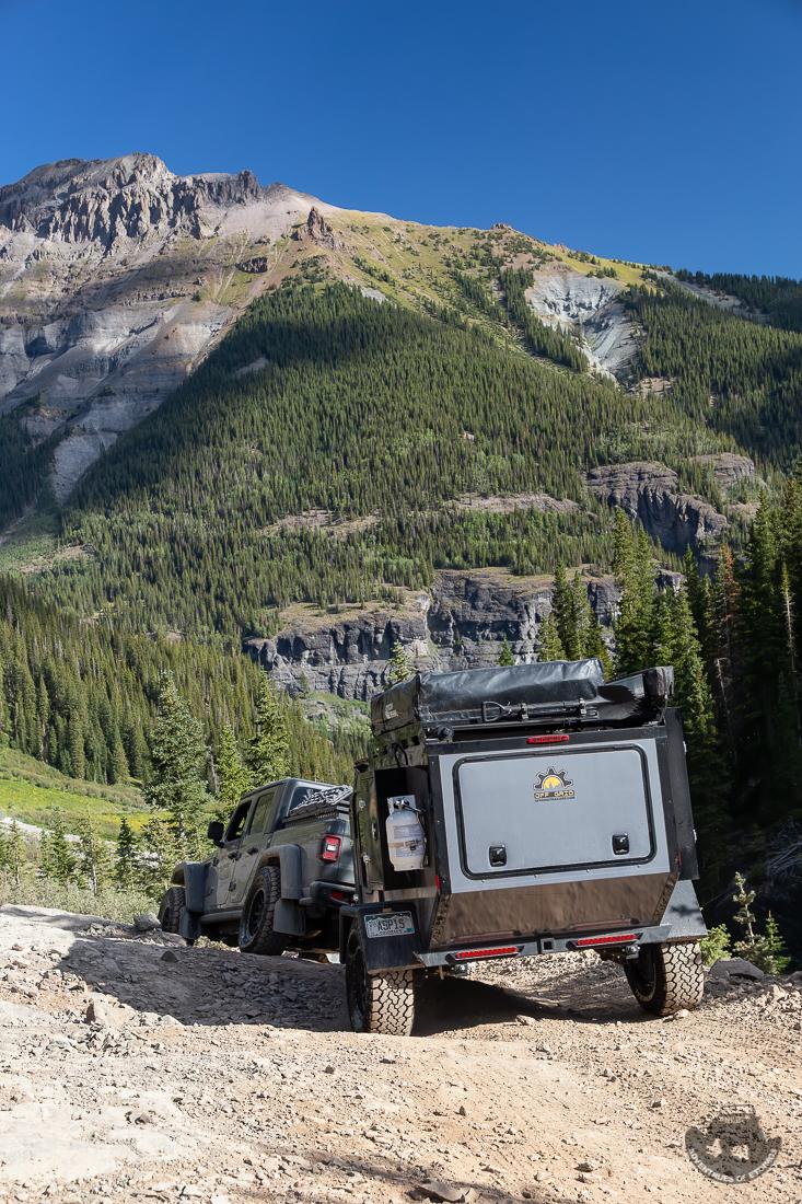

I'll also add that the lower gear ratio of the Rubicon can be a bonus for overlanding, not just for bashing rocks. I dragged my overlanding trailer to 11,000 feet on Imogene Pass here in CO with my JTR. I could not have done that in a Sport or Mojave with their taller gearing. The JT just does not have the power at that altitude for this type of climb without the super low gearing to help out. Even in 4Lo the Rubicon was barley making the climb. I did turn around at that point and made camp at a nice spot less than a hundred feet below where it got too tuff for the truck.
Rubicon gives me tools that when I need them, I need them.
I was very interested in the Mojave and might have bought one had they been on the lots when it was time for me to purchase. I'm sure I'll debate the Mojave vs Diesel vs Hemi in 5 years if I decide I want something different then the Rubicon.
I really wish Jeep would have used the Overland name for a version that was designed for actual overlanding though.

how much does your trailer weigh and whats your final drive ratio?
if you didnt re-gear, why? You struggle for power on the trail but not on mountain road passes? having a hard time understanding that....
if i get to a point that somehow my low range isnt low enough, a rubi t case is a straight swap, but i cant imagine that being something that ill ever need for overlanding.
Dry weight is 1700lbs and Max GVW is 3500lbs. I figure I was close to the max for that trip. I've got 4.10s and the eight speed auto, whatever the final drive ratio is on that... I don't know it off the top of my head.
I have not re-geared because for 98% of my driving I don't need it. The eight speed does really well on road, offroad and towing... just not at 11,000+ feet. I can't tell you if it will struggle on pavement at over 11k cause I've not taken it there... and can't imagine I'd ever tow on pavement at that altitude. There are only a handful of paved road in the US that high and most just go to a lookout and back down the same way you come in. In addition to that, on paved roads you are not trying to pull one or more tires out of deeper holes. It takes more power/gear offroad than it does on payment.
You might not ever need it for your overlanding adventures, but I already have so I pointed it out so other could take it into consideration.

im not trying to be argumentative, but i dont think you would have had a single issue with my xfer case on that trip. 3500 trailer weight isnt that much.
it looks like you have wheels/tires etc, so you probably need to be at a 4.56 or 4.88 gearing for starters. Imogene pass can be done in a stock jeep, so you didnt need lift, tires, front locker, rear locker, or a sway disconnect. you dont even need 4wd for most of it.
