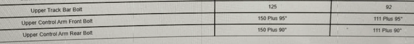

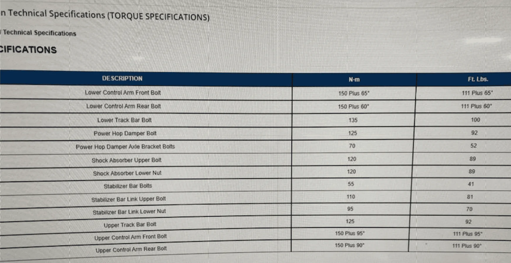

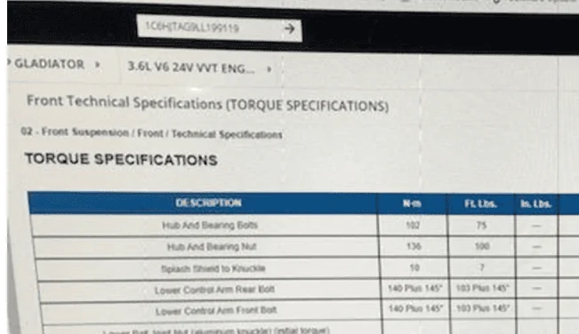

You referring to the angle the bars/LCAs must be when torquing parts? Moment centers & roll centers?
No, I'll give the example of the torque spec for the rear suspension upper control arm rear bolts - the spec is to torque to 111 ft/lb, then turn the bolt 90 degrees more.
It's a modern method the automakers have been moving to, especially critical when clamping force is the most important thing. They can get a much better idea of the force when done this way.
This snippet is right off the screen of a Jeep tech. I have the fronts but he used his phone to take a picture and it is really fuzzy. The rear turned out fine, or at least readable.....
TA is Torque plus Angle. Tighten to the spec for torque as usual, then the specified number of degrees more.

This is rear - I'm still trying to clean up the pictures of his screen he sent me of the front specs. I hate to ask him to do it again - I offered to pay but the manager said "no, I'll have my guy try to find time to get that for you" and I figured he'd do a screen shot or a print screen, not a photo on his phone LOL

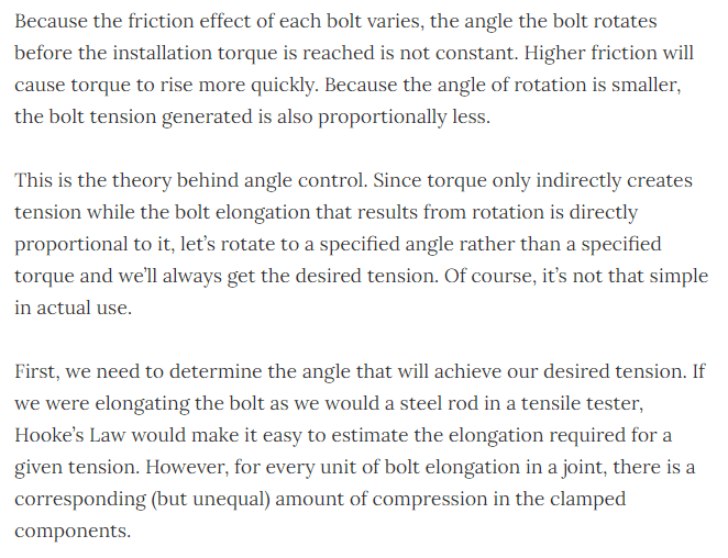

From another automotive site:
Since we’re going back to basics, let’s cover the basic purpose of a fastener. A bolt is used to hold two objects together. In automotive applications, there are often specifications for how tightly you want the two specific parts held together. Too tight and you risk damaging the parts or the fastener itself. Too loose, and there isn’t enough clamp load and the two parts can leak or shift under load.
The amount of clamp load (how much the fastener “squeezes” the two objects it’s joining) is determined by the fastener’s diameter, material, and how much the fastener is stretching. Since we can’t measure the actual stretch of a bolt (save for rod bolts, discussed in the linked article below) we need to find another way to measure bolt stretch.
For a lot of years, the automotive industry has used torque values to be that yardstick. The thought process being, by calculating the amount of resistance to rotation, it could be determined how much force was being exerted on the threads. While that is still a highly effective method of determining clamp load, there can be some drawbacks and inconsistencies with the method.
To explain how torque angle works, we need to work backward. Engineers first determine the desired clamp load for the items. Once they know that, they can run the numbers based on fastener size and material to determine the required bolt stretch to achieve that clamp load. From there, it’s simply a matter of taking the thread pitch of the fastener and determining how many degrees of rotation are required for the fastener to be stretched the desired amount.
While it seems complicated, the reality is that all of the big-brain calculations are done by the engineers of the application ahead of time. All you have to do is be able to accurately set the first-stage torque (which is usually relatively low, in order to be able to better withstand any variations in conditions) and then properly measure rotation from that point forward.
To accomplish that, there are tools at both ends of the price spectrum, ranging from home-made templates crafted with a protractor, marker, and paper, to inexpensive dial-gauges that fit between your ratchet and socket, all the way up to digital torque wrenches with built-in angle gauges.
Will we see torque angle measurements take over the automotive industry? Probably not any time soon. However torque angle specifications are becoming more and more prevalent, so understanding and knowing how to properly use them will be a valuable skill in your mental toolbox.

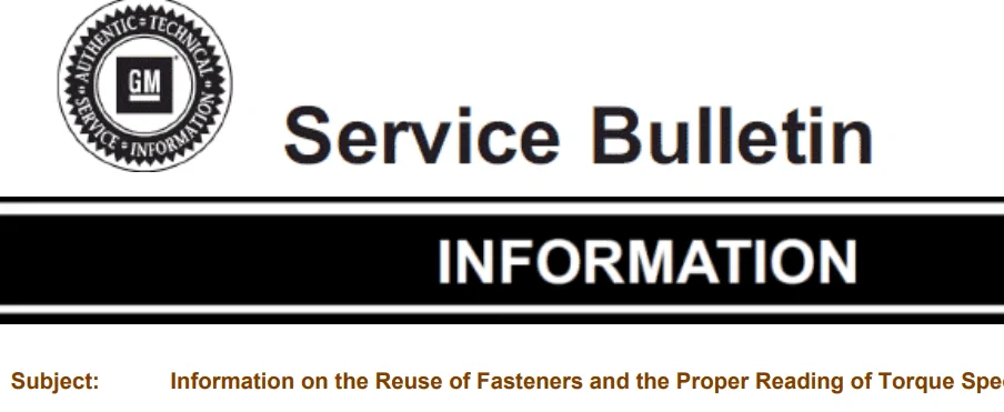

And finally, this is from General Motors - GM is using more and more TA specs on suspension and steering components as well as other areas. That's both at the factory during assembly, and for service specifications. Replace certain GM parts and there's a TA spec.
Anyway, this is from a GM Technical service bulletin (it's my hobby to read automotive tech stuff)

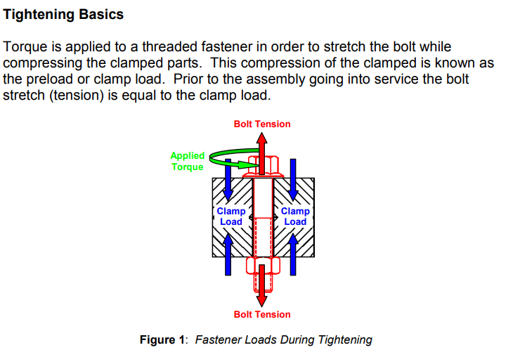

The following is information regarding the proper reading of torque specifications and the re-use of fasteners.
The desired result of tightening a fastener is to obtain a proper clamping force between the parts. The clamping force prevents loosening when the vehicle is in
use and external forces act on the clamped parts.
All fasteners have a specified torque. The method used for a particular application is determined by Engineering and specified in the Service Information. It is
necessary to apply the fastener torque to the specific fastener identified. Applying torque to the mating fastener can damage the fastener, mating components or
provide insufficient clamp load.
For example, when installing the adjust link on the 2014 Corvette rear suspension, the Service Information calls for tightening the adjust link nut to 70 N·m (52
lb. ft.), not the cam bolt.
There are three different methods for the specification of tightening fasteners: Torque (T), Torque Plus Angle (TA), and Torque Plus Angle to Yield (TAY).
Torque Plus Angle to Yield (TAY) is sometimes referred to Torque To Yield (TTY).
A fastener specification of Torque Plus Angle (TA) — for example, 30 N·m (22 lb. ft.) + 120 degrees — has more clamping force than a fastener specification of
Torque (T) — for example, 30 N·m (22 lb. ft). A fastener specification of Torque Plus Angle to Yield (TAY) has more clamping force than a fastener specification
of Torque Plus Angle (TA).
Torque (T)
A fastener with a Torque (T) specification can be tightened with a conventional torque wrench.
Tip: Generally, externally threaded fasteners (bolts, screws, studs) tightened to this specification method can be reused, unless otherwise specified in the Service Information.
A fastener with a Torque Plus Angle (TA) specification must be tightened first to the torque part of the specification and then must be tightened further by the addition of the specified angle. The angle must be applied relative to the mating fastener, if present, or relative to the mating surface. A backup wrench must be used, if required, to prevent the rotation of the mating fastener while the angle is added to the fastener with the Torque Plus Angle (TA) specification.
Tip: Generally, externally threaded fasteners tightened to this specification method can be reused, unless otherwise specified in the Service Information.
Reusing the Fastener
Think of an externally threaded fastener (bolt, screw or stud) as a spring. As a Torque (T) or Torque Plus Angle (TA) tightening specification is applied, the spring (externally threaded fastener) is stretched. With a Torque (T) or Torque Plus Angle (TA) tightening specification, the spring returns to its original length (elastically stretched) when loosened. In the case of a Torque Plus Angle to Yield (TAY) tightening specification, the spring is overstretched (plastically
deformed) and does not return to its original length. For this reason, the Torque Plus Angle to Yield (TAY) tightening specification requires the externally threaded fastener to ALWAYS be replaced.
