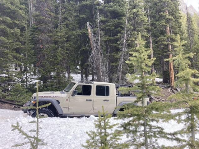

Mine hopped pretty readily in snow and sand with the factory Rubicon Fox shocks. At about 70k miles I replaced those with much stiffer Bilstein 5100s which improved the ride and handling, but it still had pretty ready axle hop I snow.
Today I got a chance to play around in some snow a bit and I did not get any axle hop. This was not really a definitive test, I would like to run around in snow for a few hours to try varied conditions; at first blush it seems that the kicker shock minimized (actually eliminated) axle hop. But, this was only maybe 30 minutes of playing around in some 12-18ā€ snow.
I spent the last week camped in the Idaho Sawtooth Mountains and explored many forest service type roads and found a lot of snow. I am happy to report that all rear axle hop I is gone, the kicker shock seems to have eliminated it completely.
Jeep Gladiator wheel hop in fresh snow CB5B2433-35EC-432D-BE46-D50DEB4A300D

Thanks 4S50, I have experienced some wheel hop beach driving and have a differential shock on the way, brackets are there ,not too much work we will see…..Jack
