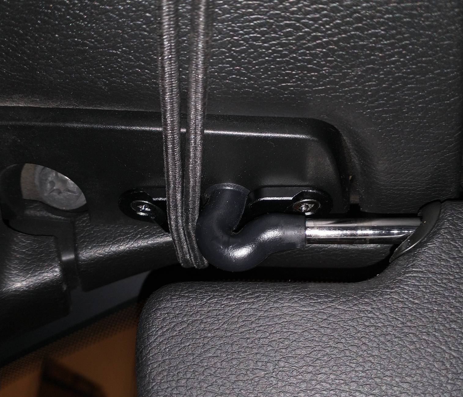

My visors weren't broken but installed these today as a preventative measure.
The front bungies from my mesh sunshade acted as a second set of hands holding the brackets in place as I tightened them down
