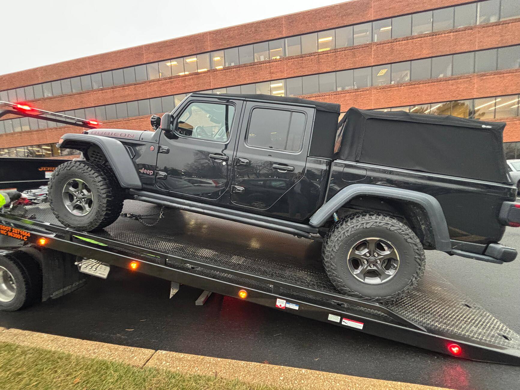

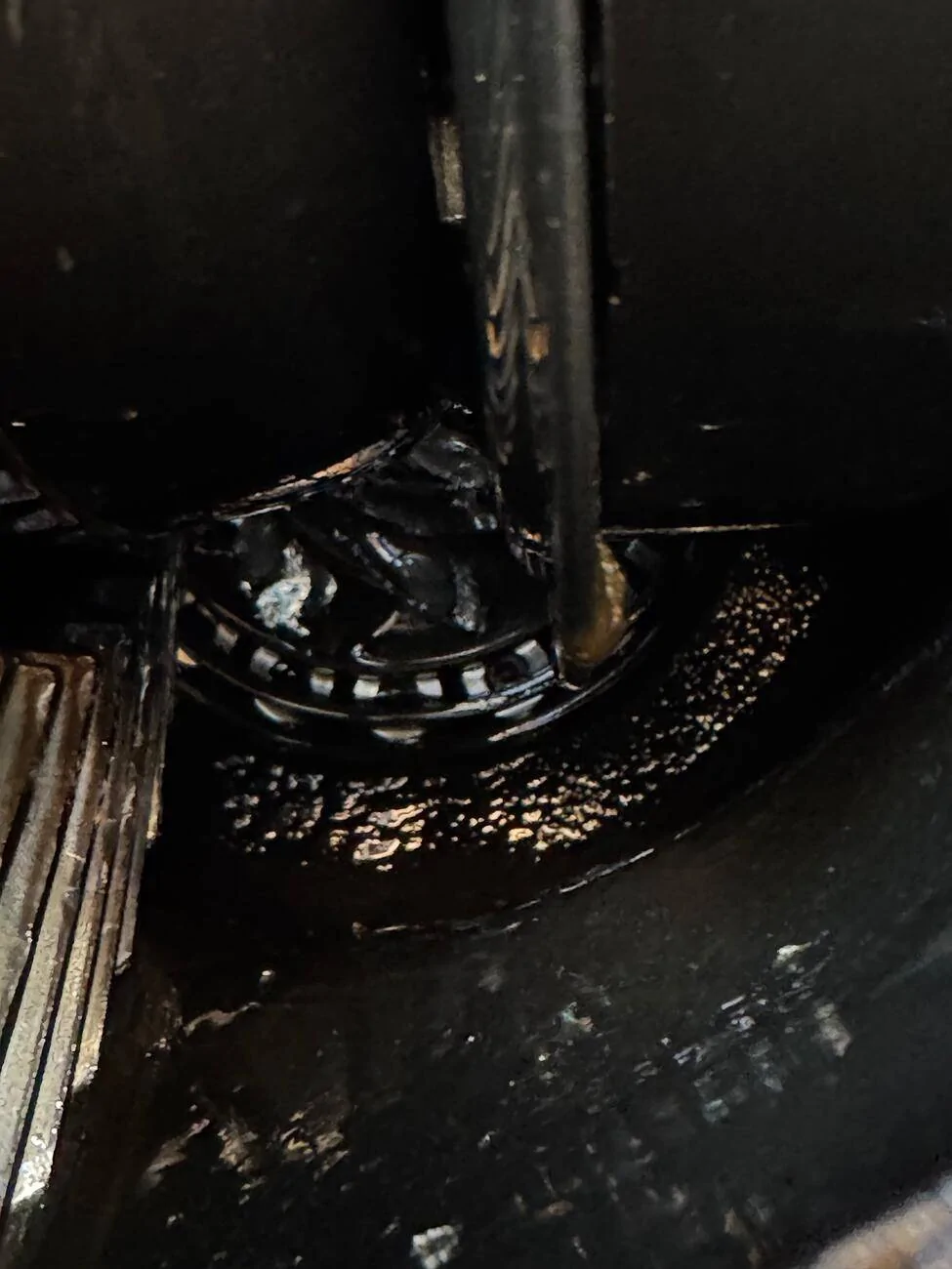

Also - my opinion but stay away from Yukon. they are having a ton of failures and quality control. I fell victim to this recently. They used to be a good outfit but sold out to Chinese / overseas. That's my Yukon pinion that disintegrated without warning on the highway on Monday.

thanks for replying!
The Gladiator on the bed does not make me happy…
I thought Yukon should be good, as it’s „used“ (maybe more advertised) on lots of YT videos…
