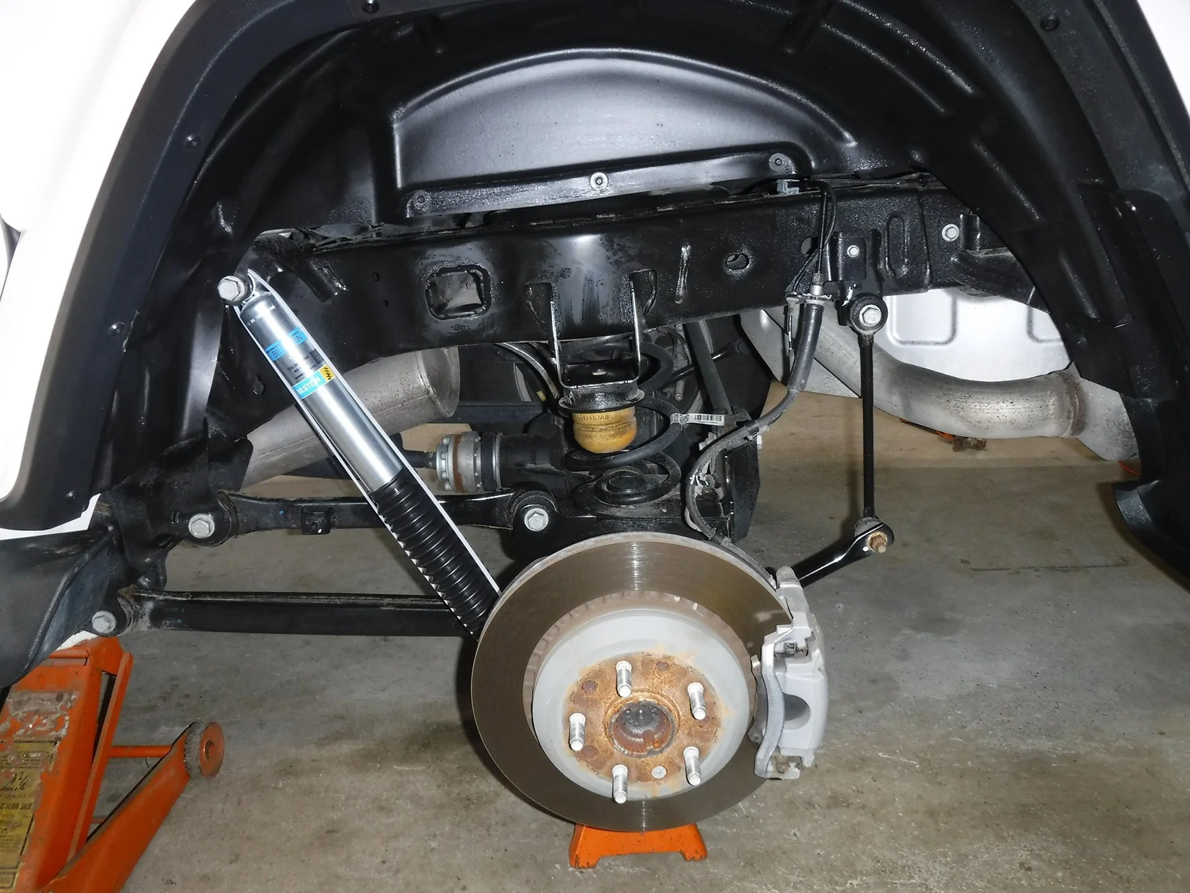

I'm one of them there old grumpy, smelling like swamp cabbage, olde farts who wipes his maul crawler down on any install.
The Pledge makes it smell lemony fresh!
Kind of a pain in the tookus putting them in.
Did I share I'm an old grumpy smelling like swamp cabbage olde farts who wipes his maul crawler down on any install.
They say mammary is the second thing to go.
I don't remember what the first thing is.
The job taking the olde ones out, and the gnu ones in took me a while.
Don't get olde.
Jeep Gladiator Which shock?  Stock height. DSCF5308
Jeep Gladiator Which shock?  Stock height. DSCF5307
Don't get olde.
I'm getting there, but I still get around. I took a front and rear off just to measure and compare what the book say they are. Maybe 20 minutes on and off. I did it with wheels on the ground. I am wondering if I can compress those new ones.

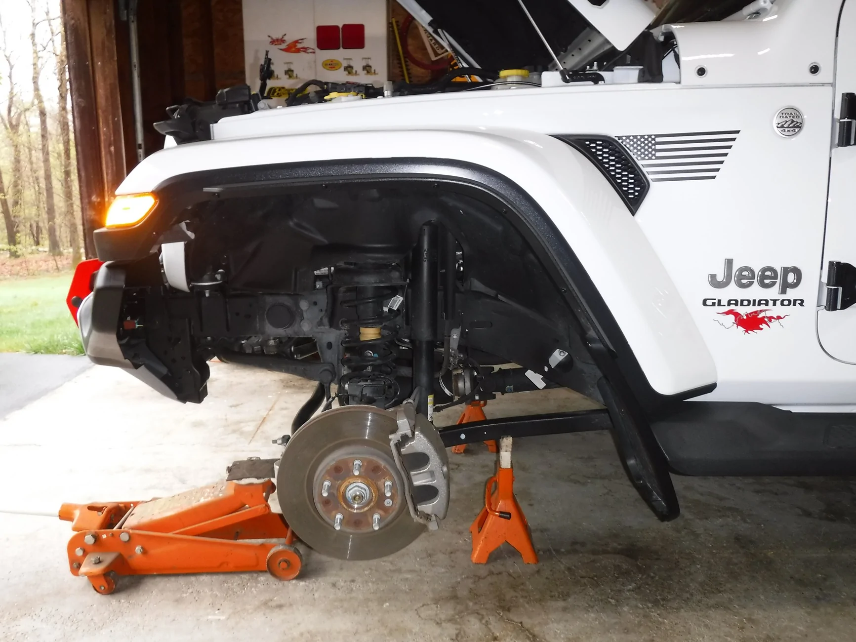

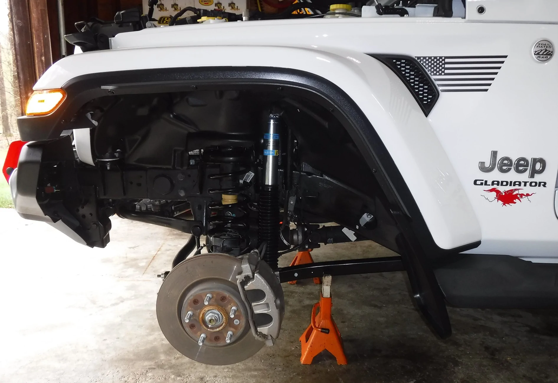

The strapped rears were a joy.
The fronts were the buggers.
My big pry bar "Big Mo" did his magic to get the bottom eyelet into the LCA pocket.
Too, the fender liners causes some issues too.
Reluctantly, I made a couple of careful relief cuts in the fender liner in the front for the top bolts.
Mine is an OVERLAND, a "Ruby don't take your love to town" might be easier.
Jeep Gladiator Which shock?  Stock height. DSCF5310
