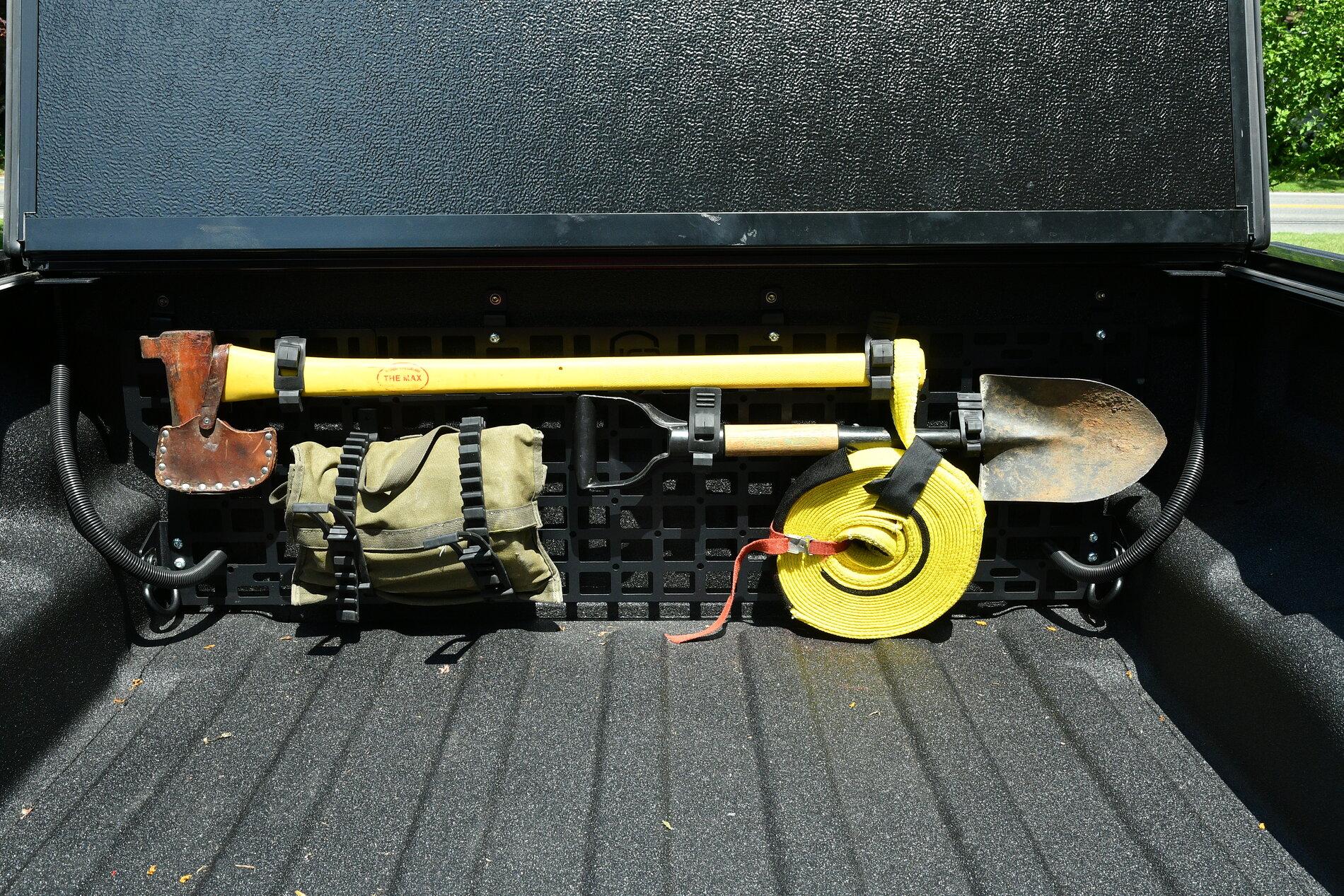

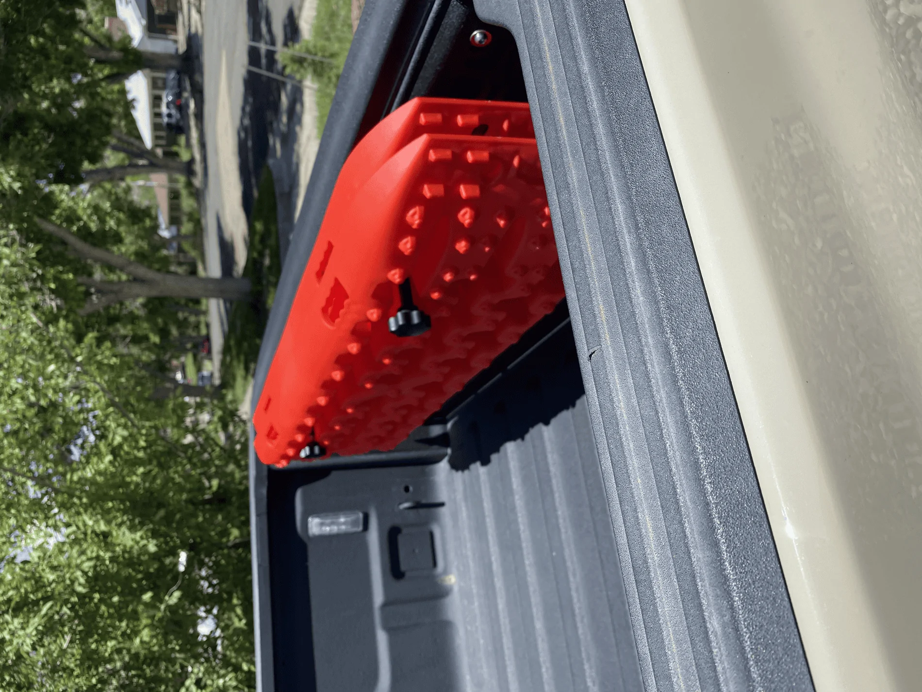

@49Gramps any pictures of how your tow strap is mounted? I'm working on the best way to mount mine and am yet to find a solution that keeps it secure but still fairly easy to get in and out. Thanks in advance!
Here's what it looks like!

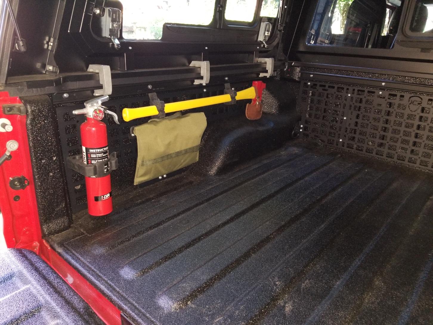

Thanks @49Gramps! Appreciate the pics, great to see someone else with the Max Axe Kit.

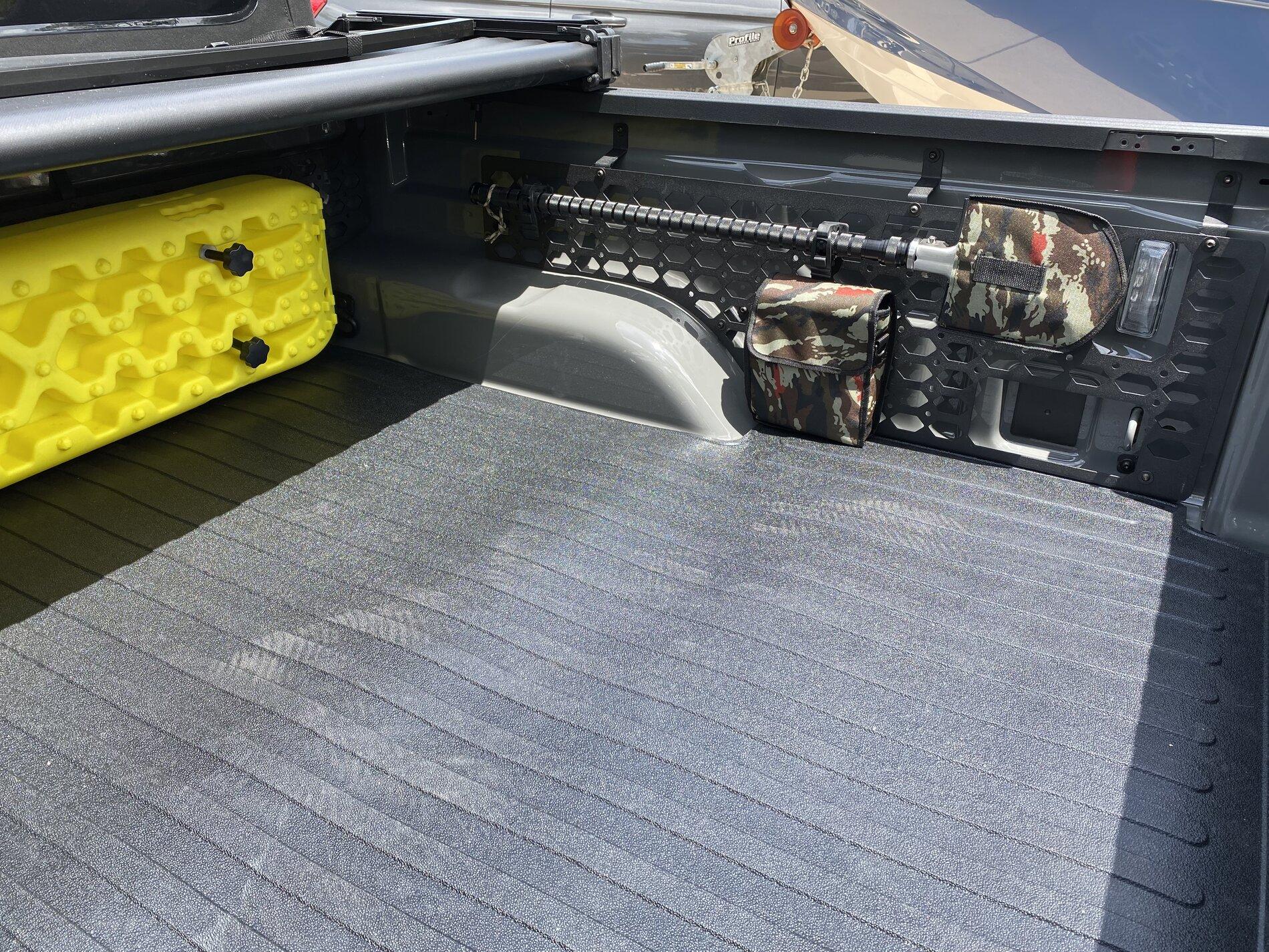

Jeep Gladiator Who has Molle Panels in their Bed (Photos) 20210621_171701
Still working on getting the recovery gear mounted.

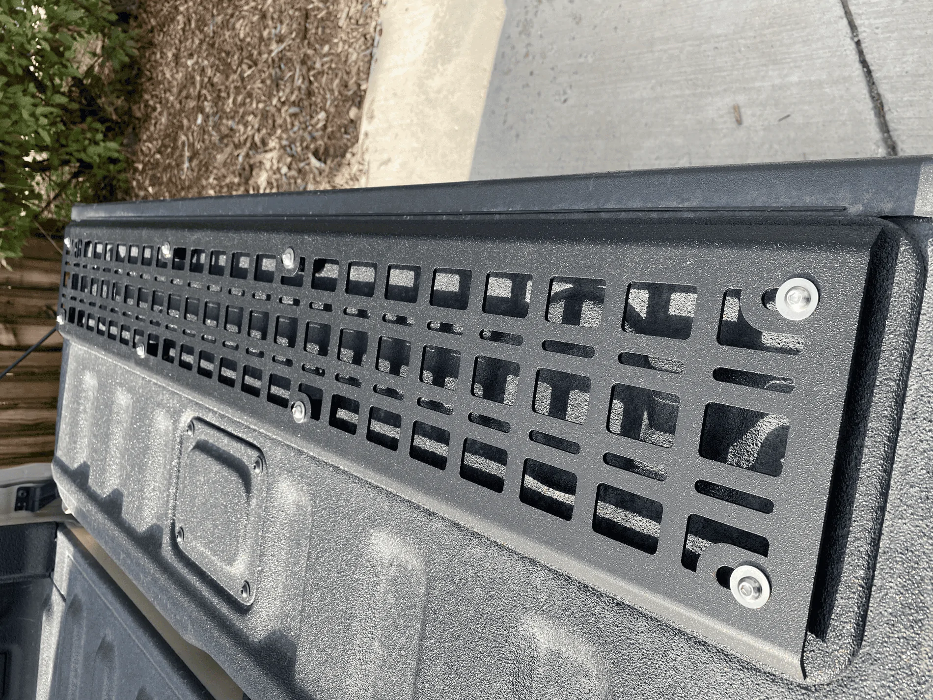

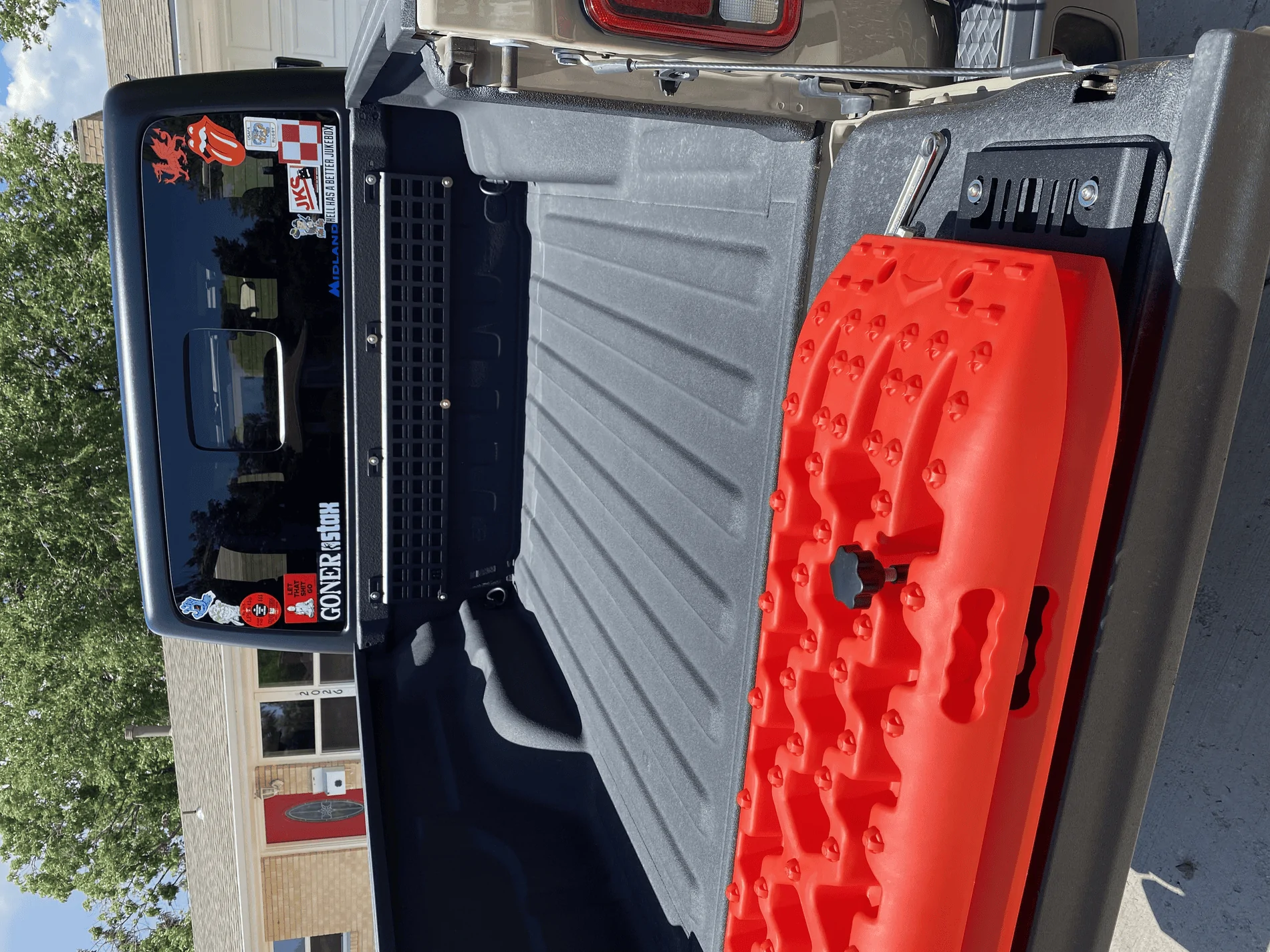

Jeep Gladiator Who has Molle Panels in their Bed (Photos) C4B5E484-F508-4B6D-A0F2-79E5B0968DA4
Jeep Gladiator Who has Molle Panels in their Bed (Photos) 39E99FF1-3EF5-4D32-A4D5-7C2F45947866
Jeep Gladiator Who has Molle Panels in their Bed (Photos) A1AB4392-CE6F-44D5-8172-C801B86C012D

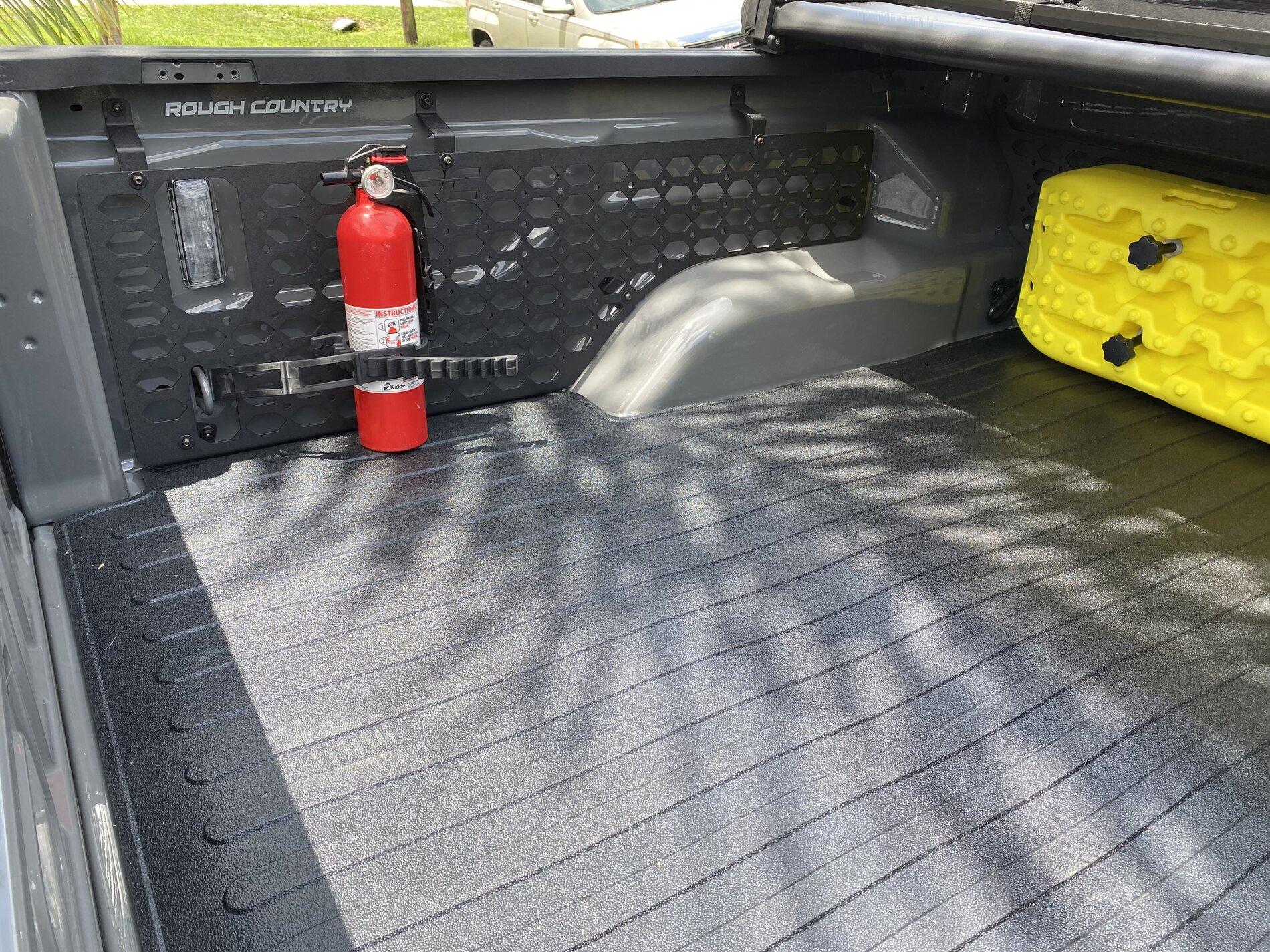

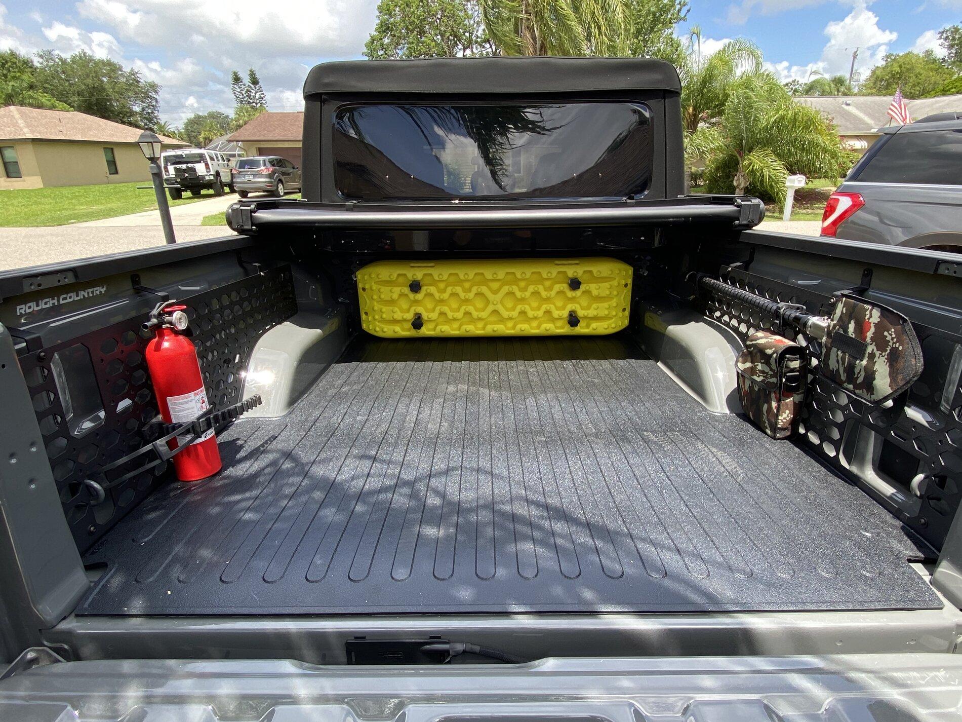

Really pleased with the Rough Country set. Very solid panels. Easy install. Drilling was much easier than anticipated. You will need a nutsert tool. I did not have one so I just ordered theirs. Also, you may need nutserts for the upper corners of the cab panel. My truck did not come with them installed.

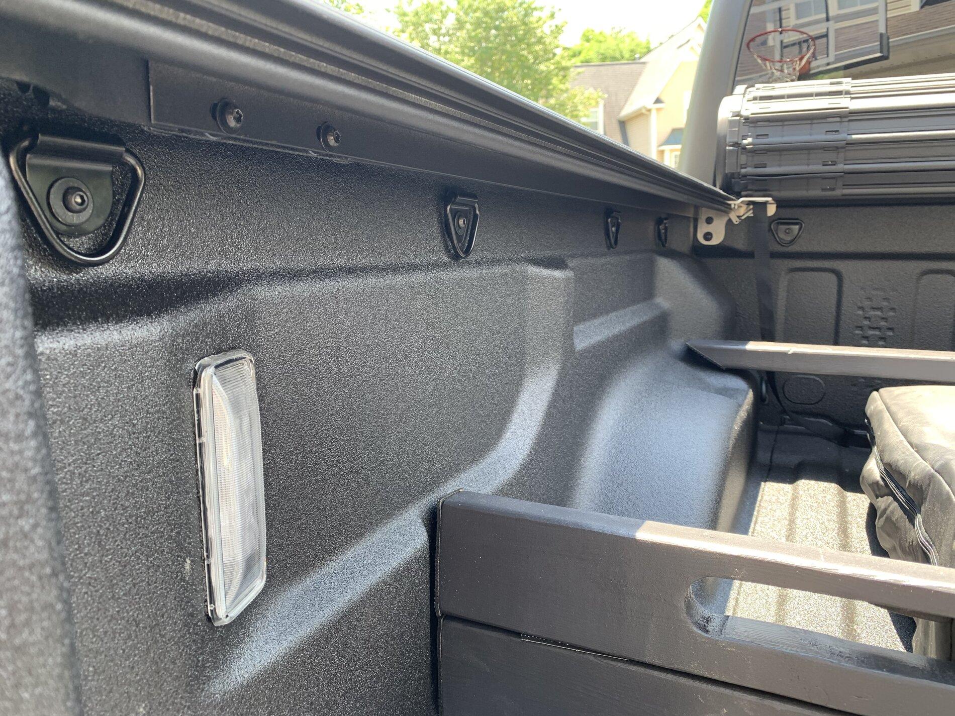

This is what I did. Used all 12 holes on sides and back. Works perfectly for my needs.
Jeep Gladiator Who has Molle Panels in their Bed (Photos) 0DFE1FB8-7458-4F01-ABC9-A409423F279B

Honestly I think both are good and you can have both at the same time - Molle panels and light duty D rings. You have yours mounted upside down (the D rings) by the way. They don't go that way, they are supposed to have a spacer that allows them to rotate on the bolt and they will hang down in the opposite direction.
The Rough Country Molle panels are very nicely fabricated - nice thick strong steel and precision machining. Where they are lacking in my opinion is strength of attachment. A big solid metal panel like that - people will want to attach heavy loads to it. They'll be pretty upset when the crappy little attachment brackets that Rough Country supplies rip out of the sheet metal. I did purchase and install the Rough Country Molle panels, but I added more than double the attachment points and if you remove the inner fender liners, you can put any kind of nut, bolt, fastener, reinforcement, whatever you want to attach them. And you can attach the little black D rings and the Molle panels at the same time.
