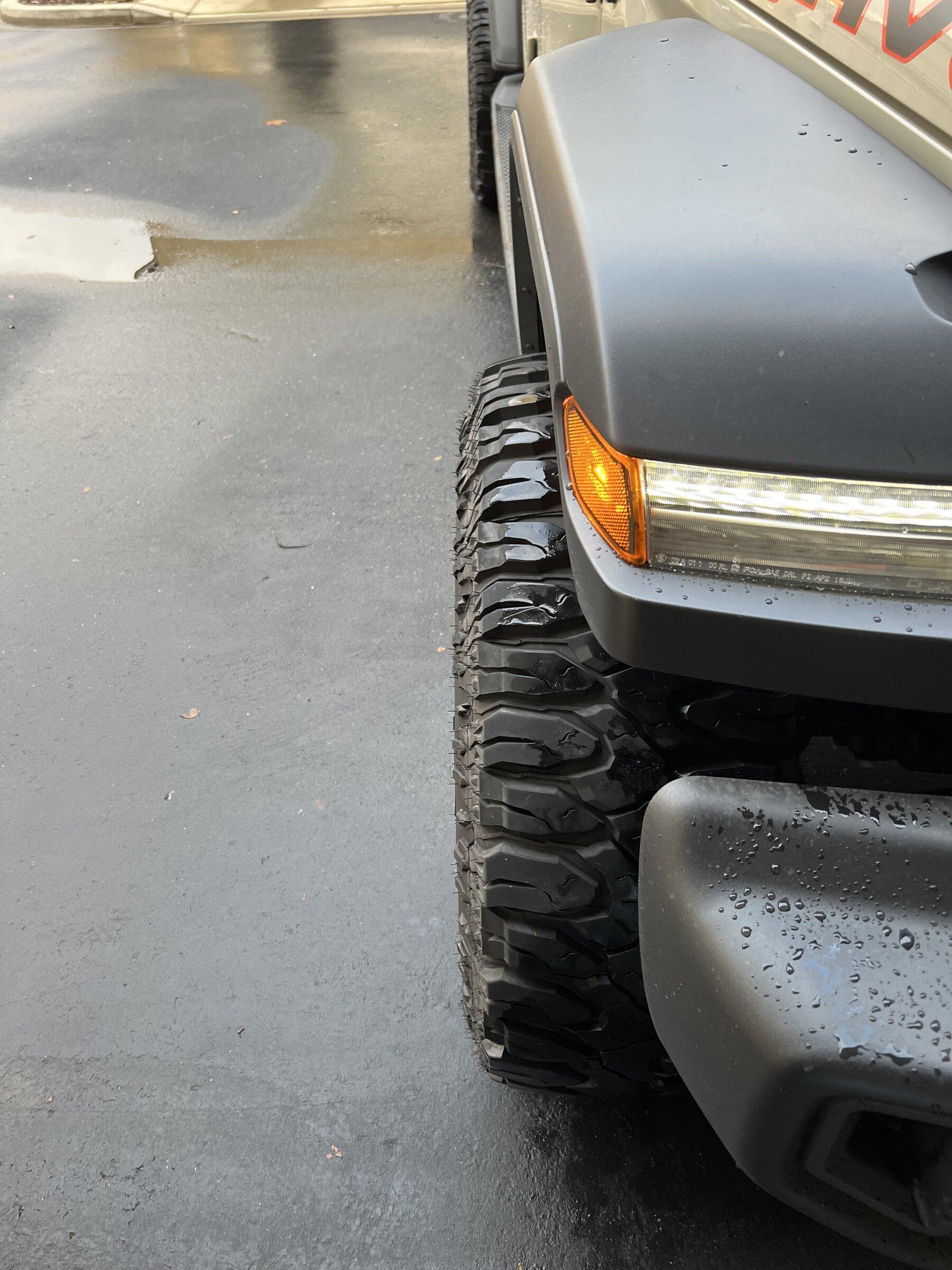

I have the same backspace and offset with my FUEL COVERTs.You need the backspace for clearence with 37s and stock fenders and they will stick out about an inch for 12.5 wide tire on a 17x9 rim. Also do you have your Falcon shocks already? I ordered mine in July of last year and still no luck.
They’ll stick out more than 1”.
I had 12.50 wide on stock wheels and no wheel spacers for a few days. Didn’t rub anywhere, but this was with 20x8 wheels and wide axles on the High Altitude package.

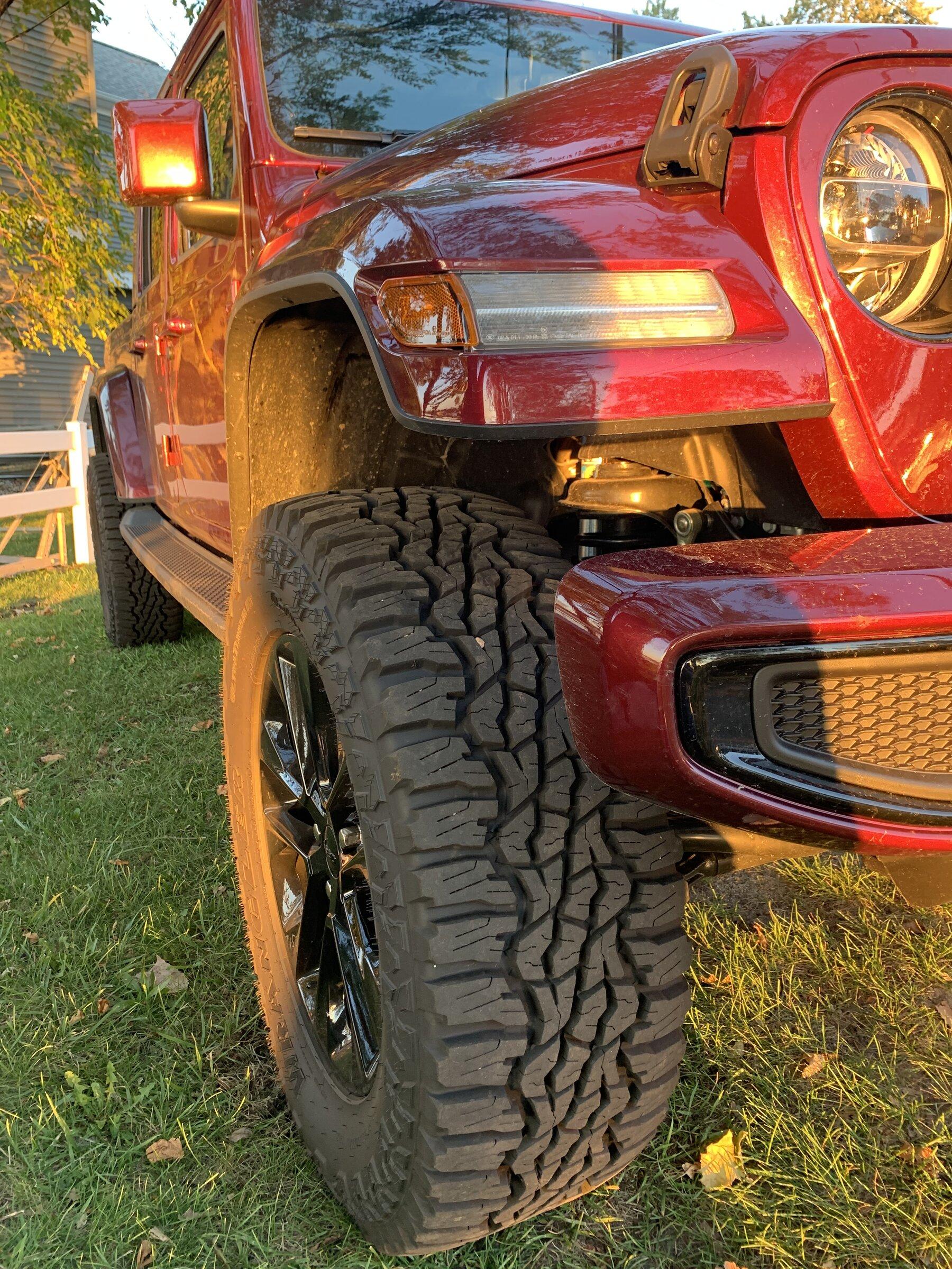

BEEFY. Love it. If I recall @cannonFodder, you bought your rig with 22's and I think your profile pic still shows that. What's been your experience going from 22's to 17's?
I actually saved some rolling mass weight by taking off the 22x10 and 35x12.50 combo and replacing with the current setup. No difference in driving experience. Much more interest in it when it's parked or driving - lots of thumbs up and smiles.

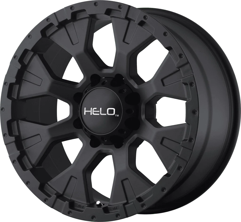

Has anyone had a bad experience with specific wheel manufacturers? Or maybe a better way to ask is what are the preferred wheels for off-roading?

I am going with 17s. Just wanted to make sure I understand why it was being recommended. I am still trying to figure out the offset and backspace. I want the tire to be slightly past fender. Max 1” but maybe less. What offset and backspacing should I be looking for?
11,373
30,355
When you guys talk about offsets and back spacing. Please say what the rim width is too. Because a 8" and a 9" will be different. A 8" with a 0 offset will have different back spacing than a 9" with a 0 offset.
