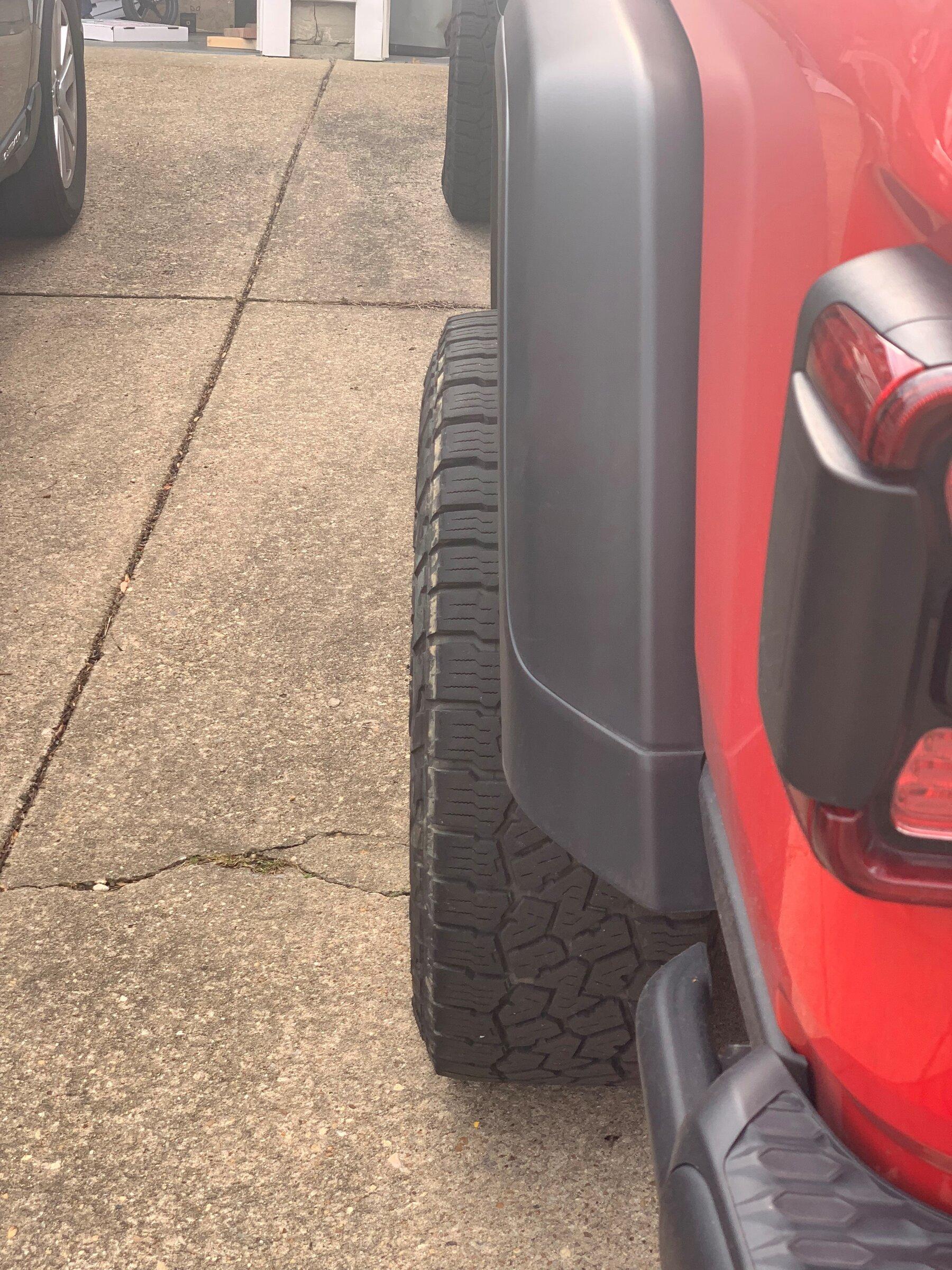

I’m on -12 with a 4.53 backspace. Not the best shots but what I got.
Ps… I am that bad driver lmao

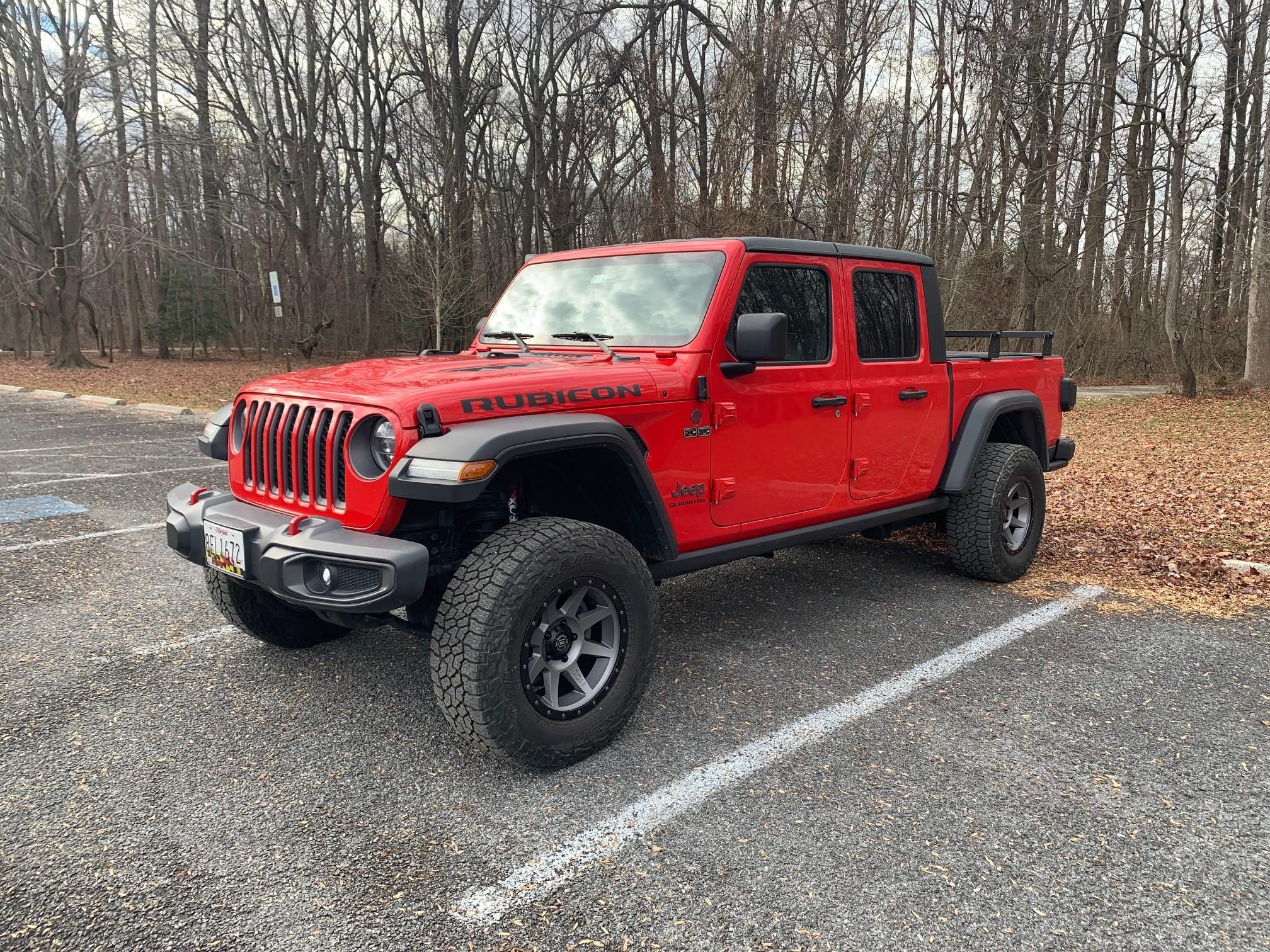

I went with the Icon Rebounds which have a 4.5" backspace (-6mm offset) and they poke about 1.5" to 2". It does not look obnoxious in my opinion....but everyone has their own. I should note that I'm currently only my stock 285's (33's) so your "poke" would be a little different.

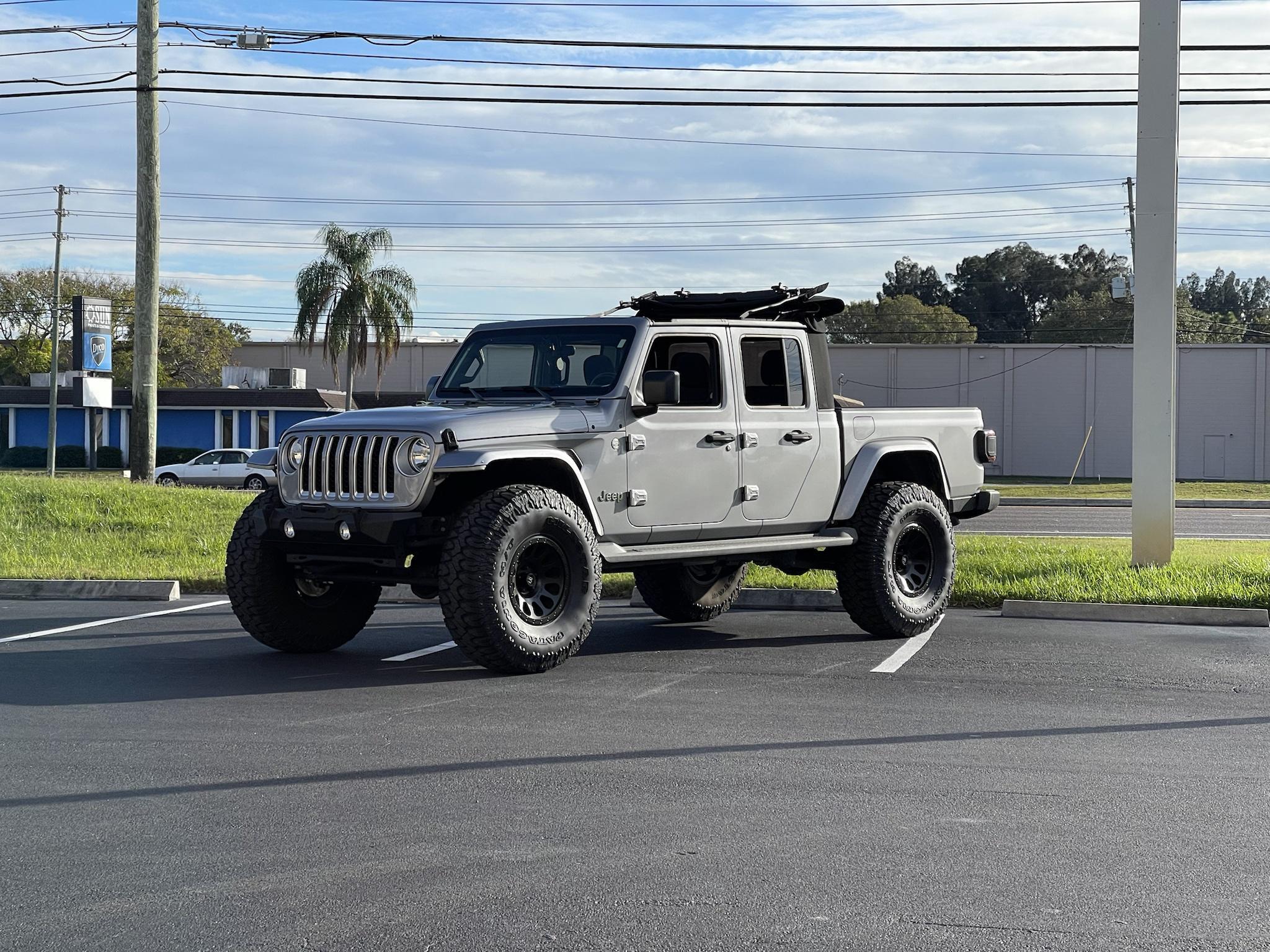

Jeep Gladiator Why 17" vs other bigger sizes RmChaDG
There's quite a few 40" tires on 17" wheels around me, so it was weird to read a lot of the apparently uninformed opinions.

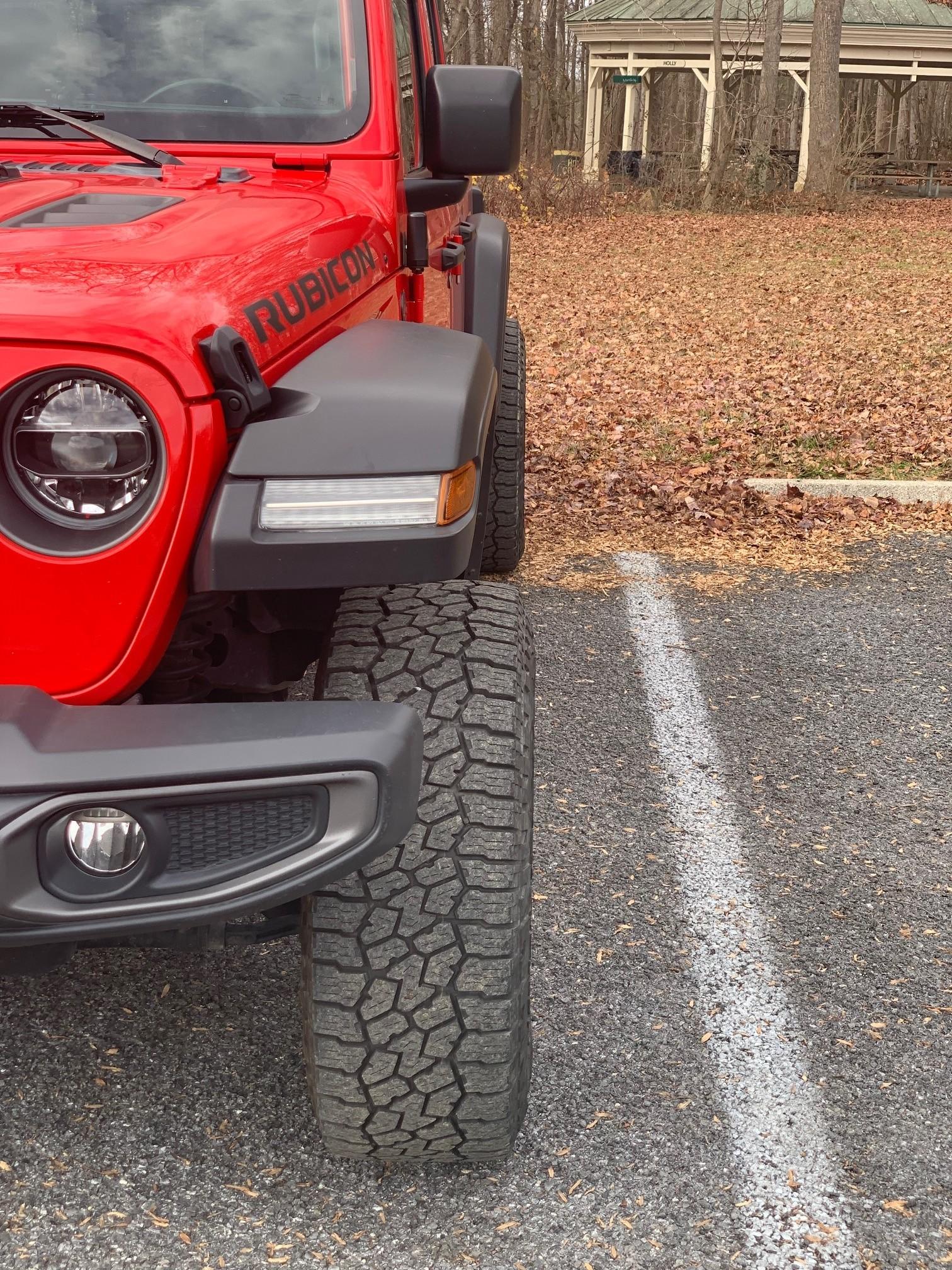

It looks like -12mm might be little bit more than I want based on the picture as well as the calculator. I most likely will have to go with 0MM or slightly positive offset which rules out the wheel I was looking at since it's only available with -12mm.
For tire I am looking at 37/12.5/17s
BEEFY. Love it. If I recall @cannonFodder, you bought your rig with 22's and I think your profile pic still shows that. What's been your experience going from 22's to 17's?
