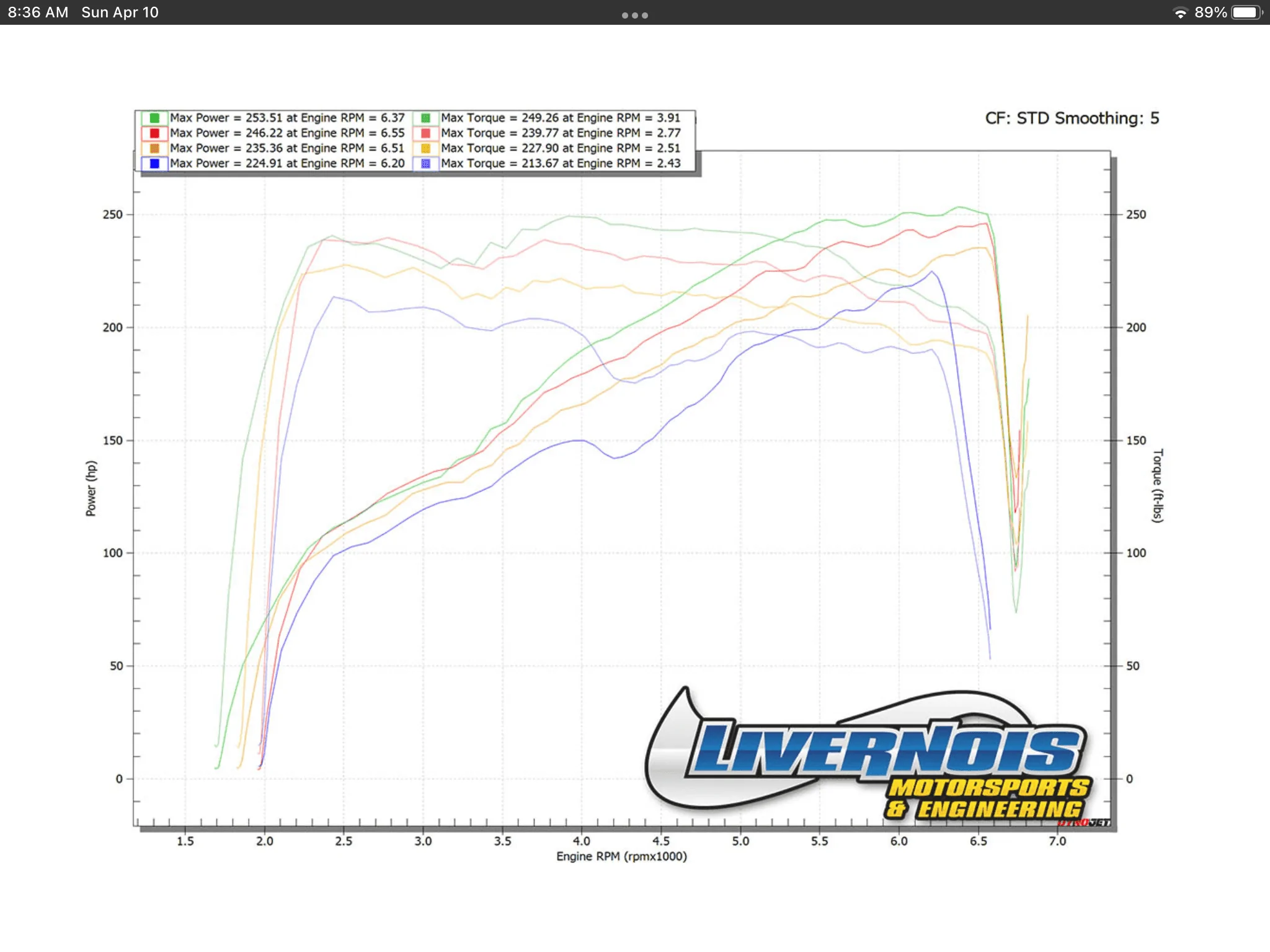

I'm uncertain if anyone is supporting (able to unlock) the newer ECUs yet, but the Livernois gains are huge. I'm not really sure how they achieve this but hopefully they leave cam timing mostly alone. If they end up supporting new ECUs, I'll probably go the Livernois route.
Jeep Gladiator Why does JT have poor throttle response? 95F2D13E-423B-461A-BFBB-BCA558F15F6A

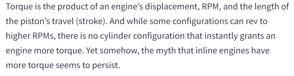

The 4.0 (258cid) is a straight six. In line produces more torque,
Not because it's an I6, but because of the long stroke.
I've had various long and short stroke engines. The longer crank throw and longer stroke = torque, not the configuration of the cylinders. Early V8s had tall cylinders and longer strokes but the need to downsize engines reduced the stroke. People wanted HP and fast acceleration. That's harder to do with a long stroke engine.
- here's supporting documentation -
Jeep Gladiator Why does JT have poor throttle response? 1680061106409
The I6 is naturally balanced, and the configuration in the past allowed for tall cylinders, longer strokes, thus the torque. But there are drawbacks as well - including the need to support the long crankshaft and prevent crankshaft twisting. AMC touted "7 main bearings" with their 232 engines, and the later 258 (and of course the 4.0 inherited this)
