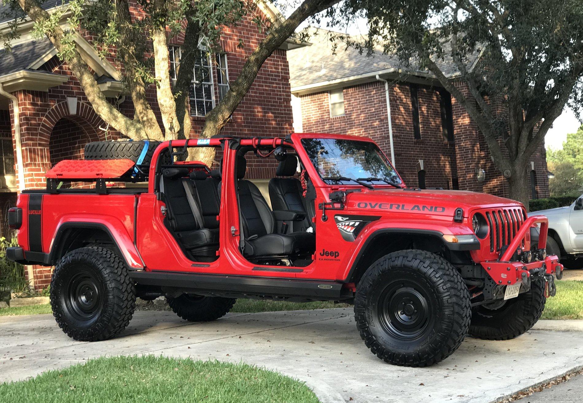

If you don’t want 18ā€ wheels change it , all Gladiators have a 10mm thicker axle tube & 32 spline axle shafts, rubi & Max Toad gets 1 1/2ā€ wider axles & 4.11 gears āš™. I wanted color matching fender, 8.4 navigation premium stereo, LED lights, and leather, Rubicon was the only one offering that other than Overland when i bought. So that is what I bought. There are plenty of things to choose for everyone with different needs. My Gladiator has every suspension part replaced, 37’s & 5.13’s limited slip rear works for now. It rides better all around driving. And still tows great. 5,000# camper. Love the one you’re with lol.
Jeep Gladiator Why is Overland the only model to have 18's? F7FF35C1-F4CA-4DFF-BDE5-1D3A06EBF1E2
40,500
54,020
I love your Jeep.
Mine is still a work in progress.
I love the Overland wheels, the tires are fine for good weather and summer and highway and putzing around. I have Rubicon take-offs for winter and bad sh.....
Jeep Gladiator Why is Overland the only model to have 18's? 20201015_165944_HDR
