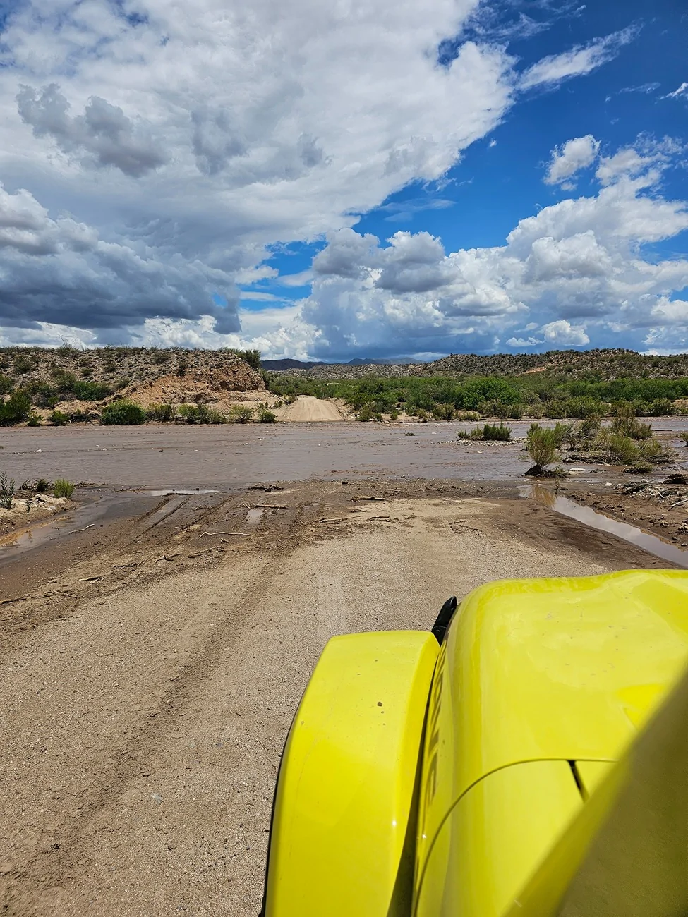

I primarily bought my JT for desert off roading, so the mojave was the obvious choice. ~5 months after I bought it we bought our off grid desert property. With that came everything from hauling our own water to towing our entire cabin out there. The max tow was never an option for me, as even the last 20 miles to the property are washboarded dirt, and this wash is the only way in. Even lifted the mojave makes a decent work truck, and having towed the 1st water buffalo with a base 4x4 F150 I'd argue it's a far better desert work truck than anything outside the raptor or trx/rho. They are all max tow if you need them to be in my experience.

I primarily bought my JT for desert off roading, so the mojave was the obvious choice. ~5 months after I bought it we bought our off grid desert property. With that came everything from hauling our own water to towing our entire cabin out there. The max tow was never an option for me, as even the last 20 miles to the property are washboarded dirt, and this wash is the only way in. Even lifted the mojave makes a decent work truck, and having towed the 1st water buffalo with a base 4x4 F150 I'd argue it's a fast better desert work truck than anything outside the raptor or trx/rho. They are all max tow if you need them to be in my experience.
Thats beautiful btw!! Awesome bless you and your family.. Yes i do agree they all can pull and haul the max tow capabilities, even the diesels. Some could used some more help then others. After market takes care of all of these issues for us and can make our rigs much more capable. As you know the Mojava has all the goodies like the 4:10 gears and wide track axels plus things like reinforced frame. steel knuckles,etc.
