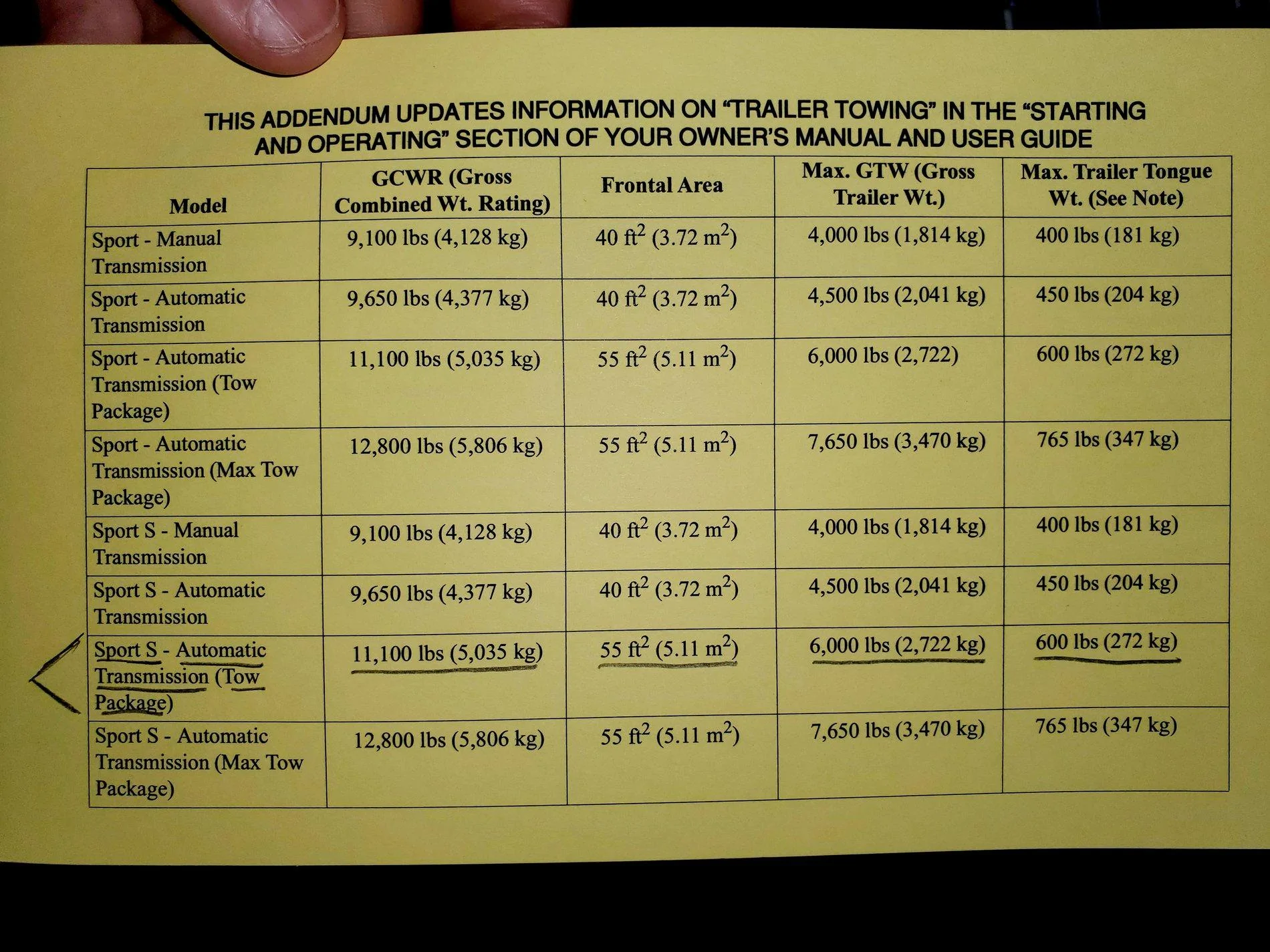

Here is a supplement I found to our manual. It was in the back of the glovebox. The underline is mine. I got the regular tow with hd engine cooling, trans, and oil coolers, 240 amp alternator. I also got the lsd. The 4.88 gears are going in next week. I dont tow a lot on the island but it sure adds a lot of nice parts to my truck for 350 bucks as an option.
Jeep Gladiator Why you SHOULD be able to tow more than sticker outside of the mountains 20200320_151715

I think this article says just because you should be ABLE to doesn't mean you should DO it
https://auto.howstuffworks.com/auto...pacity/information/truck-towing-capacity1.htm
When you ask your truck to pull more than it was meant to -- exceeding its towing capacity -- a number of things start to happen: The brakes begin to fade, the added weight contributes to tire failure, and the extra work required of your engine causes it to overheat, which, in turn, overloads the drivetrain and shortens the life of your transmission. Although you may not see the effects of exceeding towing capacity at first, the gradual wear and tear will lead to eventual failure. The best case scenario is repeated trips to the repair shop; the worst is a major wreck...the extra weight pulling on the back of your vehicle significantly hampers your braking ability and steering control. When the back of your truck is loaded down, the front tires come up, causing them to lose some traction with the road. Without those front tires firmly on the ground, you'll definitely see a negative impact on your stability and handling. Your truck's brakes, which were designed to stop a limited amount of weight, will either take much longer to slow the vehicle down in an emergency or they simply won't work at all.
For me, I am happy knowing that if I need to try and yank a 9000lb vehicle out of a ditch, I won't destroy my JT doing so. Or if I need to tow at GCVR (900lbs loaded truck + 6250lbs trailer) I should be fine and not worry about the extra extra wear because the JT was designed to do more than that
Edit: keeping the GCWR of 12,500lbs is important. That limit, like the axle weight rating, is mechanical and not based on tricks. 12,500-7650+300 = 5150 means your gross vehicle weight needs to be 5150lbs. I think the JT sports are around 4700lbs. So 5150lb of GCVWR left, less 4700 = 450lbs. so you can have that 7650lb trailer and you in the vehicle, that's it. Because 10% of the tongue weight is 765lbs, which is 300lbs over the payload at that point.
Something doesn't add up. Does the GCVWR include a 150lbs driver and 150lb passenger like the test does?
12500 (GCVWR) -6250 (GVWR) = 6250lbs. So 1500lbs payload at best (for simplicity) means 735lbs of payload left with a 7650lb trailer. Looks like it's just the family in the truck. ALL the gear goes in the trailer!
The bigger issue is the trailer just starts pushing the truck around. Corners are not fun as the trailer wants to push you in a straight line. Declines are not fun as the trailer wants to push as fast as gravity will cause and will overload your brakes. Going up hill can be managed with slow speeds, but the other cars will hate you. Anything can be done, but too much trailer will make it a miserable trip.
