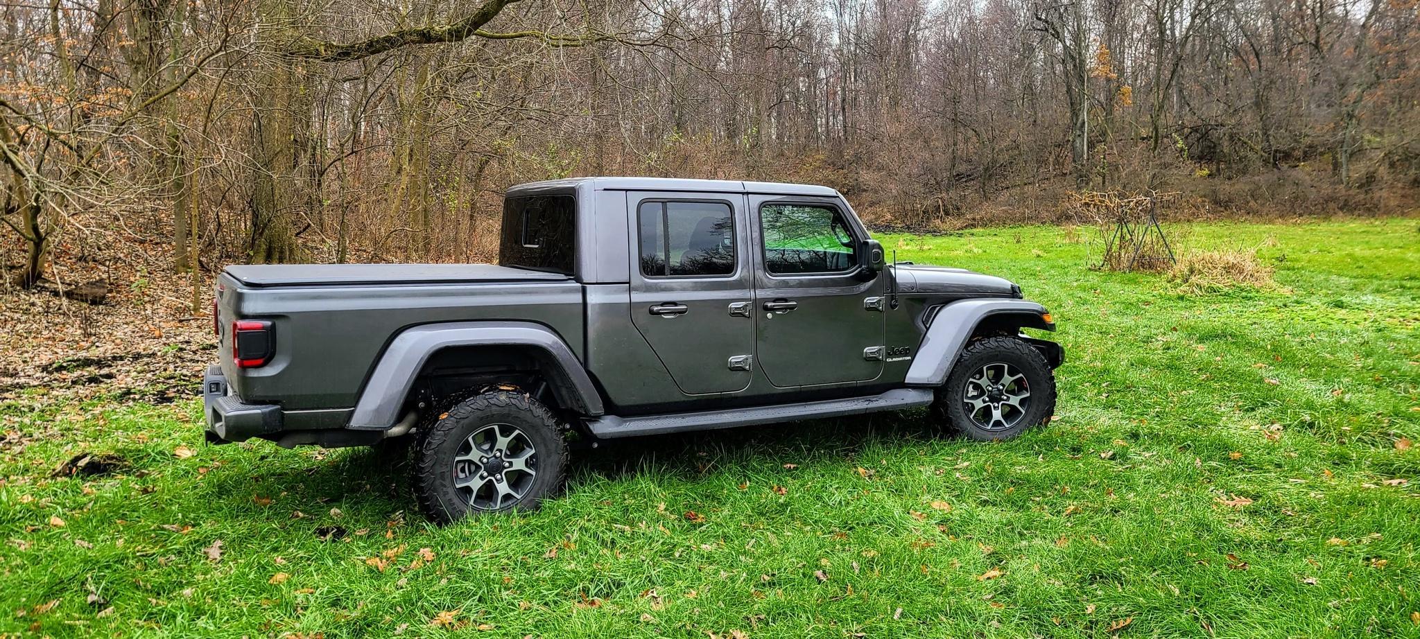

I switched from 20” wheels on my High Altitude to 17” JLU Rubicon wheels with no issues. I will say the brake calipers are MUCH closer to the wheels than they were before. Everything fits just fine though and the BFG AT KO2’s will be much better in the snow than the “minivan” tires the HA came with.
I will be putting the HA wheel set back on in the spring though. Better ride and better mileage.
Surprised they ride better, I would think the BFGs with much taller sidewalls would ride better, what load range are the BFGs?

They are factory “C” load range.
