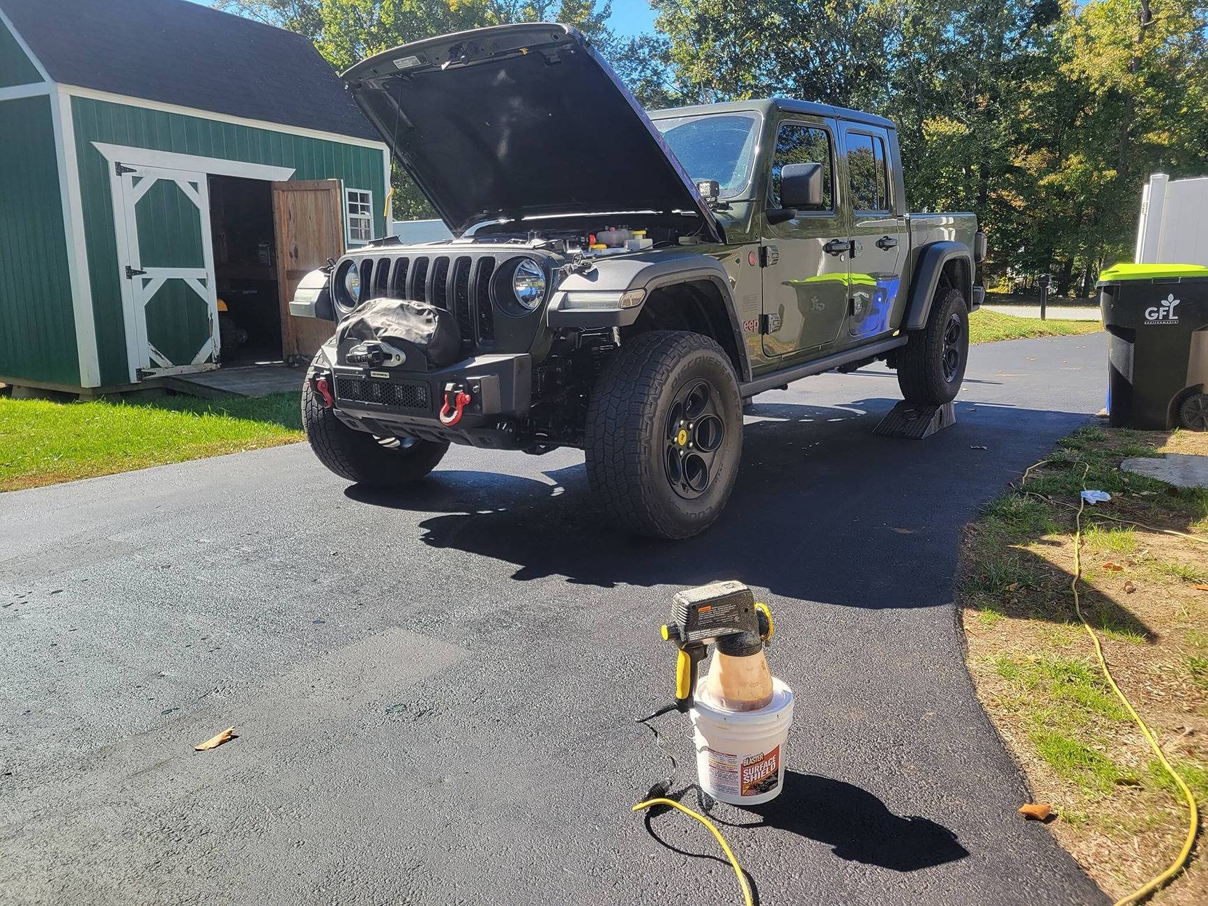

I used fluid film last year on mine. If I remember right about the engine bay, I think I just sprayed the top and inside of the frame rails, top side of the drivetrain, plus whatever hardware I could see without getting too close to electronics, engine accessories, or anything else that looked sensitive or got really hot. I also sprayed behind fenders/body voids/grille too where I could. Basically any nook or cranny where it didn't look like surface oils would cause a problem. I think I did under the hood with an aerosol can, vs the spray gun I used for the general underside.

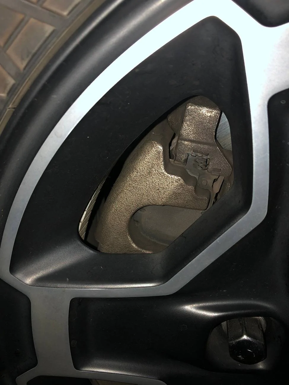

Under the hood, I use Boeshield and/or CRC HD Corrosion Inhibitor, sprayed into a cup and then applied with a small brush. I usually try to do any exposed fasteners or brackets or other areas that I think may corrode.
Another great use for the CRC HDCI is the brake calipers. Brush it on when they are new. It certainly doesn't keep them from getting dusty/dirty, but it keeps the corrosion away. This is waht my calipers look like after 3 salty New England winters:

I used to paint all my calipers as soon as I took delivery of any new vehicle with plated calipers. I tried the CRCHDCI on a whim after I used Nyalic clearcoat (which failed in about a year) on our 2017 CX-5's calipers. Now it is my go-to, and I've used it on my JT and my wife's 2022 CX-5. It requires zero prep, and it is super easy to apply. I spray it in a cup and use a nice 1/2" wide horsehair paint brush to apply a thin coat. It is easy to touch-up if needed, although I've never applied anything other than the original application on my JT.

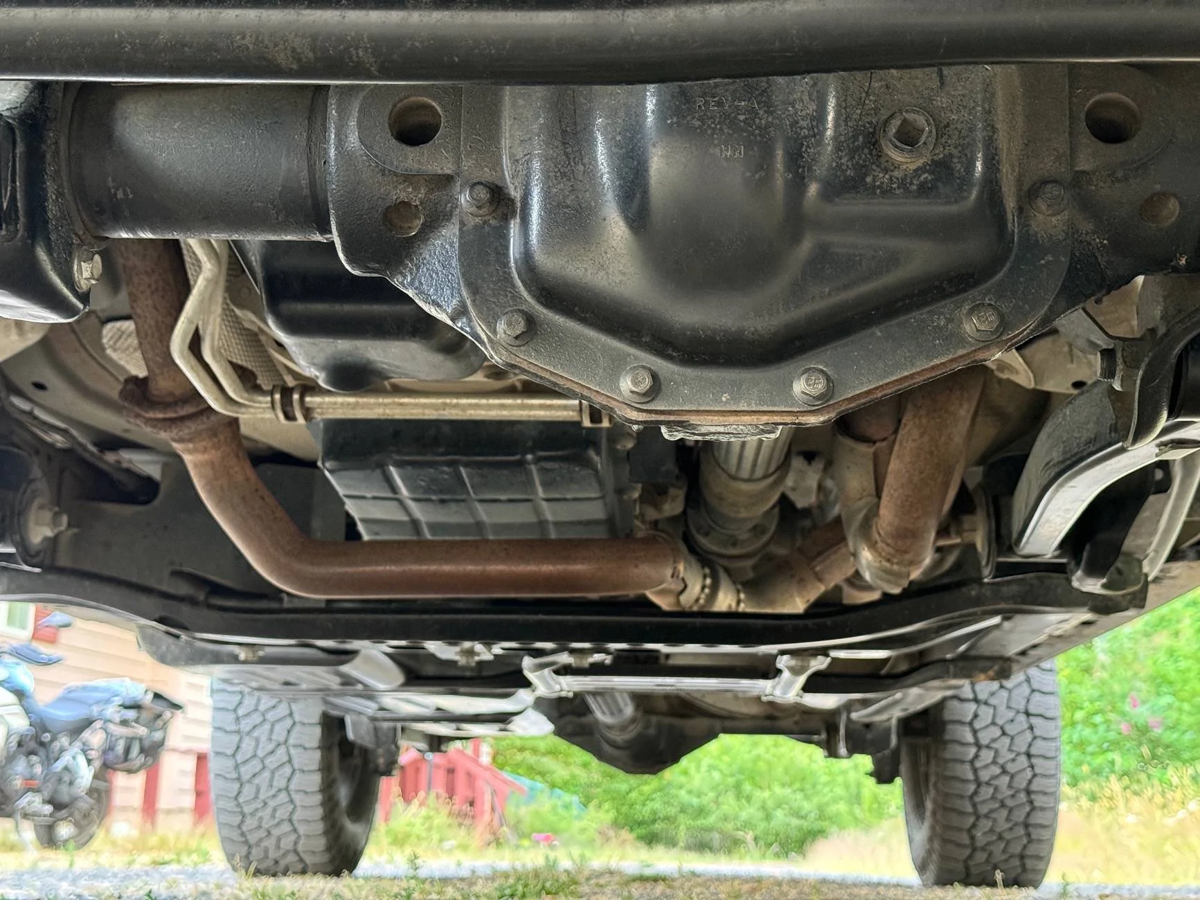

Two years and 30,000 miles. I apply a bit of lanolin coating once or twice a year and rinse off the belly here and there to keep mud from accumulating. All the roughness on the differential is just dust.
I regularly look through the frame holes and inspect the nooks and crannies for signs of corrosion and to date, nothing other than odd spots in the trailer hitch interface.
I’ve been quite impressed by how the truck has held up despite hard use. It’s absolutely been superior to my Subaru in this regard.
