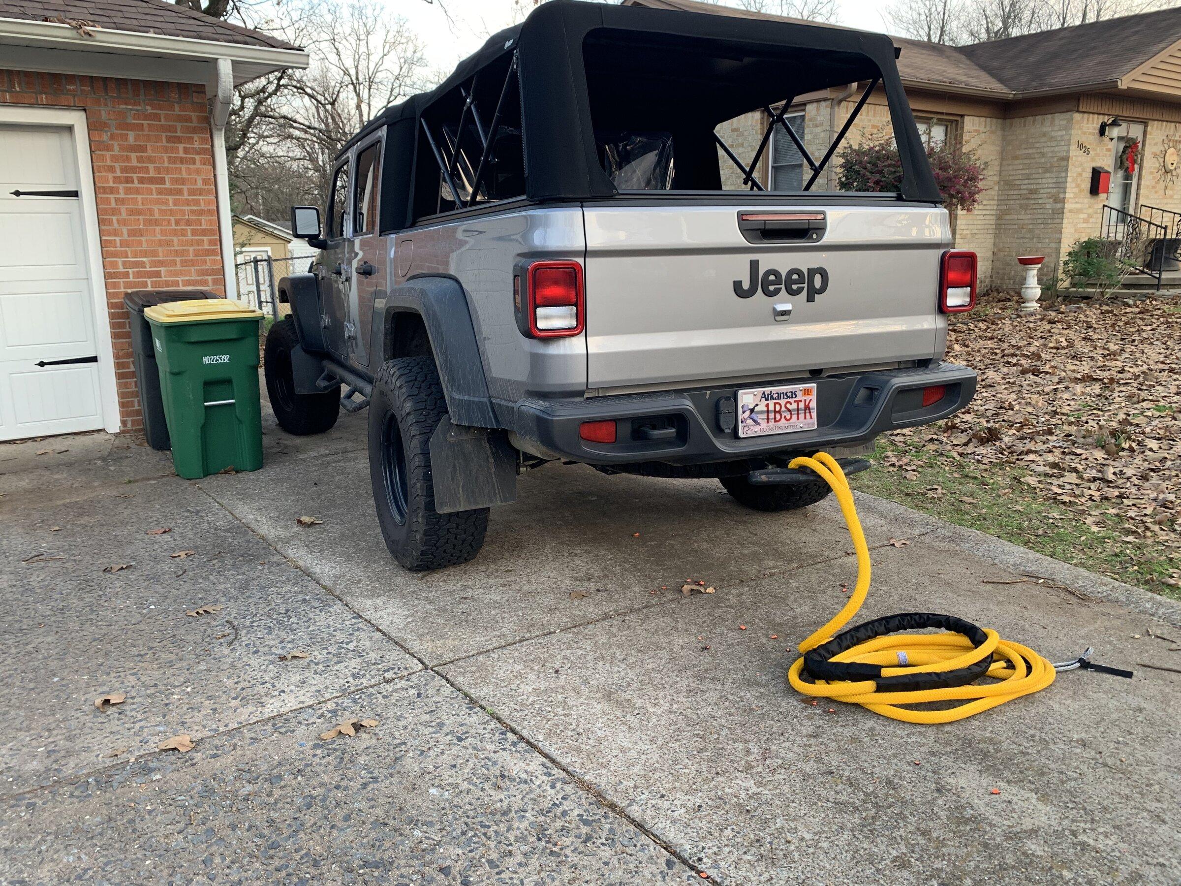

I’ve had the smittybilt step for almost 10yrs now on my FJ, it was immediately moved over to the gladiator and is great. Sliding the strap loop through the middle hole and looping it over the side hook is so fast, I never even used my shackles.
Usually just for pulling people up snowy hills and such…
I put skateboard tape on the top of it, and it makes a one step swing over into the bed.
Regarding a strap, I’ve been really looking at Matt’sRecovery Rope (a Yankum) and the toy Yellow Banana Jeep for the kid.
I’ve got a smittybilt recovery strap now, and it’s been fine.
Smittybilt 27046B Beaver Step for 2-Inch Hitch https://www.amazon.com/dp/B004K23KQ0/ref=cm_sw_r_cp_api_glt_fabc_M9S6F532Q7CMZHGM0B3G
https://mattsoffroadrecovery.com/products/matts-recovery-rope

It’s definitely one chonky rope. I like how small the strap rolls, so I’ll probably keep it full time and grab the boing rope for outings….
FWIW, I was raised recovering and towing (and logging) with logging chains, so almost anything is better than that, I promise.

Santa dun did right!
Chonky indeed, but really nice.
I’ve been begging buddies to go get stuck….
And the eye just barely fits over the beaver step, freeing up the soft shackle for the working end, saving ~$60.
Jeep Gladiator Would you recommend a tow strap or a snatch for recovery; and thoughts on hitch step? A26E43FC-99E6-4D4C-82FE-81DD6EF7958B
Ahh, just wait until you feel, or rather... do not, that first recovery pull behind you. #gamechanger
