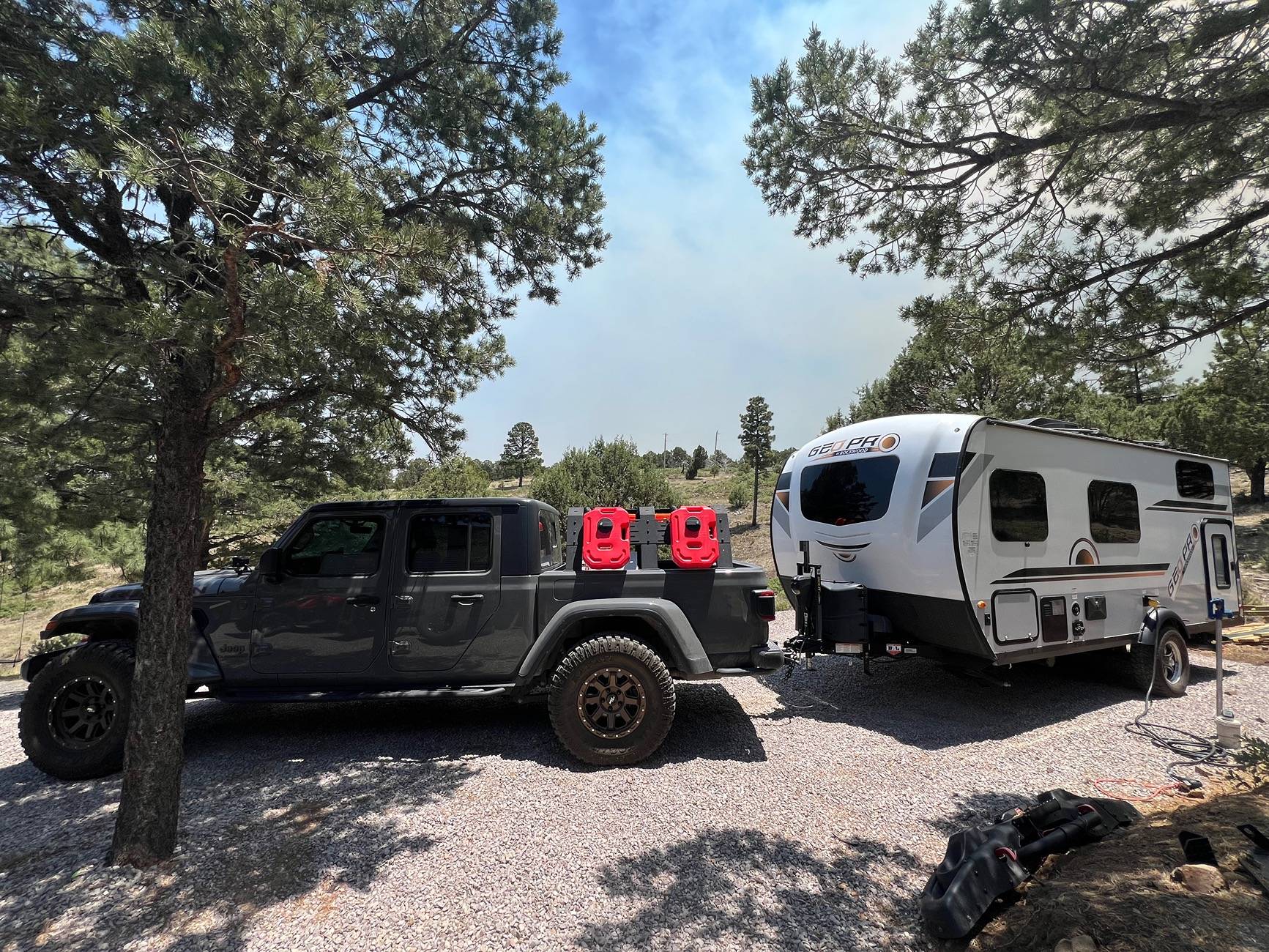

Your Gladiator will have no problem towing this TT. I have the sister to this trailer, built by Rpod but looks nearly identical. Mine is 3,800lbs dry and I estimate i’m at around 4,800lbs loaded. At this weight, I dont run a WDH but I did install air bags to help with the sag. But my rpod does have independent suspension, so it will tow more comfortably than this nobo with solid axle.
So you have the R Pod 192? Are you towing with a Mojave or another model? Looking at a 2024 R Pod 192 Beast Mode and would love any updates here. Looking to make it a full-time rig with my Mojave for around a year or so and plan on putting a lot of miles in, but just not sure if I need to be looking at something smaller.
Yes, towing a beast mode 192 with a stock Mojave(well, I added air bags to decrease the squat and installed the Mopar trailer brake controller). The independent suspension of the Beast Mode makes for a really smooth towing experience.
