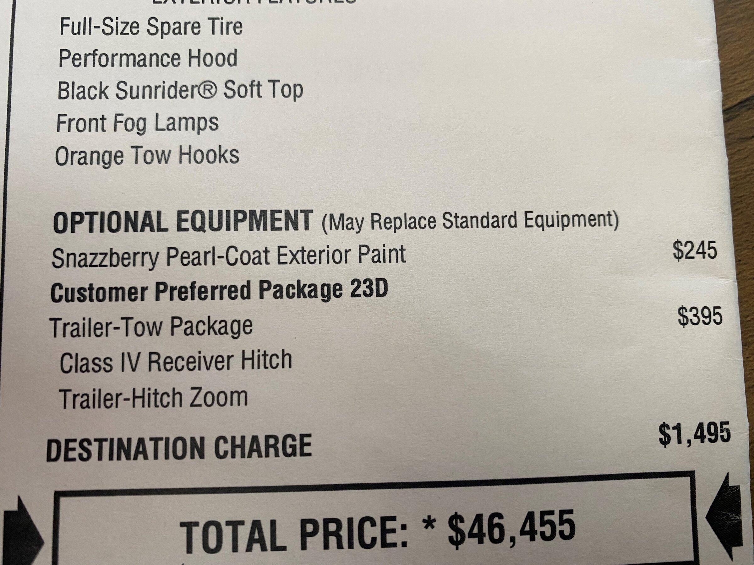

According to my Mojave sticker, it was $395 and and is the Class IV hitch and Trailer Hitch zoom:
Jeep Gladiator Tow package on a Mojave, is it worth it? sticker

Adding tow package to Mojave, what do you believe is added and/or changed? It is a fact the cooling fan is the same and the springs are not changed. Other than alternator, hitch zoom, and the class iv hitch, what do you believe added on this trim? Seriously, there isn't years of discussion in this instance for Mojave.
There are a lot of people here who believe that you should always get the factory hitch option if its offered.
I generally agree if it actually makes much of a difference. On my dad's Ridgeline it added a transmission oil cooler, a brake controller, and some additional programming to the stability control called "anti sway" or something like that.
But it appears that in a Mojave Gladiator with Aux Switches or the Cold weather group, all it gets you is a receiver hitch and zoom on the rear view camera. Not worth $500 to me.
For 2022, MSRP was upped to $545. My cost at 6% off invoice was $495
