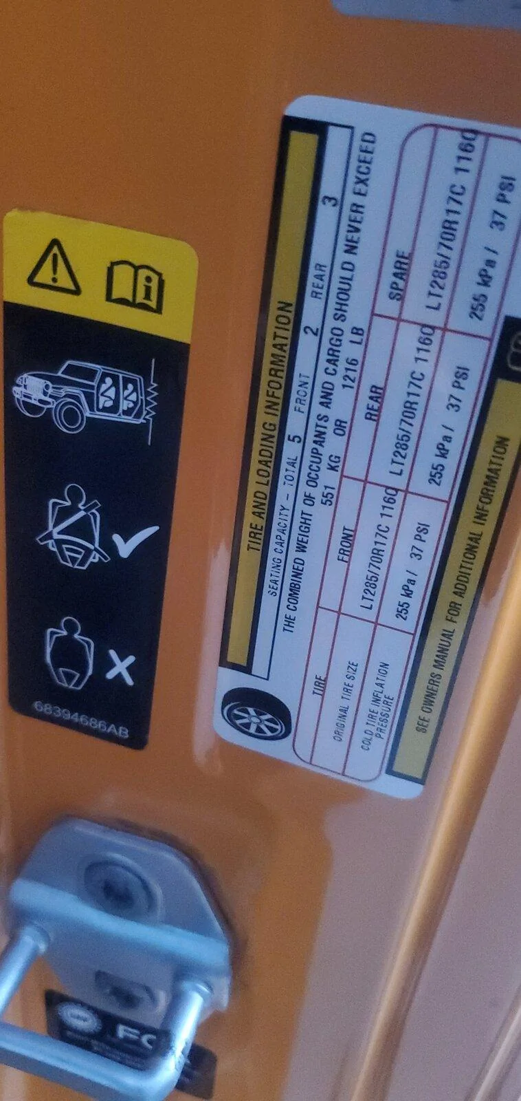

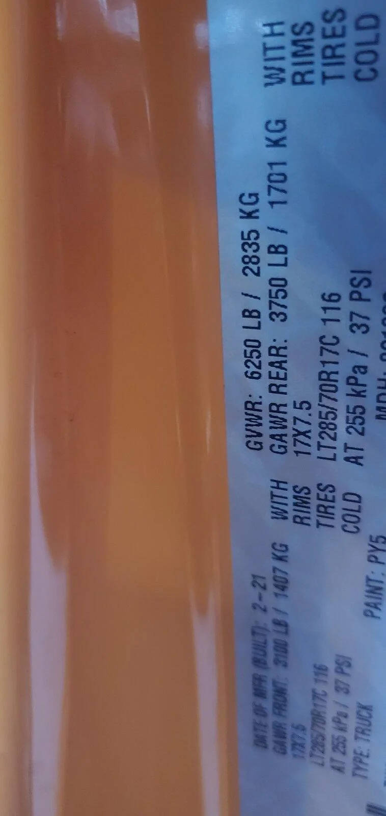

Yea this is not where if look to save money. Pretty sure you don't get the 7 pin harness without the tow package. Also the sticker in your door jam is going to dictate the amount you can legally tow, which will be lower than if you have the tow package. So if you got close to a stock setup, you still couldn't legally tow more than what that sticker dictates.
The tow rating isn't listed on the door at all on our trucks. The payload and GAVWR are listed, but tow rating and GCVWR are conspicuously absent.
Jeep Gladiator Tow package on a Mojave, is it worth it? 20211018_183211
Jeep Gladiator Tow package on a Mojave, is it worth it? 20211018_183226
