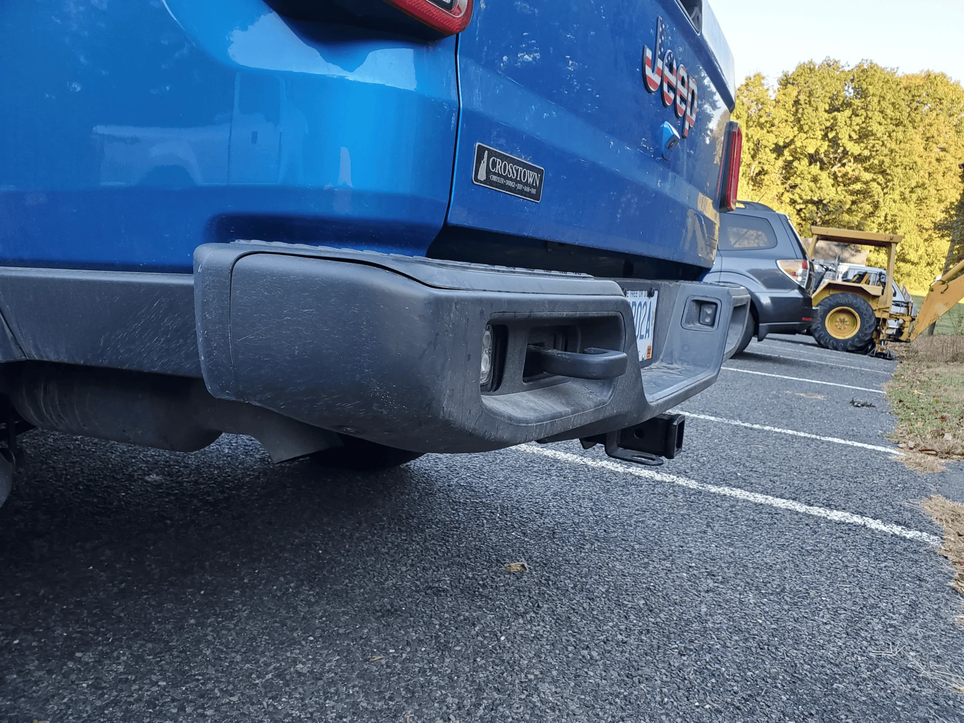

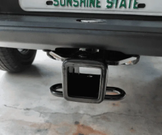

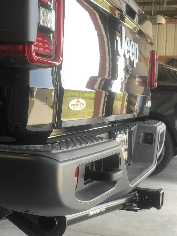

You can get one for that price, but most would argue it's not comparable to the OEM. The full frame one would be closest to the OEM, and it's ugly as hell. Looks like something U-Haul bolted on. Not even close to the factory look.
Jeep Gladiator Tow package on a Mojave, is it worth it? 1634561062247

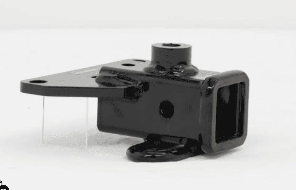

For comparison, here's the factory one from about the same angle (forgive the dirt, lol)
Jeep Gladiator Tow package on a Mojave, is it worth it? 1634561053894
Jeep Gladiator Tow package on a Mojave, is it worth it? 1634560421385
