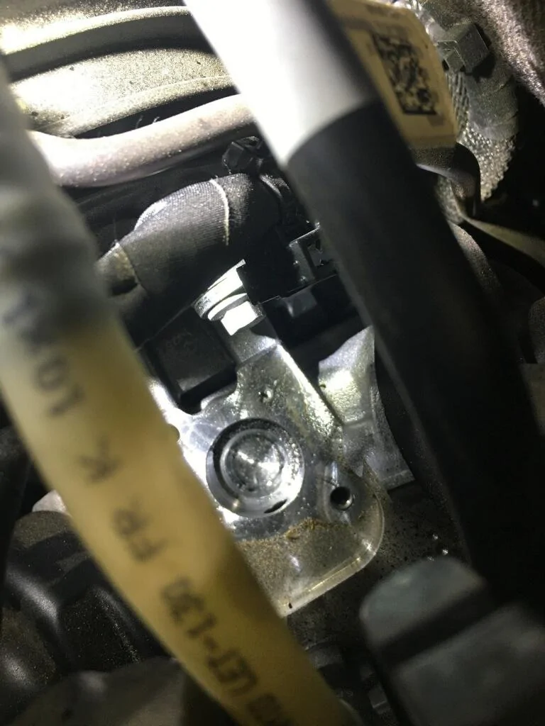

So update on the Ecodiesel.....uggggg
Just got off the phone with the dealer. According to them the injector pump failed catastrophically. They are going to be pulling the fuel tank today to make sure I didn't get a bad batch of diesel.
If I did. Need to contact insurance and place where I bought the diesel. See where that goes.
If diesel is clean. Which initial test said it was. Then the wait begins.
Parts list.
Injector pump
Fuel lines
Guessing injectors
Possible motor yet to be determined because it's not running.
Basically everything involved in the fuel system.
Current cost of parts 8,100$
Wait time as being there is not one single injector pump in the entire nation 45+ days.
Hell I could go to Italy build the pump myself and fly home by the time they had the part in hand.
Center of the circle is nothing but metal shavings.
CP4 pump failures in the Ram and Wrangler EcoDiesels are rare, but they can happen. Hopefully it was just a defect pump. In the future, run a fuel additive or biodiesel for lubricity. CP4 pumps will live a long happy life with lubrication.

I would think that jeep would have this figured out and you wouldn't have to put any additives in an oil burner
It's a fuel problem. Look for biodiesel blends as much as possible and/or run a fuel additive. I fill up at Love's truck stops as I travel from coast to coast. They list biodiesel blends on their website. B2 is all that you need.

I'm more along the lines of thinking it is the manufacturers or FCA to figure out as it is their product
It's a result of the sulfur being removed from the fuel to clean up emissions. It provided the lubrication for the fuel system. With my 2006 Duramax diesel, I added outboard engine (TCW3) oil to the fuel to lubricate the system. It was still running great when I traded it in for the Gladiator.
