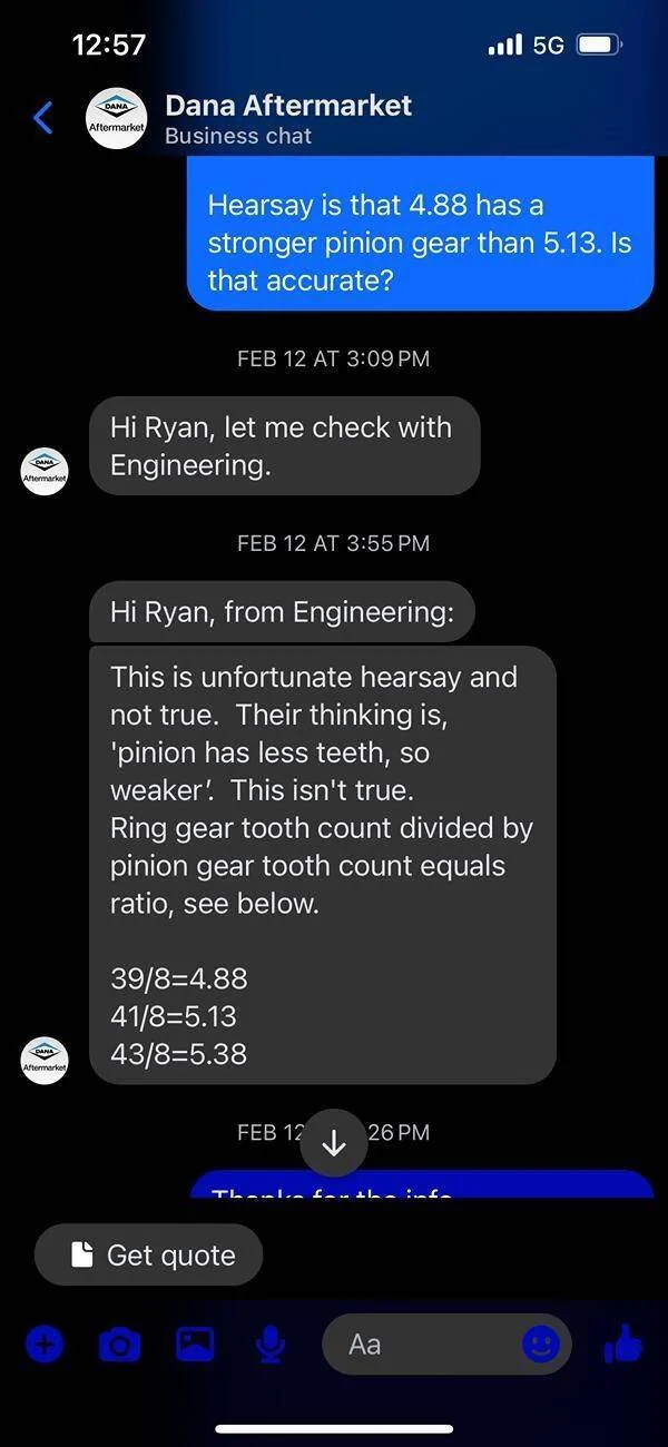

4.88 and 5.13 both have 8 teeth on the pinion. 4.88 is 39 on the ring and 8 on the pinion; 5.13 is 41 on the ring and 8 on the pinion.
With 5.13 vs 4.88, your driveshaft will spin 5.12% faster.

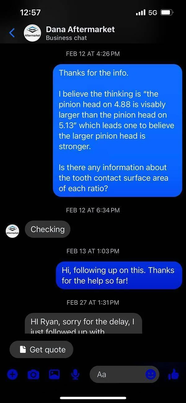

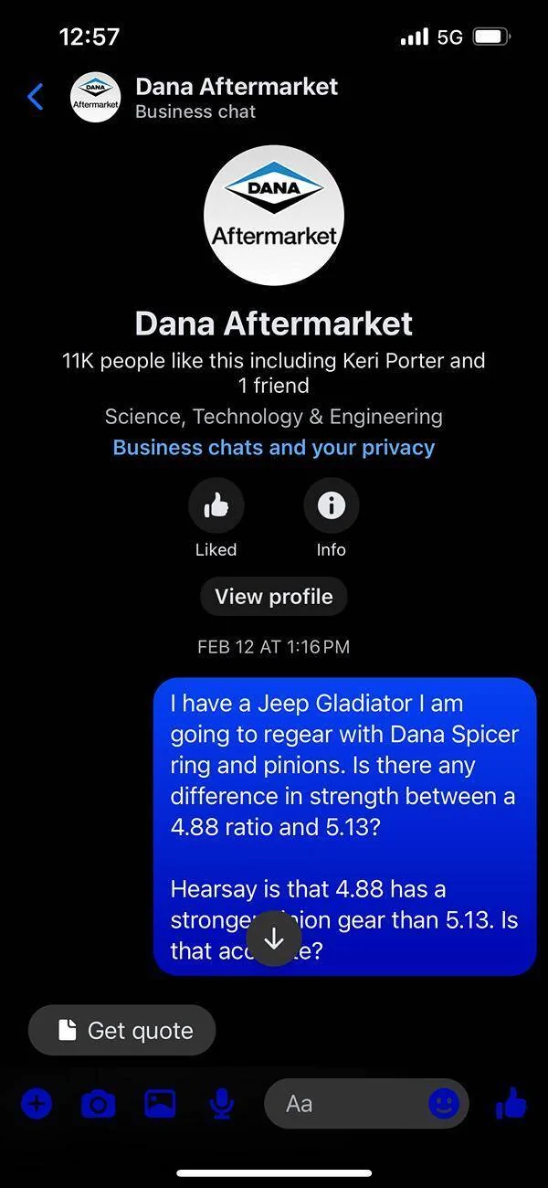

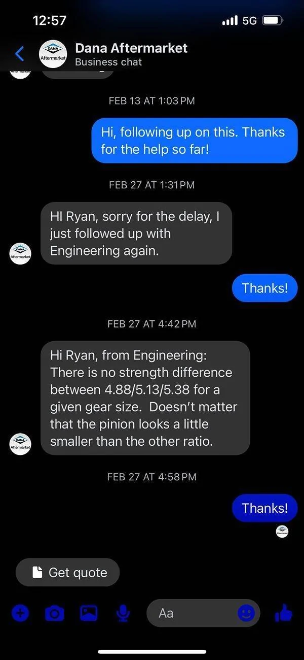

I don't believe that is correct. Dana says it's not.
Jeep Gladiator Yes to 4.88 gears! Dana #1
Jeep Gladiator Yes to 4.88 gears! Dana #2
Jeep Gladiator Yes to 4.88 gears! Dana #3
Jeep Gladiator Yes to 4.88 gears! Dana #4
