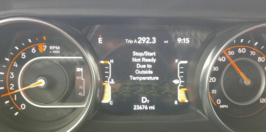

What ar e the 12 enabling characteristics?
mine is at 12.4V after sitting for a week. I have had issues with the auto stop not activating on the first ride after it has been sitting, but only after reading this thread did I make the connection that it might be battery related. Always thought I might have a door ajar or engine not warmed up… but I don’t believe I have ever seen a message on the display.
40,514
54,043
Use the up/down arrows on the left of the steering wheel and scroll to page 7 in the cluster display.

I have a 2020 Overland and did have a problem with my ESS system.
1. Symptom - Info screen states the On/Off system is not ready even after meeting all 12 enabling requirements.
What are the 12 enabling requirements? All I ever see is engine temp too low, cabin heating or cabin cooling. After that it's Not Ready or Ready and that's it. Is there anywhere I can look up these enabling requirements?
