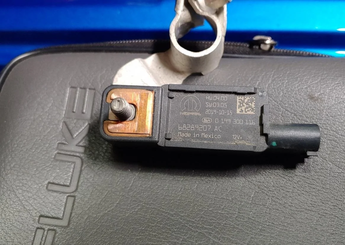

So after three times charging (rapid charge at the dealer, plus two trickle charges at home) my display now shows 12.4 after sitting on the cluster. And the stop/start is ready and working now after the last three days.
40,514
54,050
I decided to reset the IBS today. Voltage had dropped to 12.31 from 12.5 last night and that's after driving it a bit yesterday AM. Not bad, not bad at all, really - low, IMO, but the fact that it took only a short time with the battery tender to get it back to 12.7 was not only baffling, but made me think of some progress. It's staying a bit higher than it was.
Resetting the IBS is simple - you take it out of the circuit. You remove power to it and wait something like 5 to 10 minutes.
I decided while in the process, I'd clean connections, too. Can't hurt as it's 2.5 years old and it's been in all sorts of weather and salt and water and spray and cold and hot and oxides take only seconds to set in under some conditions.
It will be very interesting now to see how it behaves with a full IBS reset, cleaning and putting things back. I wanted to wait a few minutes to check the voltage again. It takes, from what I've read, 8 normal start cycles (not remote start, etc.) and driving with about 8 hours in between each cycle for the IBS to re-learn. That means it likely won't be this week! It won't get driven Wednesday, Thursday or Friday as far as I know - unless my wife has other plans.
Being a very visual person, here's the pictorial -

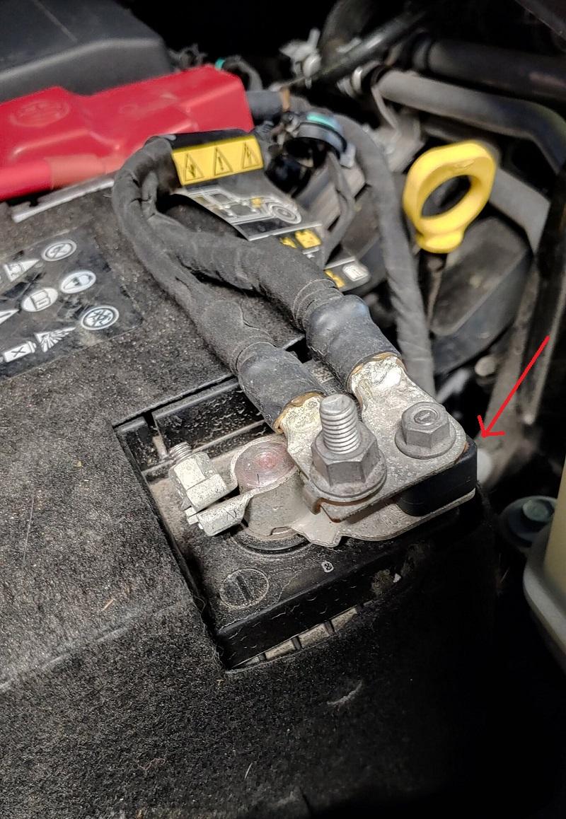

This is the target, the IBS, that device clamped to the negative post of the main battery. The other cables are for body ground and are from the aux battery, etc. The smaller cable next to the yellow dipstick handle is the network cable that connects it to the network bus and thus the PCM ->
Jeep Gladiator Your battery voltage - truck off and at rest JT-neg-bat-post-ibs
You first get a 10mm socket and take off the nut that holds the cable array to the top of the IBS - you can leave all the other stuff connected (ignore my fat black winch ground cable)
You then use that 10mm socket on the battery clamp part and the IBS lifts off.

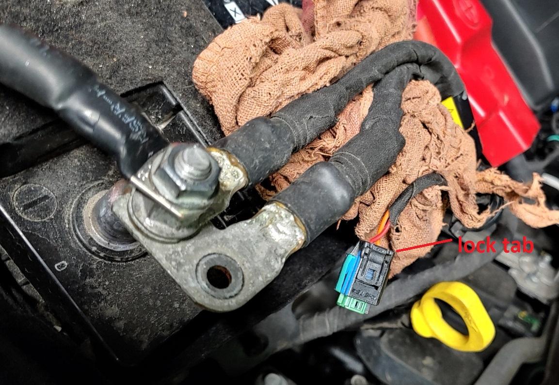

Press the lock tab and you can slip the small connector off the IBS ->
Jeep Gladiator Your battery voltage - truck off and at rest 20220329_094227_HDR

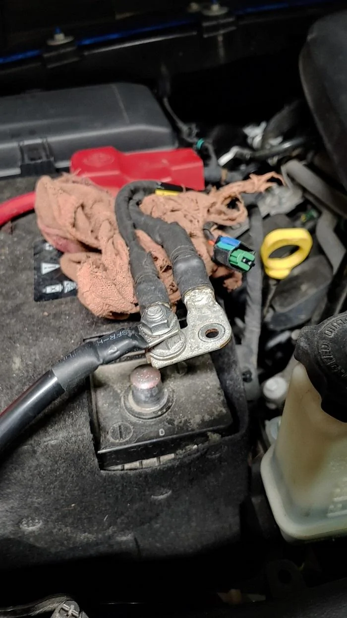

I used the only insulating thing handy in my garage - an old rag to hold the cable off the negative battery terminal while I removed the IBS by lifting it straight up off the negative terminal, then unplugging the small cable.
Jeep Gladiator Your battery voltage - truck off and at rest 20220329_094211_HDR

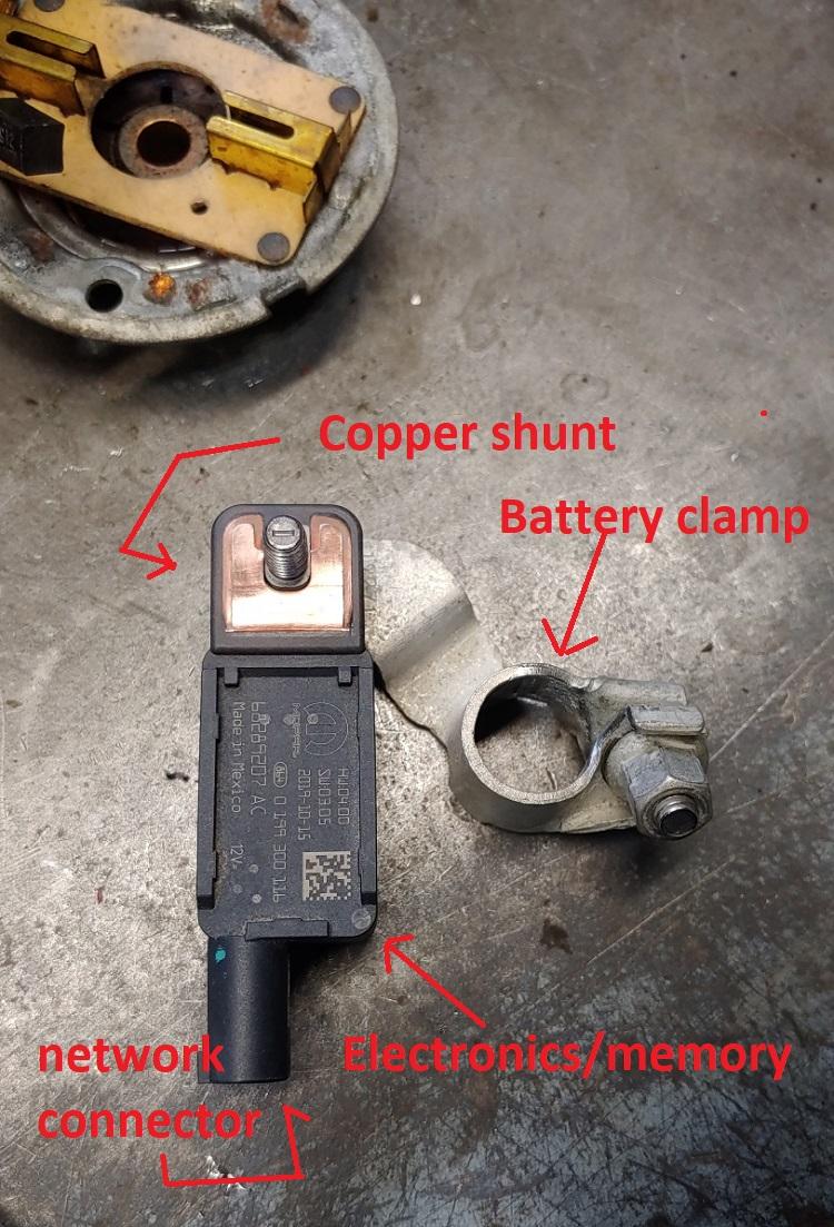

And here's the IBS in all it's glory -
Jeep Gladiator Your battery voltage - truck off and at rest 20220329_093938
I decided to leave the battery clamp on it - that other nut is ungodly tight! Didn't want to break it and I saw no real reason to remove the clamp from the IBS itself ->
Jeep Gladiator Your battery voltage - truck off and at rest 20220329_093924
I did polish up the exposed copper and clean up inside the battery clamp and used some electric connector grease on the small network cable area.
Jeep Gladiator Your battery voltage - truck off and at rest 20220329_094914
Just wondering, are you planning to charge each battery individually prior to re-connecting the IBS system?
40,514
54,050
I had thought about it - should be easy with the negative cables off the main battery.
40,514
54,050
Oddly with my little "tender" type chargers, it didn't take long at all for them to kick into maintenance mode and say each battery was fully charged.
I used the 1.5 amp on the main battery and the 800mA unit on the aux battery. The aux battery charged up first and the small charger went into maintenance mode (shut down, monitoring) and the other one continued to charge for another 45 minutes. Once they were both charged, I removed them and put the 1.5 amp charger on the aux battery - it charged for 20 minutes or so then kicked off (likely different voltage settings)
I checked the main at 12.79 volts after sitting with no charger on it for about 60 minutes
I checked the aux battery at 12.9 volts after sitting with no charger on it for about 5 minutes
I put the IBS back on and buttoned things up. Both batteries independently fully charged.
Will be interesting...................

Just take the cables off the top of the ibs. You can leave the two cables together. Keep them off the main bat neg post and connect the charger to the neg cables you lifted off the ibs
Connect to where my winch ground is in pic above.

Just checked voltage. 12.63 this time. that's 2 days of driving to work and back for a VERY short 3 minute drive. Why is why I usually walk.k. Anyway I also noticed, because you mentioned it above, that the computer stated charging level was 13.3v +/- But nowhere near the 14.something you were getting.
This was with a 8 minute warmup in the driveway though. Today I actually had 4 startups. The longest drive at lunch was about 10 minutes maybe. Probably more like 7.
Really interested in seeing how your voltages look tomorrow and through the weekend. Maybe you fixed the problem with the reset - sure hope so.
That makes sense for where to connect the negative side of the charger, but where are you putting the positive side of the charger to charge the Aux battery by itself?
If you use the positive side of the main battery, you will charge the Aux battery with the PCR in the circuit. If you put the positive of the charger on the N1 terminal, it will charge the Aux battery directly. Do we know which is preferred?
