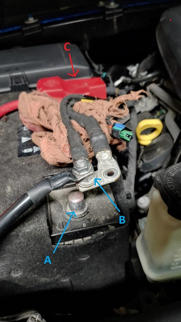

To answer your question - I put the positive of both chargers on the positive connection to the main battery.
I put the negative of the 1.5 amp charger on the main battery, I put the negative of the 800mA charger on the negative cables removed from the IBS.
The chargers acted exactly like they would with any other charging scenario. They acted independently. No reason they would not.
Image below -
my 1.5 amp smart battery tender negative was connected to A and positive to C,
my smaller 800mA charger/maintainer was connected negative to B and positive to C
~I did use a block of wood to hold the negative cable higher, more securely away from the main battery negative post.~
I posted the voltages after charging in a post above.
