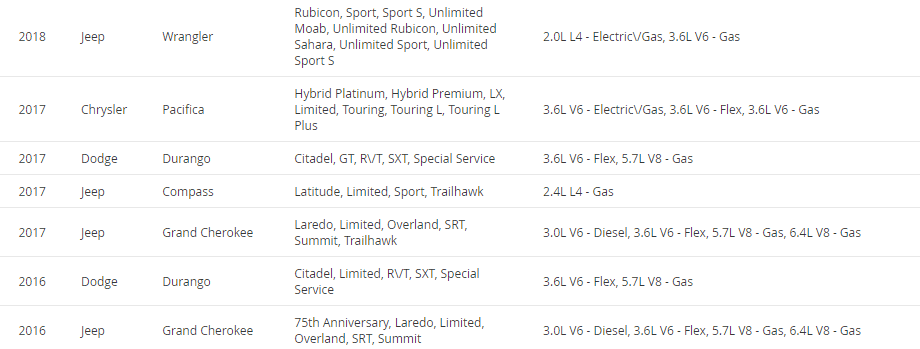

This system is not new to the JL/JT, it's been in use since MY 2016. Here's a partial list that show's when it started being used on various models and I think it's still in use in these models. FCA must be satisfied that it functions as expected.

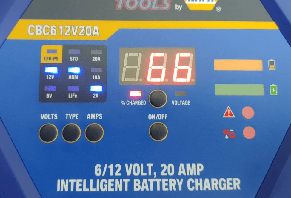

Drove mine around quite a bit today. Drove it Saturday night. And yet when I connect a charger to the main battery 1 hour after getting back from driving all over east Des Moines and home on the interstate - yes, that says it's 66%. After driving!
It went up to 99% fairly quickly (I upped it to 10 amps) but it's been sitting there in the final stages of charging (at 99%) for 2 hours.
