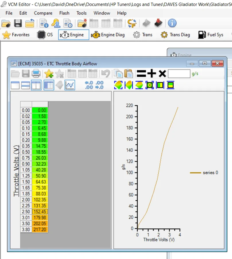

There is an option in the setup to theoretically calculate VE instead of using the MAP sensor. Jeep sets it up from the factory to do this for most of the load range. VE is directly affected at Altitude as it significantly changes manifold pressure.
I have enabled real MAP sensing and VE, and the fueling needed with it.

Your missing the fact that jeep does not measure map until 98kpa in your factory tune. I have seen aftermarket tunes that raise that number even. Thus absolute pressure in VE is not done based on sensor data but calculated airflow through the throttle body

Not even that, that would be more ideal. It is calculating based off an array that tells the system when the throttle body is opened by a certain voltage, this is how much air it is capable of delivering at a given RPM.

Volumetric efficiency calculation is based on available intake air VS power level and load. Most tables have their axis stop at 102kpa naturally aspirated.
Many supercharger companies if not all, change that table I posted, including me. It allows you to trick the engine into thinking there is more capacity to the engine to be had at a given throttle position, as the internal code has airflow limits based on engine size. These are not adjustable. The problem is then VE is way off. At WOT it uses a strategy closer to Alpha-N fueling so no biggie and why most superchargers for this engine are setup to work when the throttle is floored. The problem is part throttle suffers as VE fueling, load, spark, and cam timing are all based on a false airflow now and the claculated torque is way off. Thus the weird throttle oscillating and power surges.
