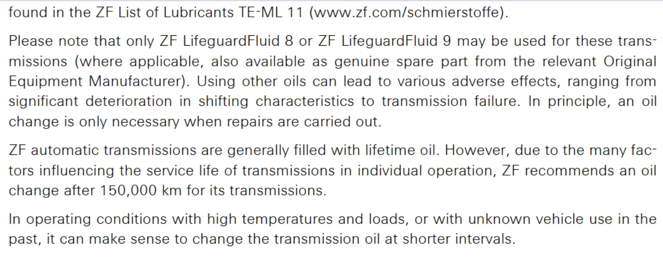

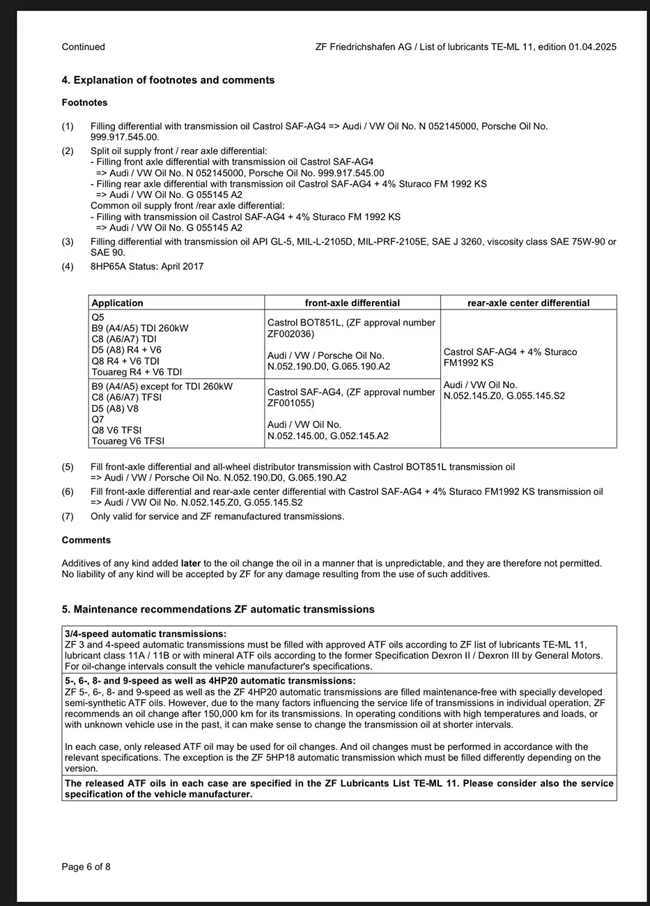

Hi guys,
I’ve been reading up previously posted threads about the service interval for the 8 speed transmission in the JT and saw a lot of people doing 60k fluid service. I know Jeep says it’s lifetime and other people say to do it at 60k. Since I’ve wanted to confirm I reached out to ZF and they sent me this PDF that says
“ 5-, 6-, 8- and 9-speed as well as 4HP20 automatic transmissions:
ZF 5-, 6-, 8- and 9-speed as well as the ZF 4HP20 automatic transmissions are filled maintenance-free with specially developed
semi-synthetic ATF oils. However, due to the many factors influencing the service life of transmissions in individual operation, ZF
recommends an oil change after 150,000 km for its transmissions. In operating conditions with high temperatures and loads, or
with unknown vehicle use in the past, it can make sense to change the transmission oil at shorter intervals.
In each case, only released ATF oil may be used for oil changes. And oil changes must be performed in accordance with the
relevant specifications. The exception is the ZF 5HP18 automatic transmission which must be filled differently depending on the
version.”
Just an FYI.

The 850RE transmission (paired with the 3.6L V6) is manufactured by Stellantis under license from ZF. They designed the transmission, and have their service recommendations, but that is all. Jeep provides the warranty, not ZF. Jeep says it is a lifetime fill and needs no service, under normal operating conditions.
You have to evaluate your situation and decide if your use case is one that would require the transmission to be serviced. For the 'average' JT owner, there appears to be no need for it.

I agree with Mr._Bill's statement in principle.
Please see my post on ATF Equivalents. It covers ZF docs, the owner's manual, and other key considerations. To start, see doc #s 1 and 2, and 5 thru 7.
Also see the section called Service Interval, under "Key Considerations on ATF for Automatic Transmission", in the same post.
Keep in mind that many members of and visitors to this forum take their vehicles off-road and, by necessity, do a pan drop / transmission service early. A daily driver, or a vehicle that is never taken off-road, falls into a different transmission service category.

The actual number from ZF is 93,000 miles, not 90,000km.
It's 150,000 km.
This is straight from ZF, not Jeep
Look at the "in principal" sentence. To me that means if you are an ordinary Joe and don't tow and don't go off-road, you can go 100,000 miles, but "due to many factors" -that's the ONLY reason they say do it sooner. That part is important to understand - ZF builds them and specs the fluid to last a lifetime, but because they can't control all conditions - "due to many factors" -
It's reading comprehension - understand what is actually being said or meant, not just looking at the words. Look at the intent of those words.
