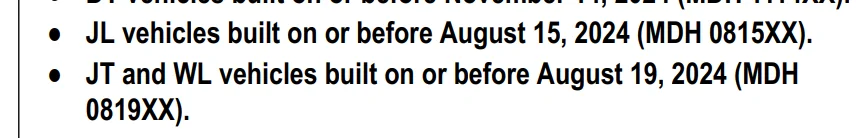

Many over in the JL Forum, are also using 0W30.
That's where I found one of the cam failures using 5w30 - there are others on other Jeep forums.
I'm just glad to see my 25 was made after the cut-off date on that TSB. There should be no issues with it IF they really HAVE resolved the materials issue with the cams. (Even though we've never had a cam issue on the 5 upgrade engines we've owned)
