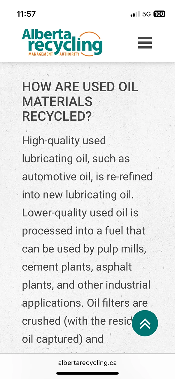

It doesn’t say it turns back into the exact same oil used before. A new product doesn’t mean the same product.
I think this one does. Here’s another recycle management companyin Alberta that has this to say:
Jeep Gladiator 0W-40 in PUG 3.6 IMG_4809
I guess there’s “high quality” used oil and “low quality” used oil. The “high quality” stuff they make new again for the auto industry had me send them an email asking about it.
….waiting for their reply.
That says the same thing as the one before. I think you are connecting dots that they are intentionally being vague enough not to connect.
