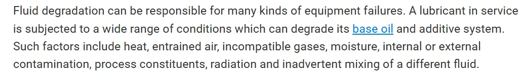

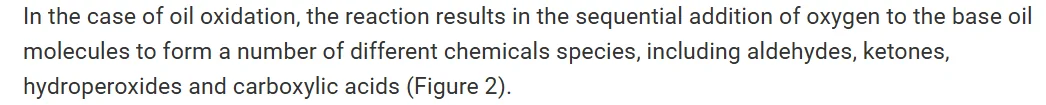

And yet I have posted article bits here that directly contradict what you say - yes, the molecular structure can break down. It absolutely can. The chains can be modified by heat and pressure, oxidizing the base oil, changing the structure, reducing viscosity.
Note the words BASE OIL-
Jeep Gladiator 0W-40 in PUG 3.6 1754058588079-03
Note these words -
BASE OIL MOLECULES.
Even the videos explain that various grades of base oil resist breakdown better than others. Viscosity index improvers help negate the breakdown of the viscosity of the base oil. PAOs resist this breakdown better.
Videos by The Motor Oil Geek where he shows the base oil breaking down by shear forces. Heat is also a cause of base oil breakdown.
You can't say it will never break down as it can and will depending on the conditions and I'm not talking about burning.

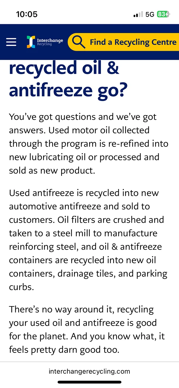

Here is one company in Canada that does it. Mind blowing isn’t it.
LOL = no, I know oil is RECYCLED, but it's not just filtered because the BASE STOCK can and often IS broken down. It must be re-refined and the molecules restructured to become any good again.
Did you read what I posted about it breaking down?
The recycling into "new lubricating oil" is often NOT engine oil, but is lighter oils for lubricating hinges or other things, or made into additives for tar and blacktop, or many other things oil can be used for.
But it's not filtered and given new additives and put back in your engine.
Lubricating oil can mean a lot of things. The whole molecular structure can be changed in the base oil. It must go through special processes.

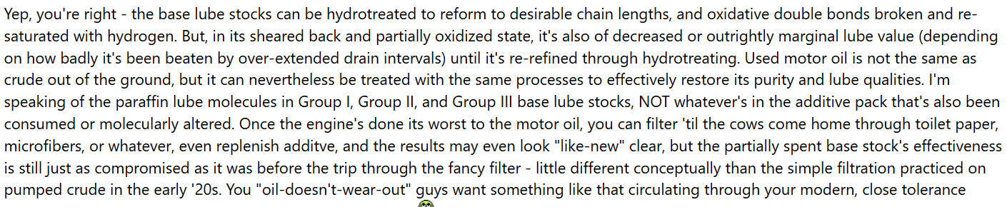

Again - take note of this - *(from BITOG)
the base lube stocks can be hydrotreated to reform to desirable chain lengths, and oxidative double bonds broken and re-saturated with hydrogen. But, in its sheared back and partially oxidized state, it's also of decreased or outrightly marginal lube value (depending on how badly it's been beaten by over-extended drain intervals) until it's re-refined through hydrotreating. Used motor oil is not the same as crude out of the ground, but it can nevertheless be treated with the same processes to effectively restore its purity and lube qualities. I'm speaking of the paraffin lube molecules in Group I, Group II, and Group III base lube stocks
It has to basically be re-refined. Its value as an oil or lube is marginal at best unless rebuilt again - literally, the molecular structure re-formed. A lot of it goes into road making materials, tar products, and home heating oil.

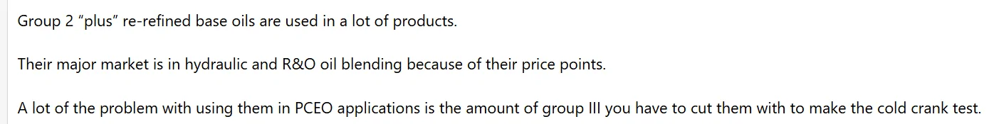

The bulk of what's recycled isn't coming back as engine oil, at least in the states.
the percentage of used engine oil that is re-refined and reused as engine oil is relatively low, estimated at around 10-15%
In Europe it's higher due to their strict standards over there, but it still is re-refined, not just filtered. They are basically taking junk oil and making oil out of it.
