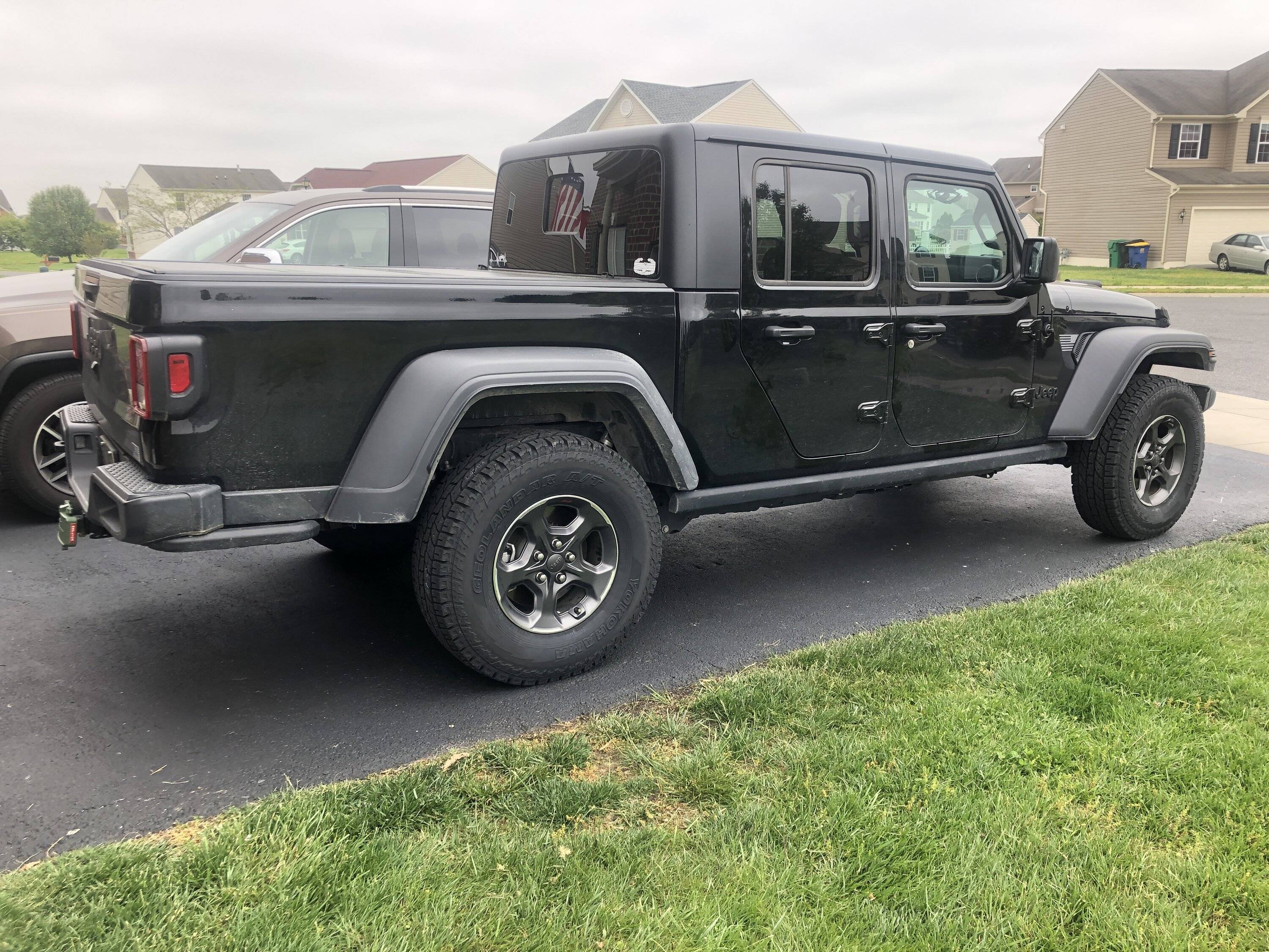

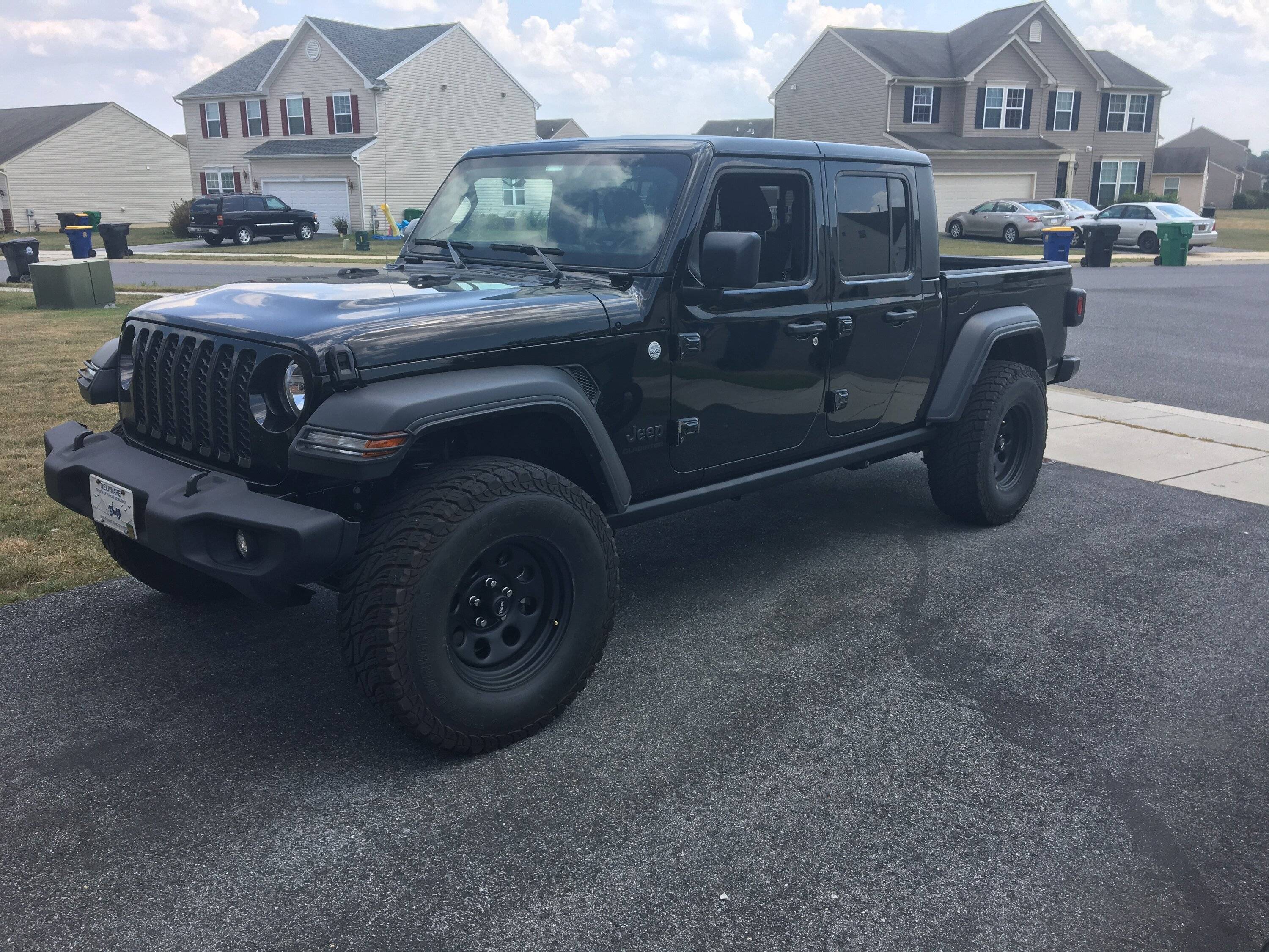

Ill see if I can find the picture but when i just got my Jt i had a 1.5in front / 0.75in rear with 35s.
Wasn’t the look for me. I liked it more with 285’s personally with that lift. And now I have a 2in front/rear with 255’s and its great for towing.
Plus remember you loose power / towing / hauling with big a$$ tires. Which may not be worth it for a road warrior or mall crawler build.
35s
Jeep Gladiator 1.5" FRONT AND 0.75" REAR LEVELING IMG_4874

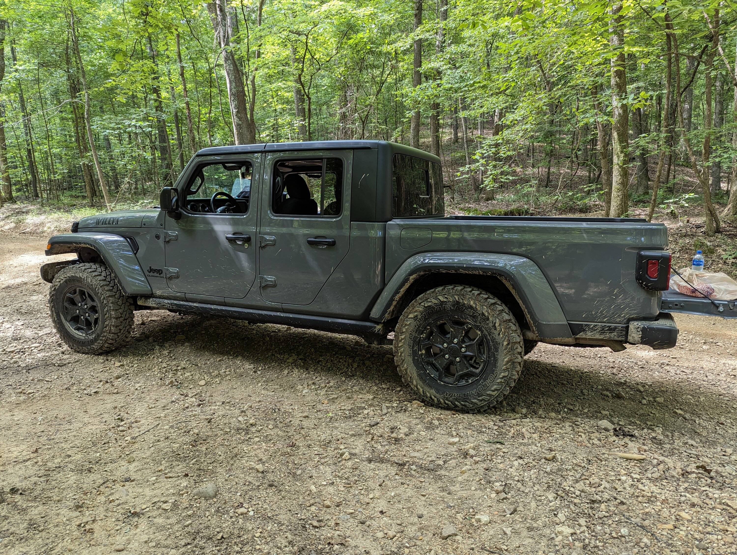

285s
Jeep Gladiator 1.5" FRONT AND 0.75" REAR LEVELING IMG_2039

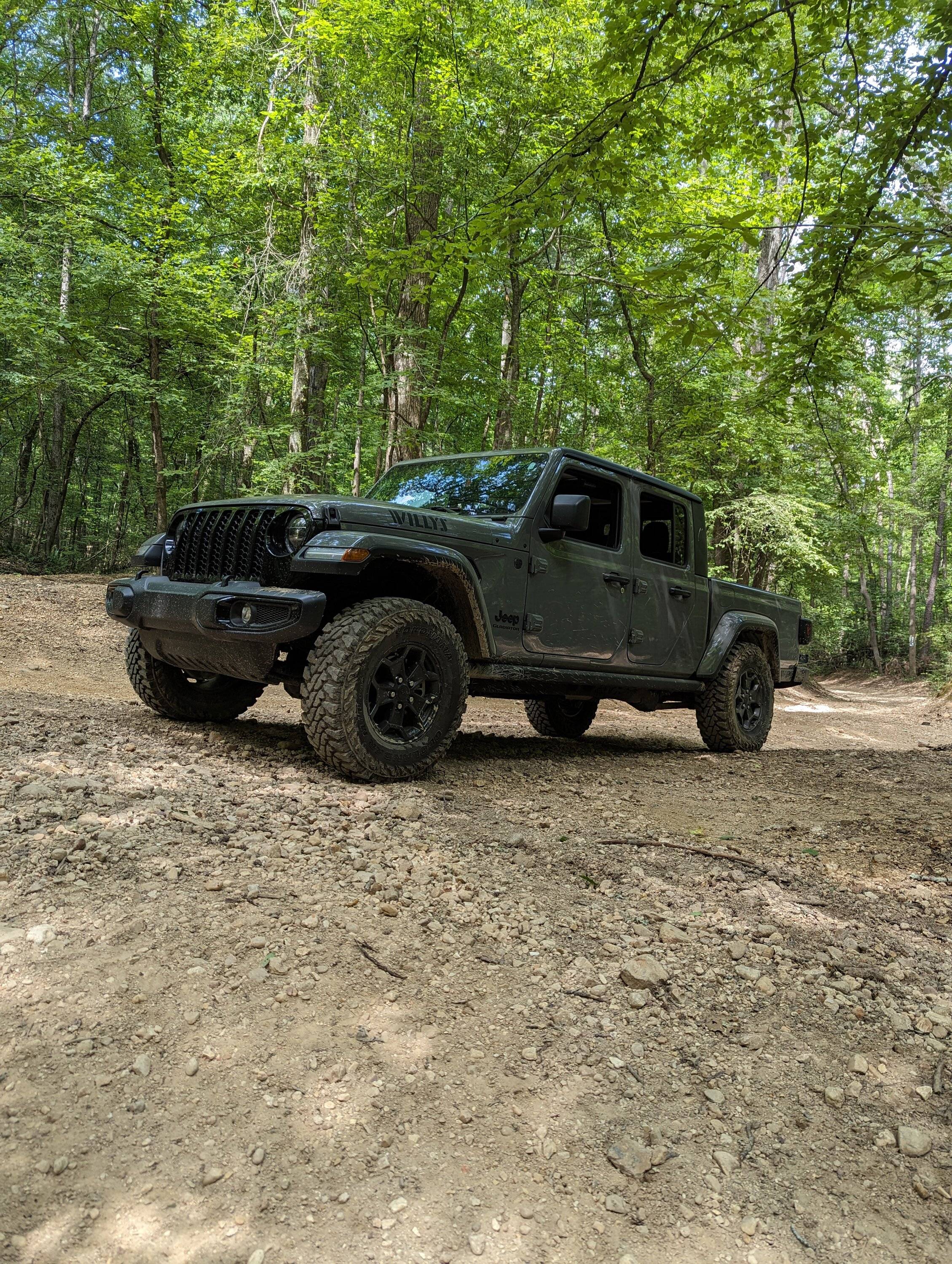

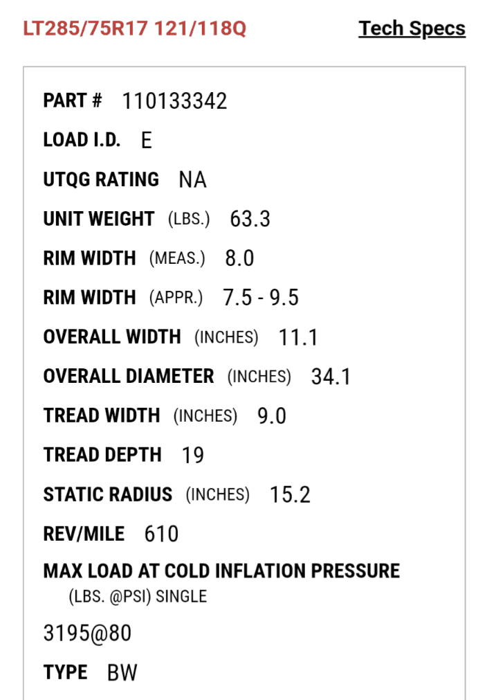

You may be okay. My current setup on the Willy's is 1.5 in the front, .75 in the rear.
34" Geolandar tires on stock rim. I'll include tire specs and Jeep pic for you to compare.
Jeep Gladiator 1.5" FRONT AND 0.75" REAR LEVELING Screenshot_20230809-104919
Jeep Gladiator 1.5" FRONT AND 0.75" REAR LEVELING PXL_20230708_154907897
Jeep Gladiator 1.5" FRONT AND 0.75" REAR LEVELING PXL_20230708_154829357
