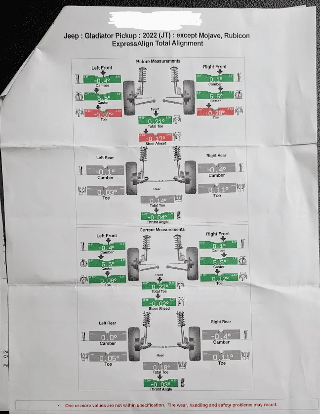

I have a 21 willys sport. I added springs and shocks from a 22 or 23 Rubicon that had about 500 miles on them. I also added the 1.5" leveling kit in the front, ..75" spacer in the rear, and Mopar longer LCAs up front. No alignment or recentering of the steering wheel at all needed. Rides better than stock.

Oddly enough I expected my steering wheel to be off center as well. I installed the Terraflex 1.5 spacers on my 2023 Gladiator Max Tow three days ago. Upon driving after the steering wheel was still centered, it drove without pulling in either direction and no drift on interstate while hands off the wheel. Is that an oddity or did I just get lucky?
