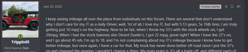

and if the speedo is not re-calibrated that avg number on the dash is wrong also.
Did you recalibrate your system with the new tire size?
Is your speedometer recalibrated for 37s?
Lol OP def does not have his ecu recalibrated for tires or gearing.
In terms of the original post, I think we need to know if OP's tires are calibrated with the ECU or not...
I would question too if OP calibrated for both the tires and the gears.
OP needs to report back if his ECU was calibrated for the gears and tires.
I would double check that your tire size is calibrated properly and that the gearing is set right in the computer.
Still didnt answer if it was re-calibrated.
@Trippin01, has it been properly recalibrated? I mean at a minimum, it's important to know for anyone reading this thread later. Answering it could also lead to you correcting an error! Win-win.

This is his last line in the original post. "Yes, Mr. Tazer has adjusted the math for Tire size and regearing"

It's getting a new front driveline today. I will recheck the calibration, again. But here is the thing. I'm happy, no worries. Like I've stated before, even if I go from 10 mpg's to 13 mpg's, does that really help? Honestly, I'm really not worried about it. It's pretty well dialed for trails and adventures. My DD get 35 mpg, thats why my DD is my DD. ha ha. Thanks everyone for all the comments, much appreciated, for sure. See you on the trails, I hope.

5.13, 37" tires (have had two sets) 4.5" (really more) lift. Did the trip from CA to UT for EJS. Saw 19.3 mpg on the way there mostly 65mph cruise control to 16.2 mpg with lots of wind and higher average speed on the way home.
With dialing in the right Tazer wheel size I suggest you use GPS. I used GPS on my ARB Linx but you could use any phone I'm sure there is an app. Get a long straight road and run at a few speeds. I did like 25, 45, 65. Check GPS speed, which should be bang on in a long straight line, versus the info console number. Being off just a little actually made like a 5 miles of range on a tank so being off a whole mile would probably be 20+ on a single tank.
