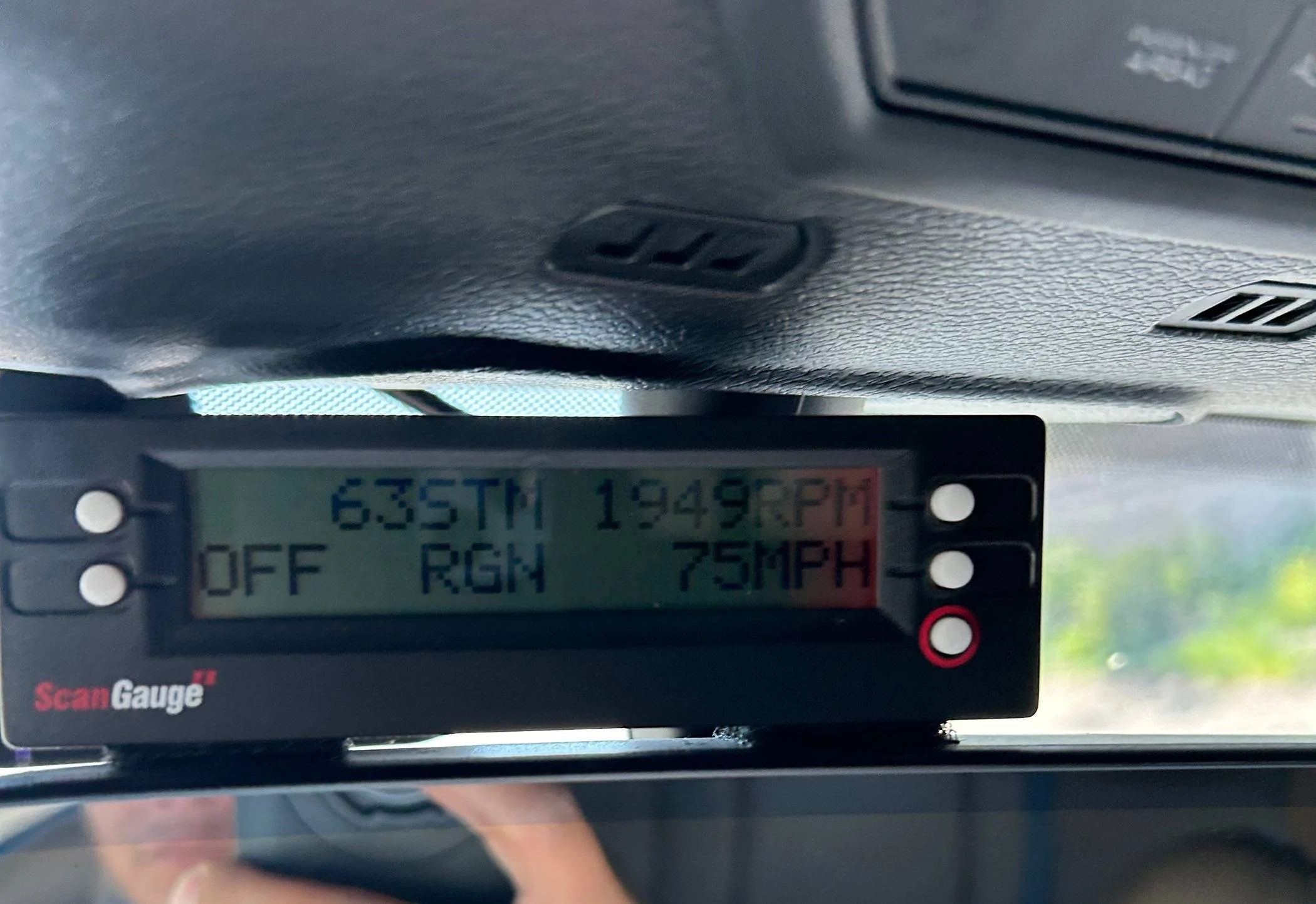

That helps, I'm at 1800 @ 75 with 37's stock gears. So there is no precision at all with the almighty calculators that much is proven and slight tire variances in diameter don't explain 200 rpm variance so Im going with the person who placed the electrical wires against the heat shielding and against the exhaust pipes that are now shorting out the the wires might be the same person who setup the speedometers.
Here's 75mph rpm at 1949. 150 higher than your.
How close is your speedometer to your gps and what 37s are on your Jeep?
this is probably my best data point against predicting my rpm when I move up to 4.88 & 42.
