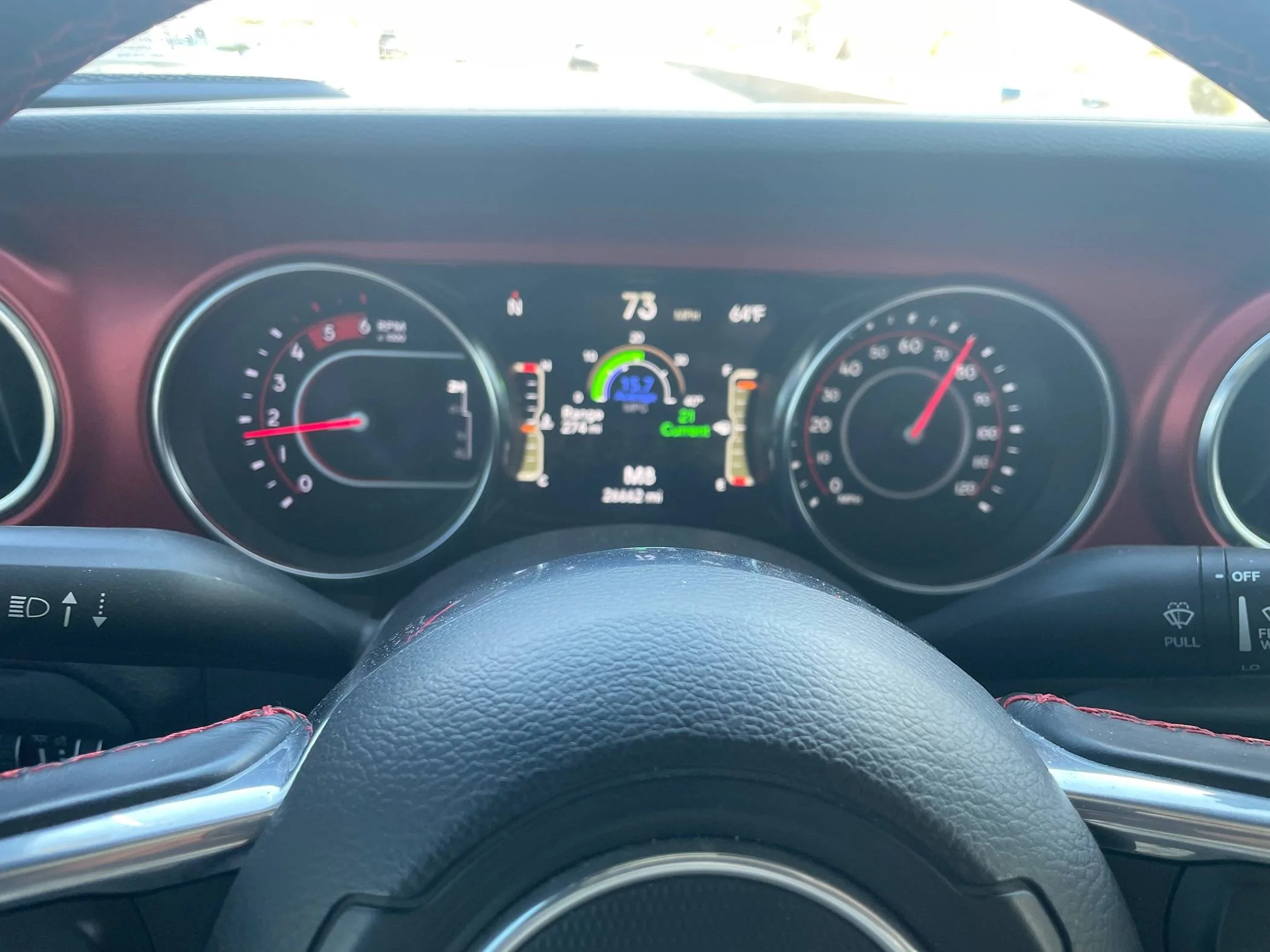

I sit at 75mph at like 1,600 RPMs and it’s the greatest thing ever with stock gears and 37’s.. for whatever that may be worth to you’d here’s a pic.
Jeep Gladiator If possible looking for Speedo/Tachometer pics of JTDiesel auto w/ 37's and 4.56 gears @ 55,65 mph IMG_3151

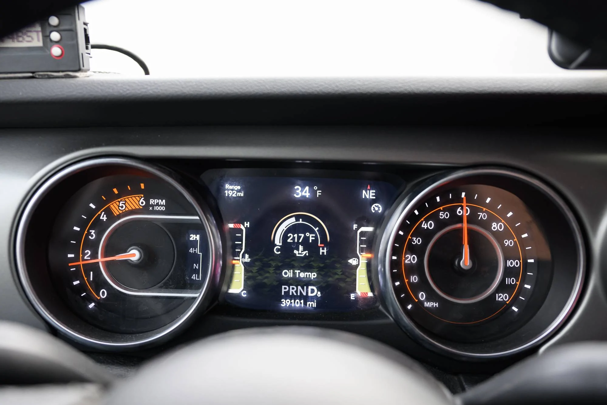

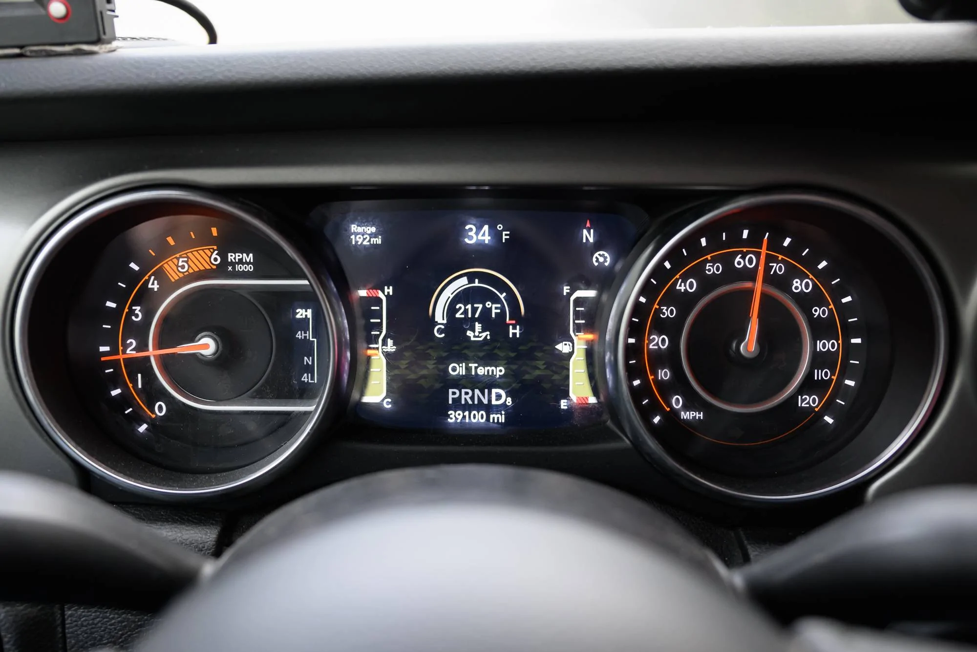

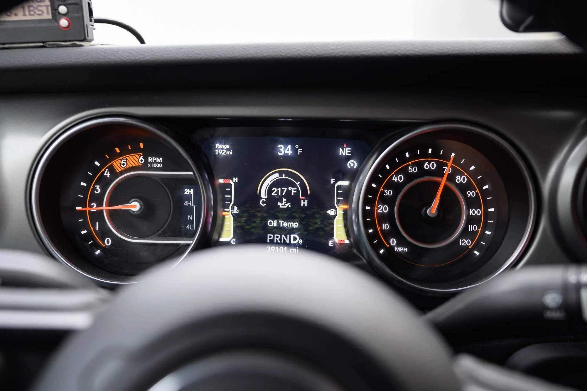

Posting these so they help others when searching the forum.
4.10's, 37" Nitto Recons.
Jeep Gladiator If possible looking for Speedo/Tachometer pics of JTDiesel auto w/ 37's and 4.56 gears @ 55,65 mph 20230212_FortFlagler_WABDR_007
Jeep Gladiator If possible looking for Speedo/Tachometer pics of JTDiesel auto w/ 37's and 4.56 gears @ 55,65 mph 20230212_FortFlagler_WABDR_005
Jeep Gladiator If possible looking for Speedo/Tachometer pics of JTDiesel auto w/ 37's and 4.56 gears @ 55,65 mph 20230212_FortFlagler_WABDR_006

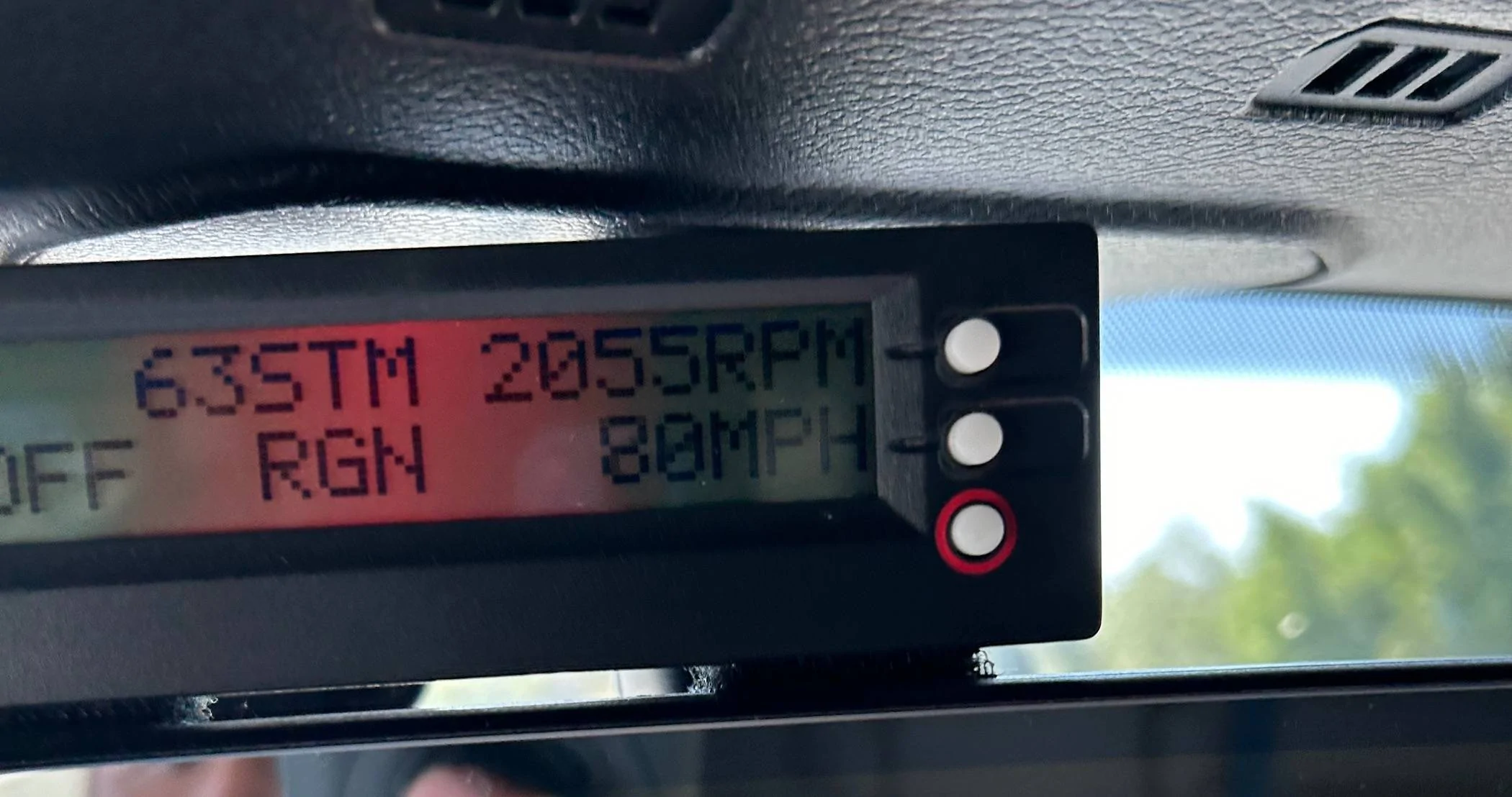

Here's the rpm at 80 mph on 37s with 4.10.
Jeep Gladiator If possible looking for Speedo/Tachometer pics of JTDiesel auto w/ 37's and 4.56 gears @ 55,65 mph IMG_0187
Thank you and this why I was asking for a picture of real world. According to the Grimm jeeper calculator it should be at 1996 rpm which isn't much difference but still isn't as accurate as real world. 4.56's it is.
