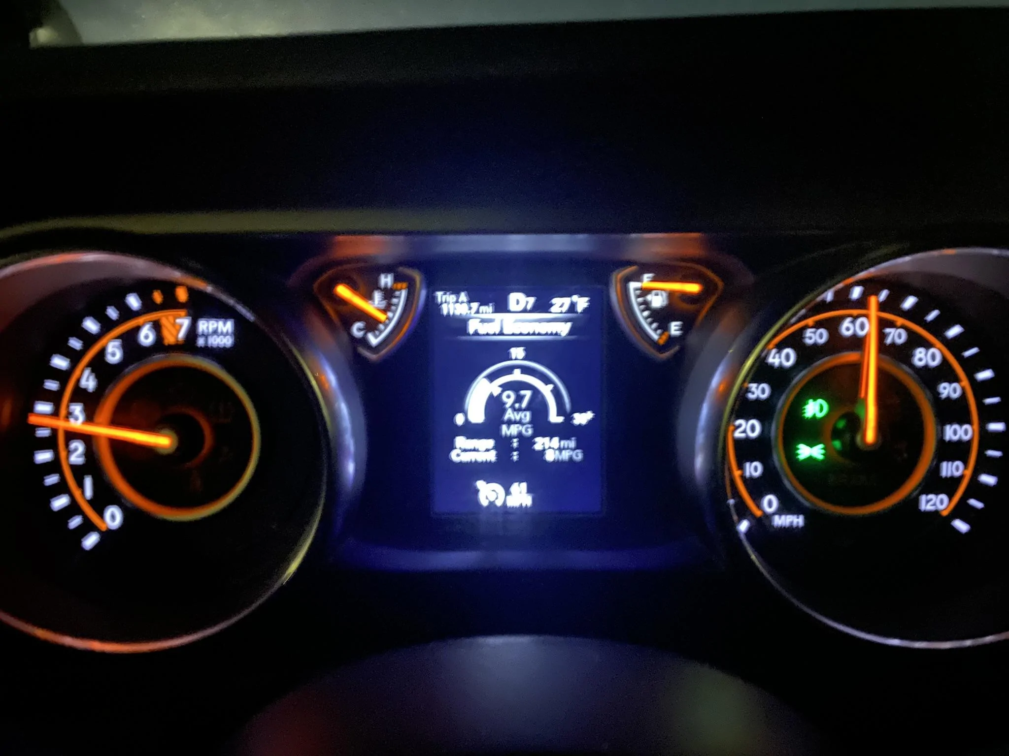

33's vs 37's mpg difference makes no sense, that truck is not calibrated.
Look at your watch, set cruise to 60. how long does it take to go from one mile marker to the next one? one minute?
I doubt it

I get 17-19 on freeway with 37’s and 4.10 gears, with the v6. 15-16 in town
Same as well. Then again I live in GA and not Colorado. Not completely flat, I do spend decent time in the N. GA mountains, but that's definitely not the Rockies...
I would question too if OP calibrated for both the tires and the gears. 10 Seems low unless you drive it like a sports car. I definitely drive different in my little 4cy altima than I do my truck.

OP needs to report back if his ECU was calibrated for the gears and tires.
Also needs to hand calc fuel economy.
Since we have the areodynamics of a brick wall, mph is the biggest hit to fuel economy.
I get 12-15 going 80-85
18 at 75
20 at 70
22 at 55-65

I keep seeing mileage all over the place from individuals on this forum. There are several that don't understand why I don't care for my JT as a daily Driver, well, 1st of all, I love my JT, but with 5.13 gears, 5x 76lb tires, I am truly getting just 10 mpg's on the highway. Now to be fair, when I throw my 33's with the stock wheels on, I get 20mpg. When I had the stock baloney skin Desert Dueler's, I got 22 mpg, great right? When I have the 37's on, and I go about 45-ish, I'm up to 18. and I'm not complaining about my JT's mileage because I know how to get better mileage, but once again, I have a car for that. My truck has never done better off road since I put the 37's on and changed the gearing. I wouldn't change a thing. My main point is, It's all a trade off, and different parts of the country require different setups. I live in the Rockies, go to MOAB and Ouray every year since I've had it, 2 now, going on 3. I hate the mileage going to the play areas, but I love the truck when I'm at the play areas. Big Bear was the deciding factor for going to the 5.13 gears. Rock gardens were painful with 37's and stock 4.10 gearing. Now that its assembled, it is a blast. I don't mind it being amazing for trails, and horrible as a DD, it's the nature of the beast with a 40 mile round trip to work. Gas cost alot, and the tires were $450 ea. last time I checked, so while I am a true believer the JT is not the ideal DD, it is a hell of a truck if you build it the way you need, and I'm sure I'm on the off-road end of the spectrum. So what ever you use your JT for, make it the best and share with everyone here what you use it for, so we can all learn. I love seeing JT's everywhere, but my favorite place to see them is in the wild, on the trails, in the Jeep Meca country and I love seeing the smiles and the side panels plastered with BOH's. So until gas is completely out of hand, I will save the bulk of my miles for trails, and the not the pavement jungles of the city. I'm going to hit 4-5 more trails this year, and I really hope to see you and your JT on those trails, because thats where the smiles are the biggest and the JT was meant to shine.
Something is not right. I get better than that on the highway with very heavy 37s, 5.13s, and pulling a 3500 lb camper.
