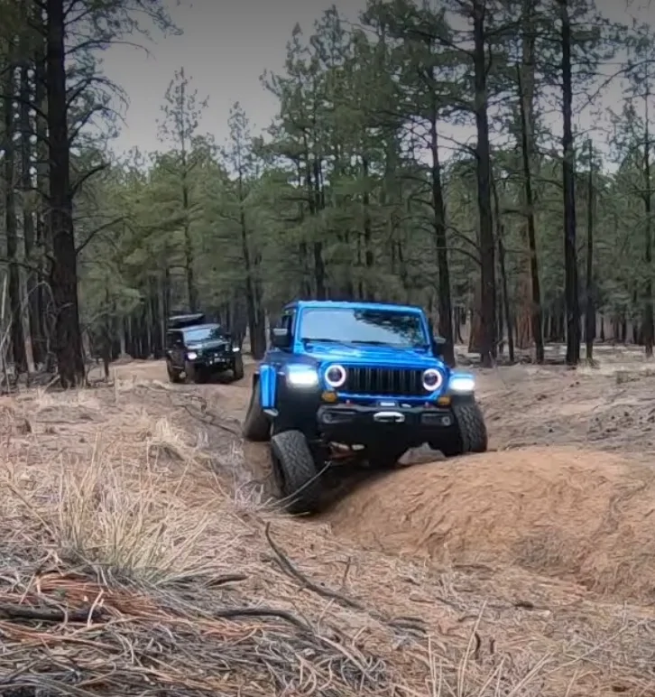

Something to consider before getting the kit is to find out the lift-kit manufacturer recommends a front drive shaft replacement (upgrade). I have the Metal Cloak 2.5 GC lift. In the instructions, they HIGLY recommend dropping another 700 bones for a smaller diameter, strong front drive shaft. After installing the lift, I quickly realized, this should not have been recommendation, but a requirement. The MC2.5GC lift flexes soo much, the MC drive shaft actually scrapes on the exhaust. The stock drive shaft would certainly bind-up if flexed that much. I would assume Clayton, or other full suspension lift kits would recommend replacing the front drive shaft as well.
Do you disco your sway bar in the front? I only ask because I recently bought there fully adjustable arms set to pair with 2 inch coils all around and reached out to them about the front drive shaft. They said they don’t think it would be necessary. I never disco the front amd am curious if that’s why they didn’t think it would be necessary.
my '25 Gladdy Rubicon has the SwayBar Disconnect system. When used, the front really flexes out.
