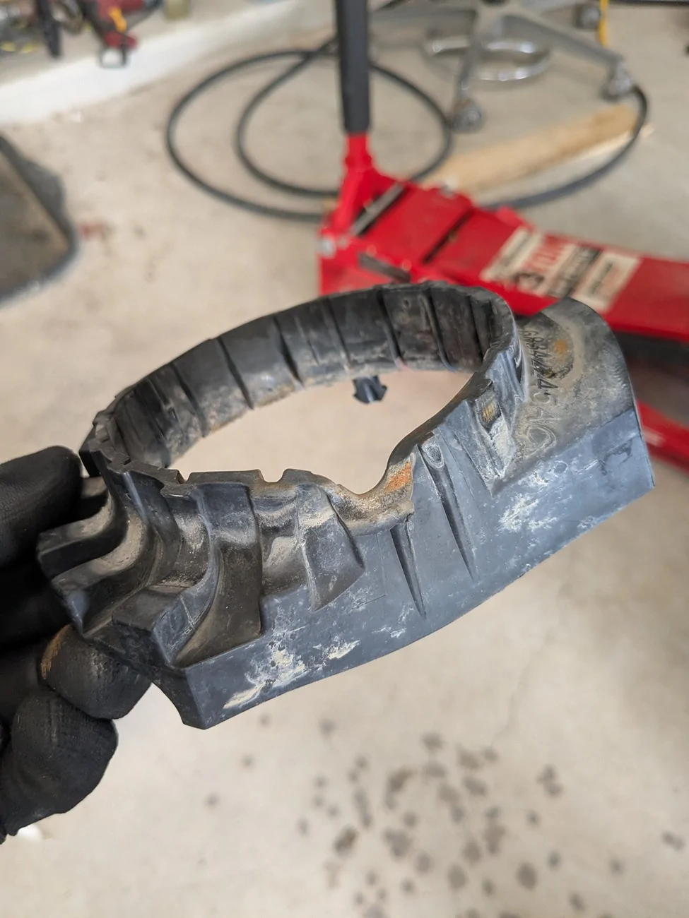

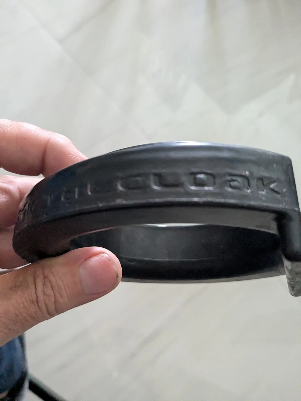

I would look at the lower spring perch, they tend to be crushed at 50k+ miles, so with yours double that, they're toast. Clayton, Metalcloak, Teraflex sell them. A regear for 37's, optional for 35's but you'll feel a little sluggish off the line.

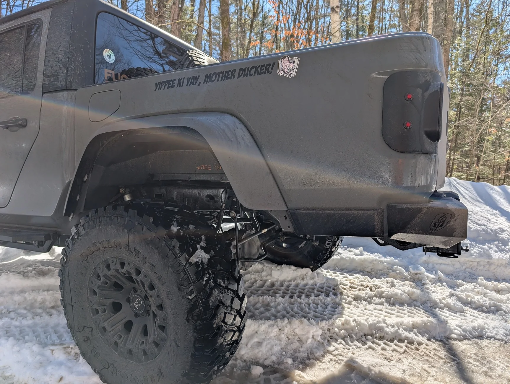

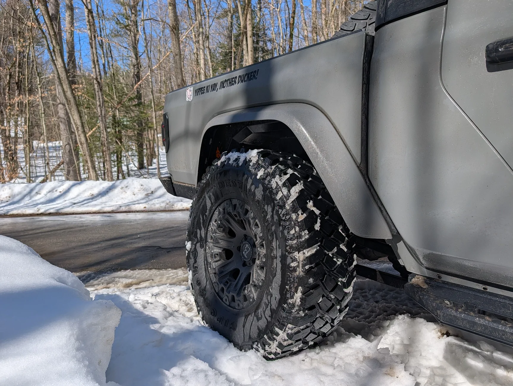

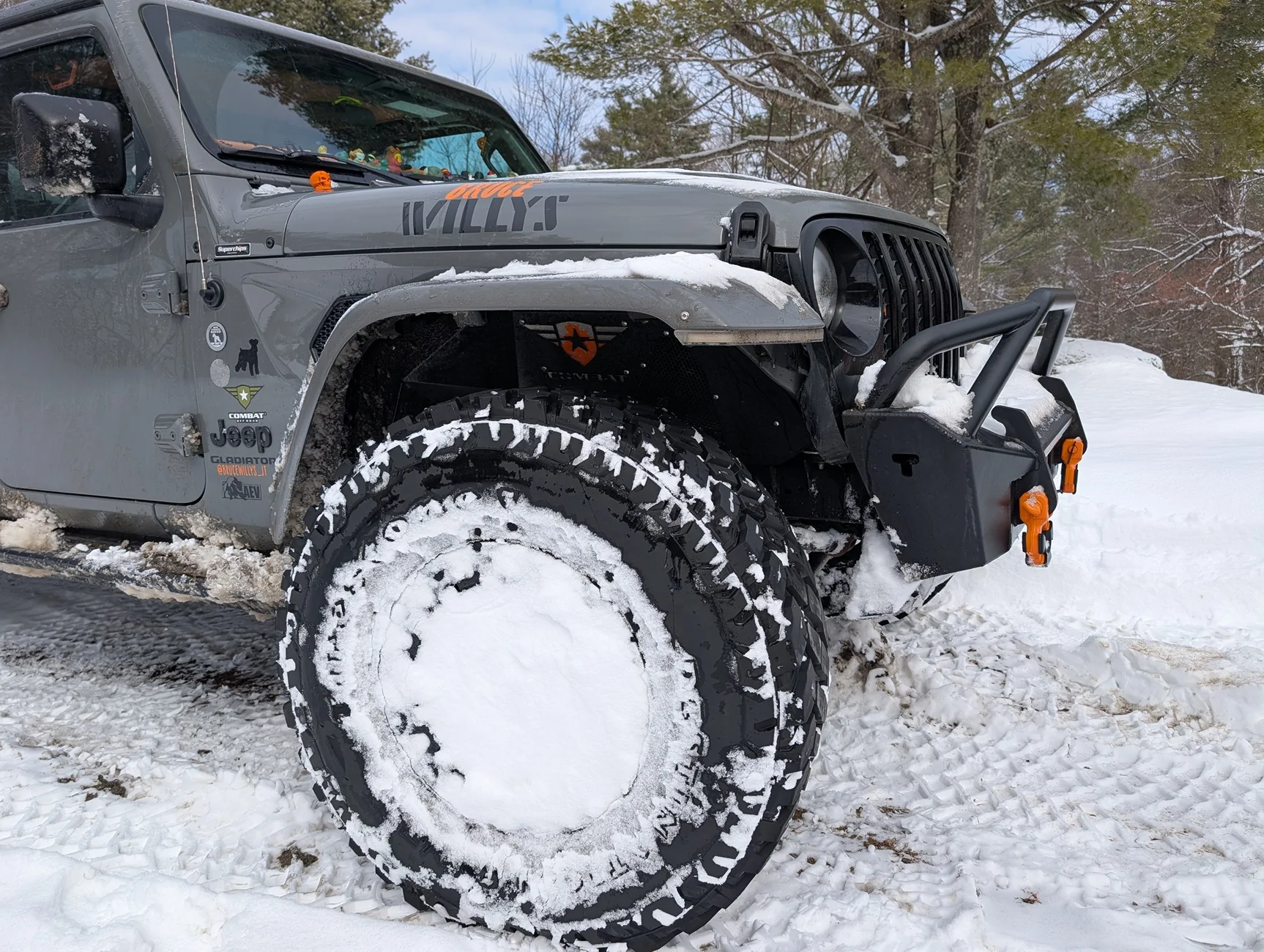

Hello all, I’m thinking of purchasing 2.5” Clayton lift for my 2020 sport S off of mkt place. I have about 120,000 miles and was planning on replacing shocks n springs anyway and leveling. The Kit has about 2k miles. Guy went with taller lift. kit comes with springs, billstein 5100 shocks, and lower control arms. I have max tow and Dana 44 pkg. what else would I need to install this kit. Prob going with 35 or 37” tires. Do I need to regear? It’s my daily driver and I travel about 200 miles upstate about once a month or so. I’d like to keep ride quality close or the same. Thanks for any input
I'm running a AEV 2" spacer lift with those billsteins on 37"x12.5 r17. I'd say try it then go regear if you miss the acceleration. I definitely needed my superchips flashcal+ to recalibrate the speedo because the shift points were trash with the 37's. I will say the billsteins were quite an improvement over my stock shocks. Much more planted and less like a yacht.
Pics because why not
