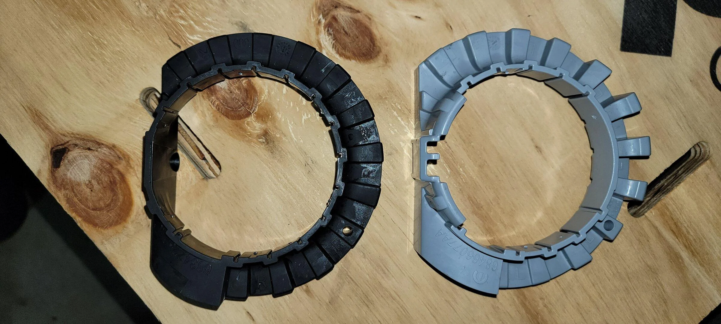

I am crazy so i have pictures of the lift and stock suspension on my phone lol. See attached, all the isolators were black that i had.

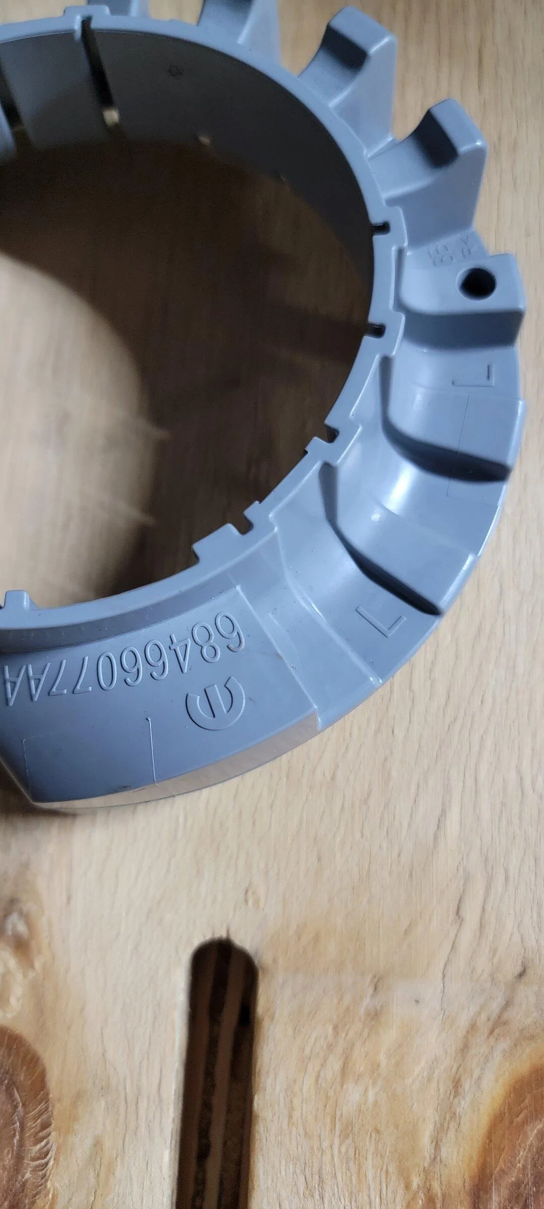

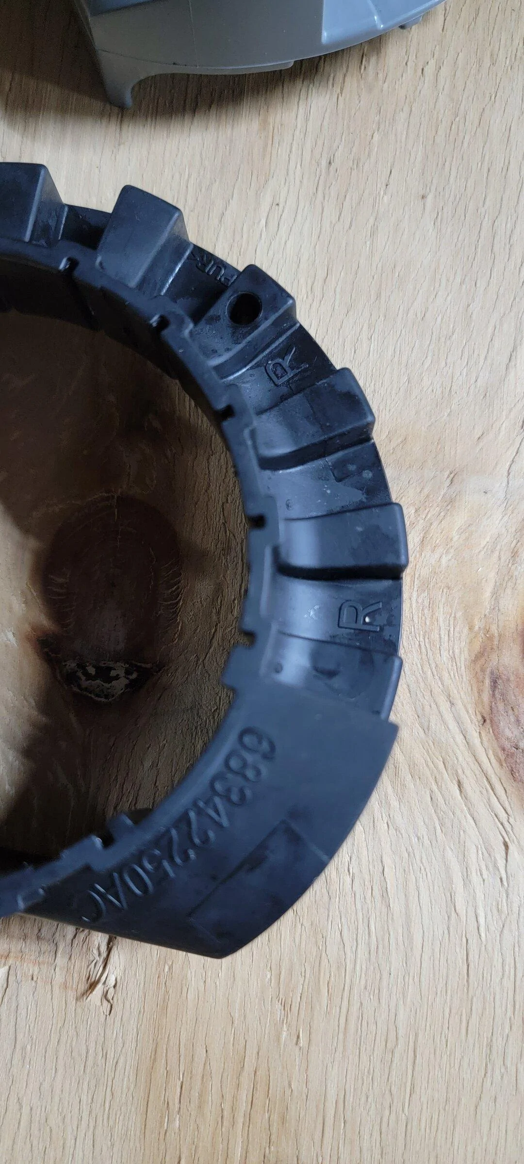

here are the pics.... looking at the part#s the gray one appears to oem to the vehicle and the black one is from the kit.. I need to see if I can check the part numbers on the ones installed. I'm still curious why they are designed different, You can see a difference near the face to the left of the part# and also, the gray one has "lips" or "upward edges" where the spring seats and the black one does not.

I do not have a diesel, but I just did the MOPAR lift and my take-offs were gray/black just like yours. The ones in the kit were both black and look pretty much the same side by side
Also, the drivers side pic of the spring isolator orientation in the instructions (#23 and #24) does NOT match the orientation actually installed. The instructions make it look like they are mirror images of each others, when in fact (like yours) they appear to be identical. It makes it looks like one spring is CW and the other is CCW, but both the isolators and the springs are wound the same direction.
Are yours the same?

Yeah i would call and confirm. I dont think a gray and black isolator makes sense.. if they arent sure, they should purchase 2 new ones and install those for you to be sure. Also, every single kit comes with that badge so they owe you that as well!
After looking and checking the part#... the gray one is an OEM takeoff and the black matched up with the lift kit #s.... still confused how I ended up with two different color left overs..... Someone mentioned the 2022 comes with Gray isolators so I'm wondering if one of my isolators ended up missing and they just threw another 1 in the Box ? who knows, seems to be riding correctly no serious Bowing or any issues at this point so maybe it's just a no worry deal

(If directed to me‽)... If I understand correctly.... yes the same
