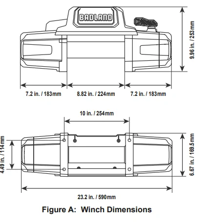

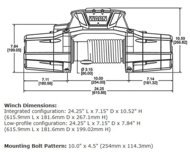

I have the APEX... its a huge honker of a winch.... thats why Ive been trying to find a plate compatible with both the Apex and steel bumper.... I thought I read somewhere the the Warn plate is compatible, but can't find it now.

I think you'll be ok. I know that the WARN 12s platinum works in this mount (which is what APEX uses as their comparison) on the JT and here are the dimensions:
Jeep Gladiator 2" Mopar EcoDiesel Lift Kit Instructions ERROR??? 1641504363632
Here are the APEX dimensions:
Jeep Gladiator 2" Mopar EcoDiesel Lift Kit Instructions ERROR??? 1641504515988
Roughly an inch smaller in every dimension, so I think you are good to go!

Thanks bud !..
