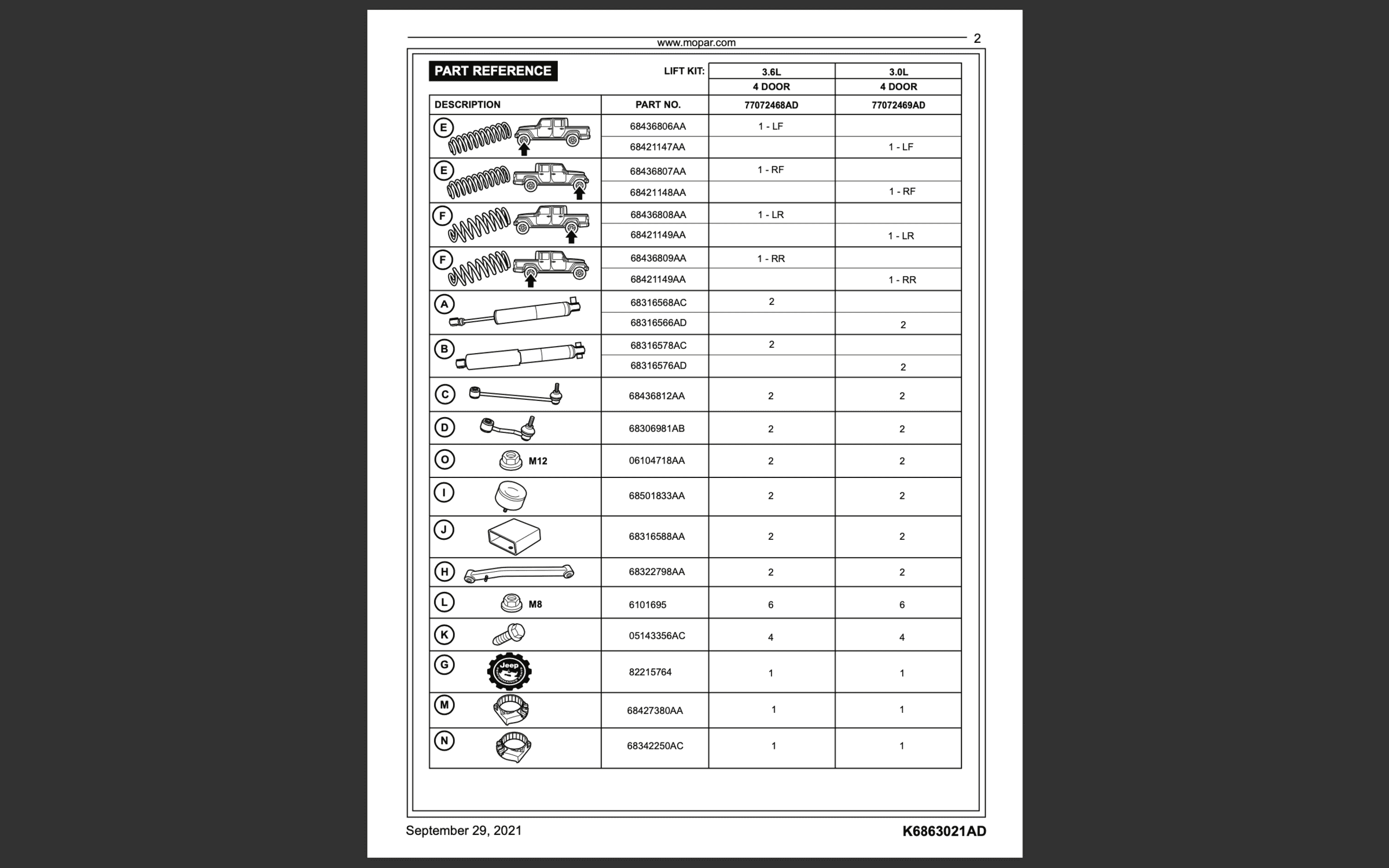

I was installing my Mopar lift specific to the eco diesel and noticed that the instructions for the springs are not clear. In the attached image below you can see each spring has a part number that is associated with a RF, LF, RR or LR indicating the orientation in which to be installed on the jeep. (left front, right rear, etc) The image on the very far left does not match the RF, LF, RR, or LR in the 3.0 column for the diesel lift. They are swapped, which is confusing. If you look in the 3.6L column on the chart the image matches. AND if you look up the JL instructions, the image matches for all 3 engines which all have different spring part numbers. What do you all think? Is this a print error on Mopar's end? For anyone with a Diesel Mopar lift installed, I would double check the tags on the springs and match the part numbers and see how your dealer or you installed them, they might be on the wrong side depending on how the instructions are interpreted.
Ok... I finally got my hands on what will clear everything up.... had to pull some teeth and owe a few favors, but well worth it. If anyone would like a copy, PM me with your email and I will send you one. This is the corrected, most up to date installation instructions for the Mopar Lift..dated 09/29/2021 .. seems it has gone through several revisions... Hope this helps !
It's still not correct. RR should ends with 50AA. It took them nearly a year to update and still screwed up ?. Could it be that the only difference between AC & AD p/n is the installation instructions?
We need a post named "Mopar Errors"
Good catch... but still clearded things up , atleast for me.... I am now reasured mine was installed correctly, instead of guessing.... still another typo after all this time.... go figure
Yes, at least the picture matches the indicated orientation of RF, LF, etc now... as for the part numbers who know hahaha
Part numbers are correct except for the one flippo on the rear right(but we know what its supposed to be.... the oriantations are too.... I confirmed it with 2 other sources with Mopar Tech through their Dealer Service Line... But he was not able to share the other pages with me and was only able to provide this guide ..... sets my mind at ease, I guess individually, take it for what its worth.....
Problem solved!

Problem solved!
For verification, we are supposed to be installing the following springs correlated to the R and L sides, right?
LF: 147
RF: 148
LR: 149
RR: 150
LF: 147
RF: 148
LR: 149
RR: 150
Yes
