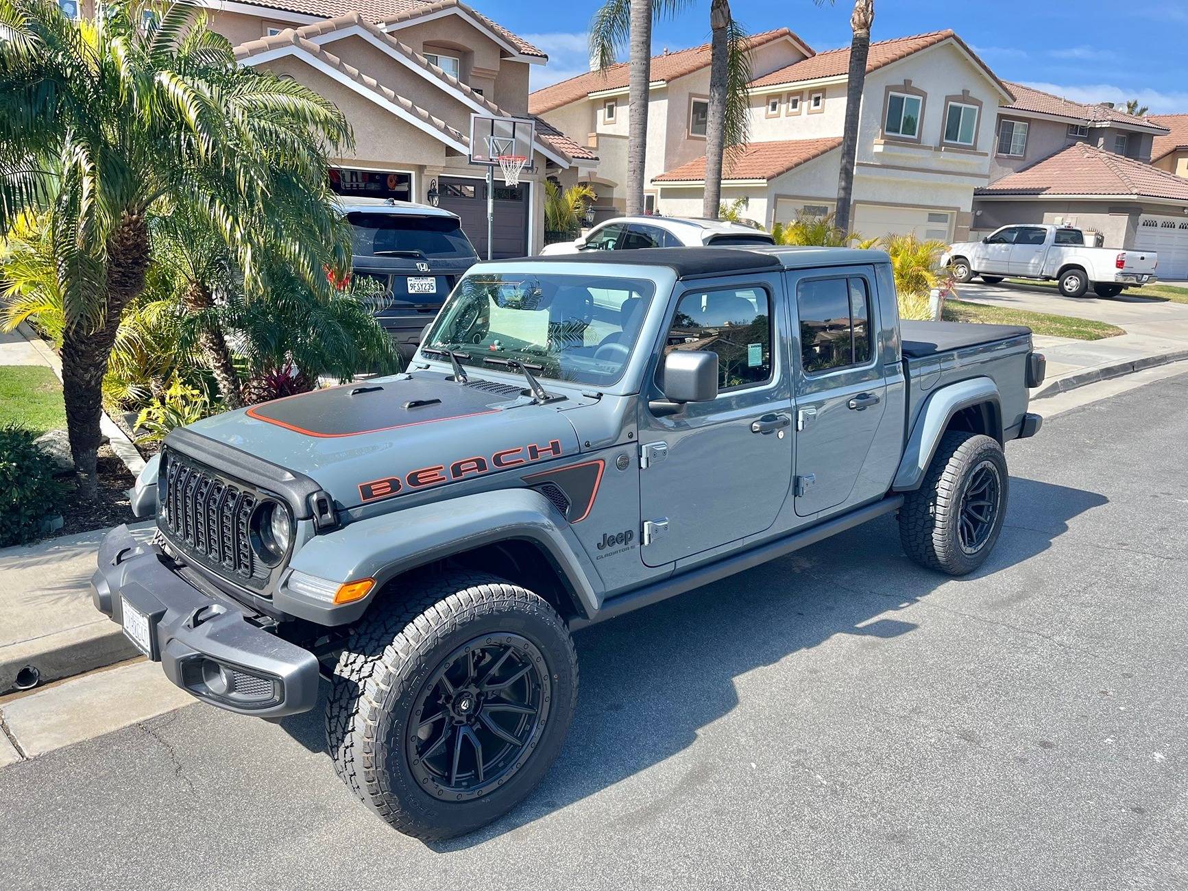

If you're like me and use your JT more like a truck in that you haul people and sh*t, then 20's will be fine. I have 20's with somewhat beefy 33's and they work great.
Jeep Gladiator 20” Wheels - mistake? Stitch9
That being said, if you're running 37" tires, I'm going to assume you'll be wheeling more than I do. If I were running with 37's, I'd probably go 17" wheels. Off road you're going to want to air down and I would definitely go the 17" wheel route in that scenario.
